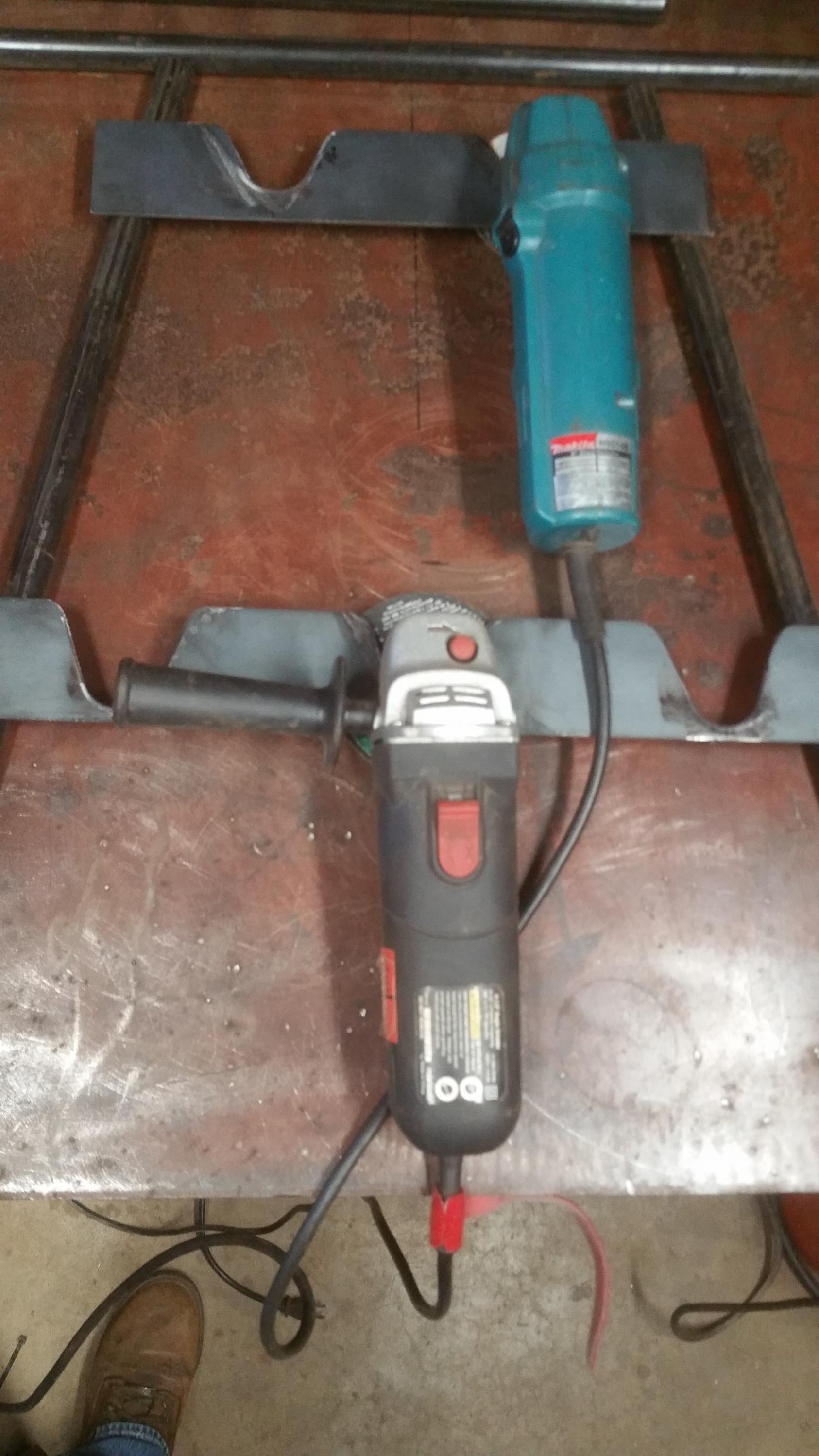

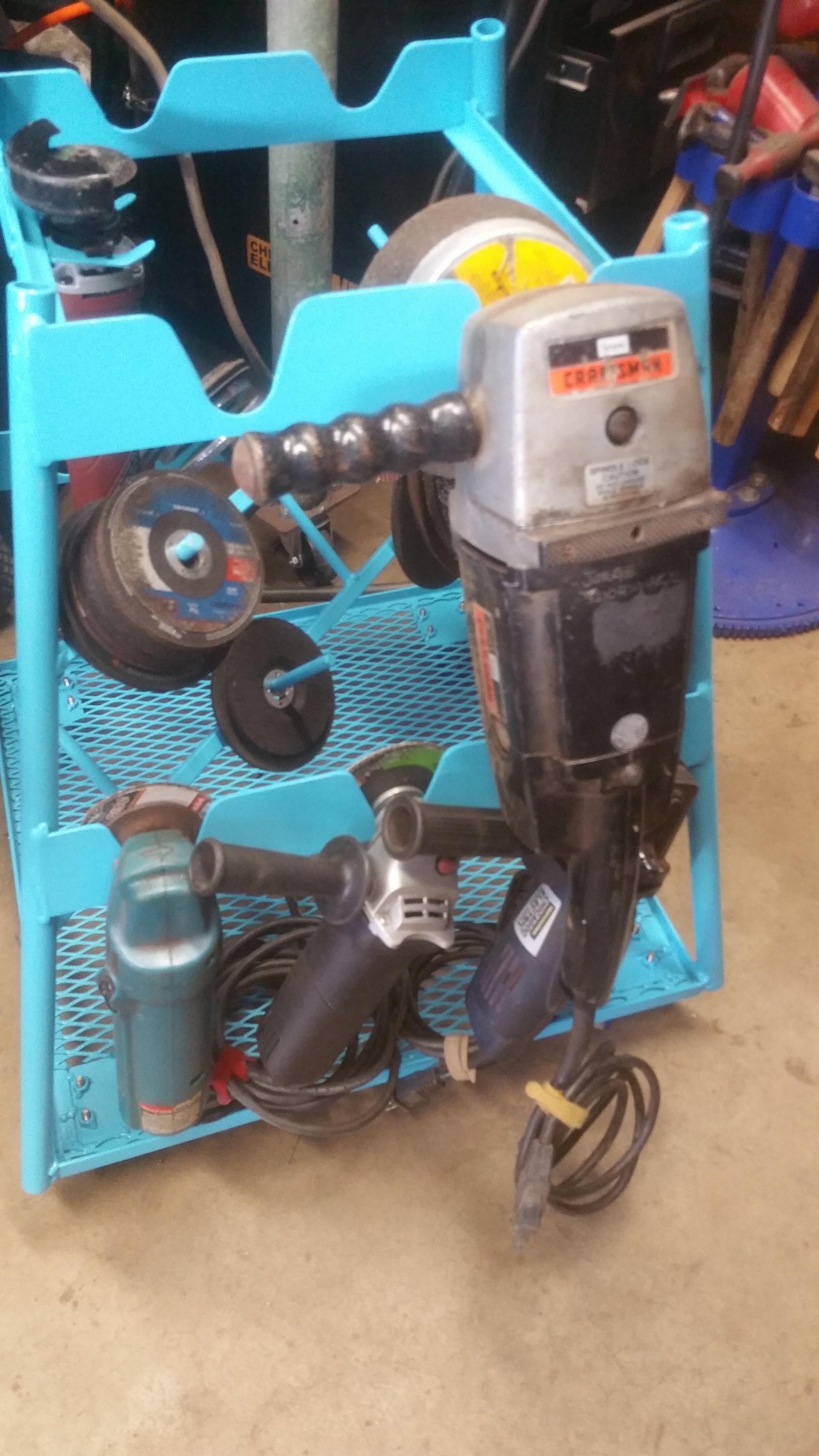

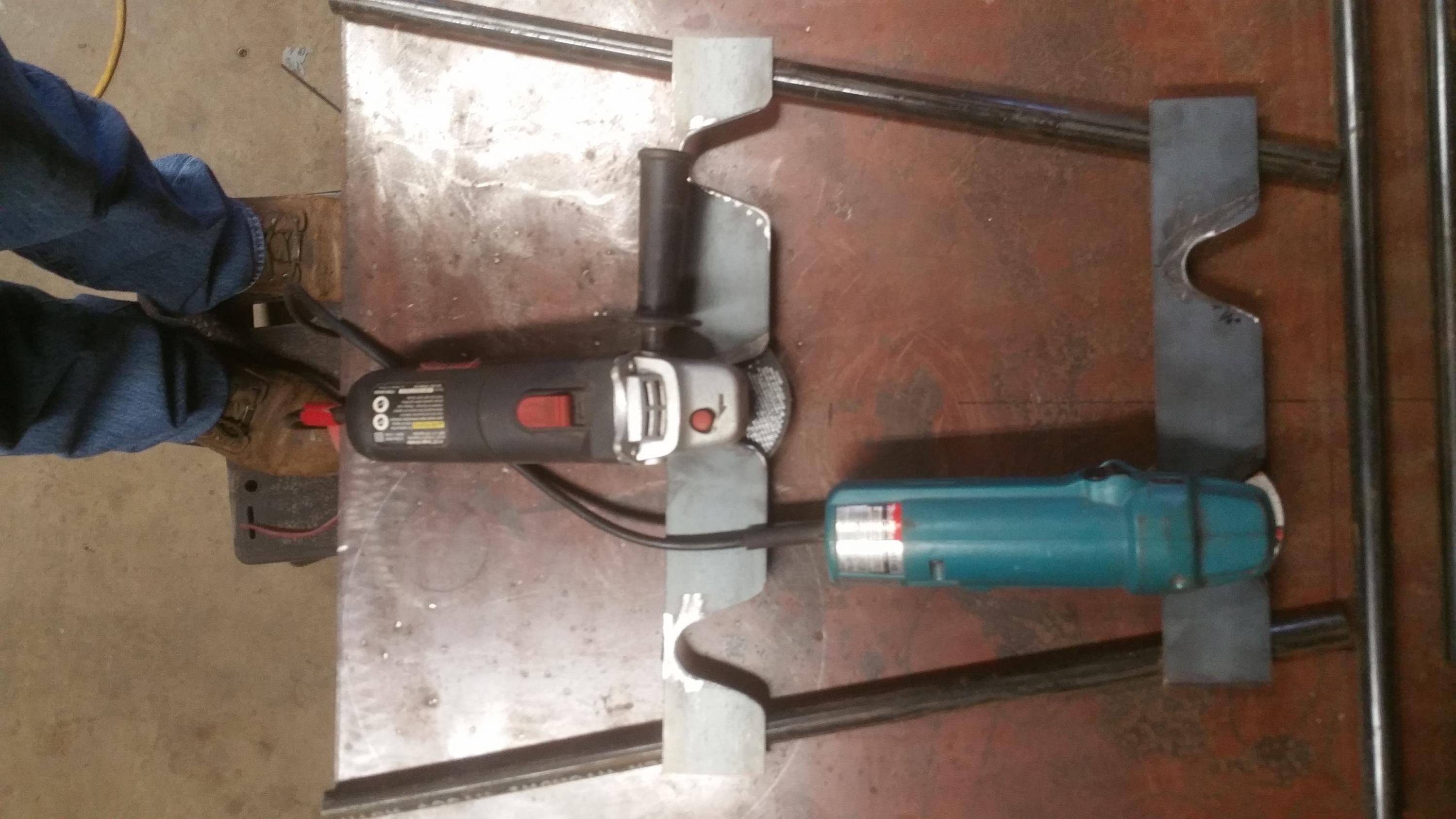

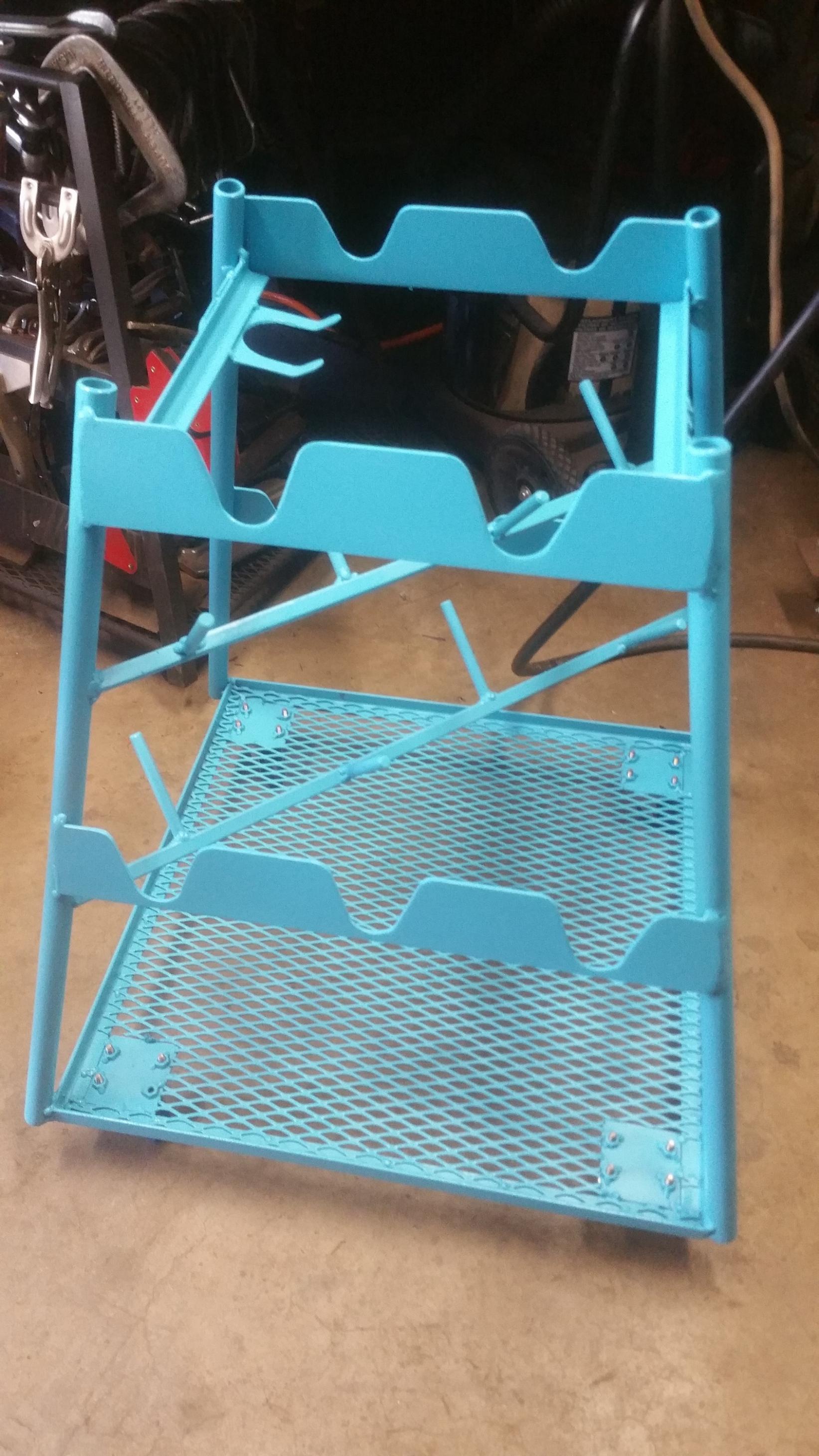

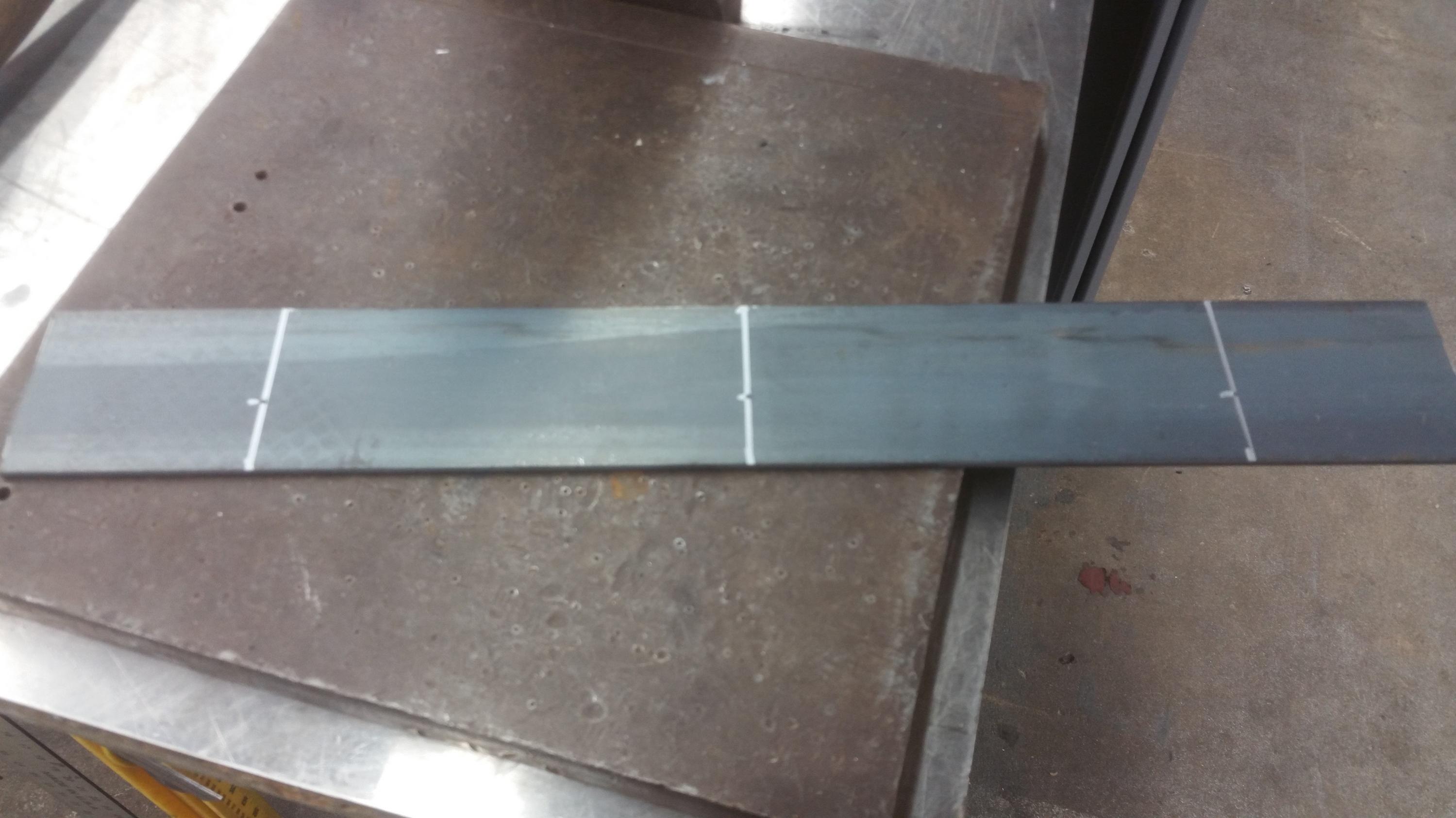

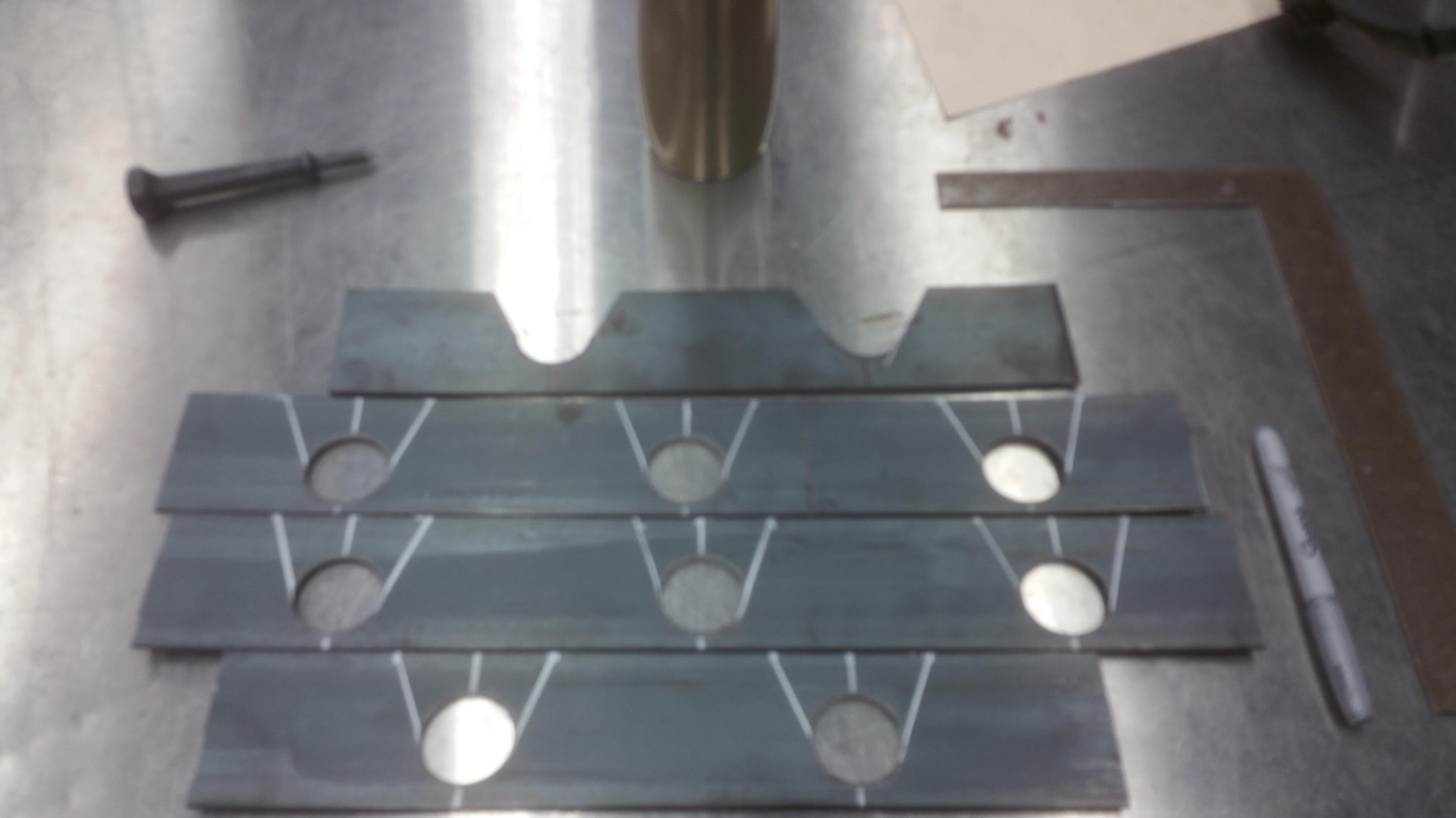

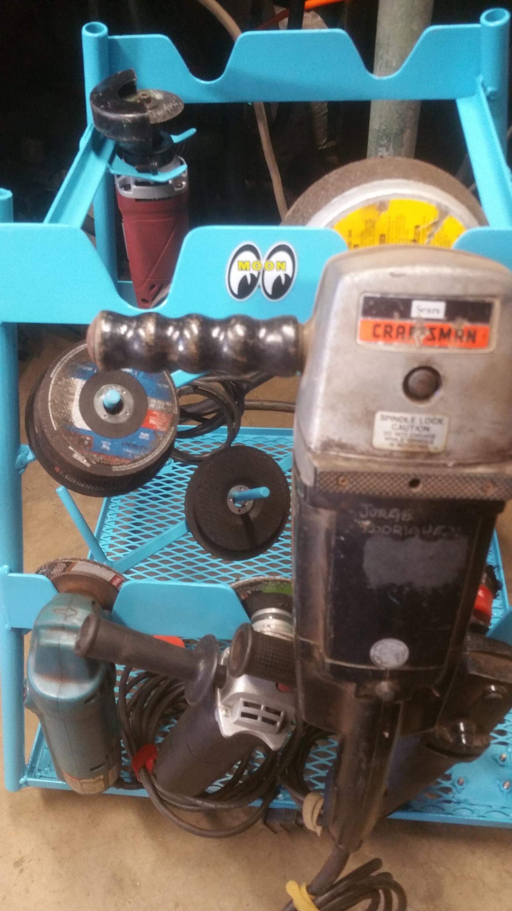

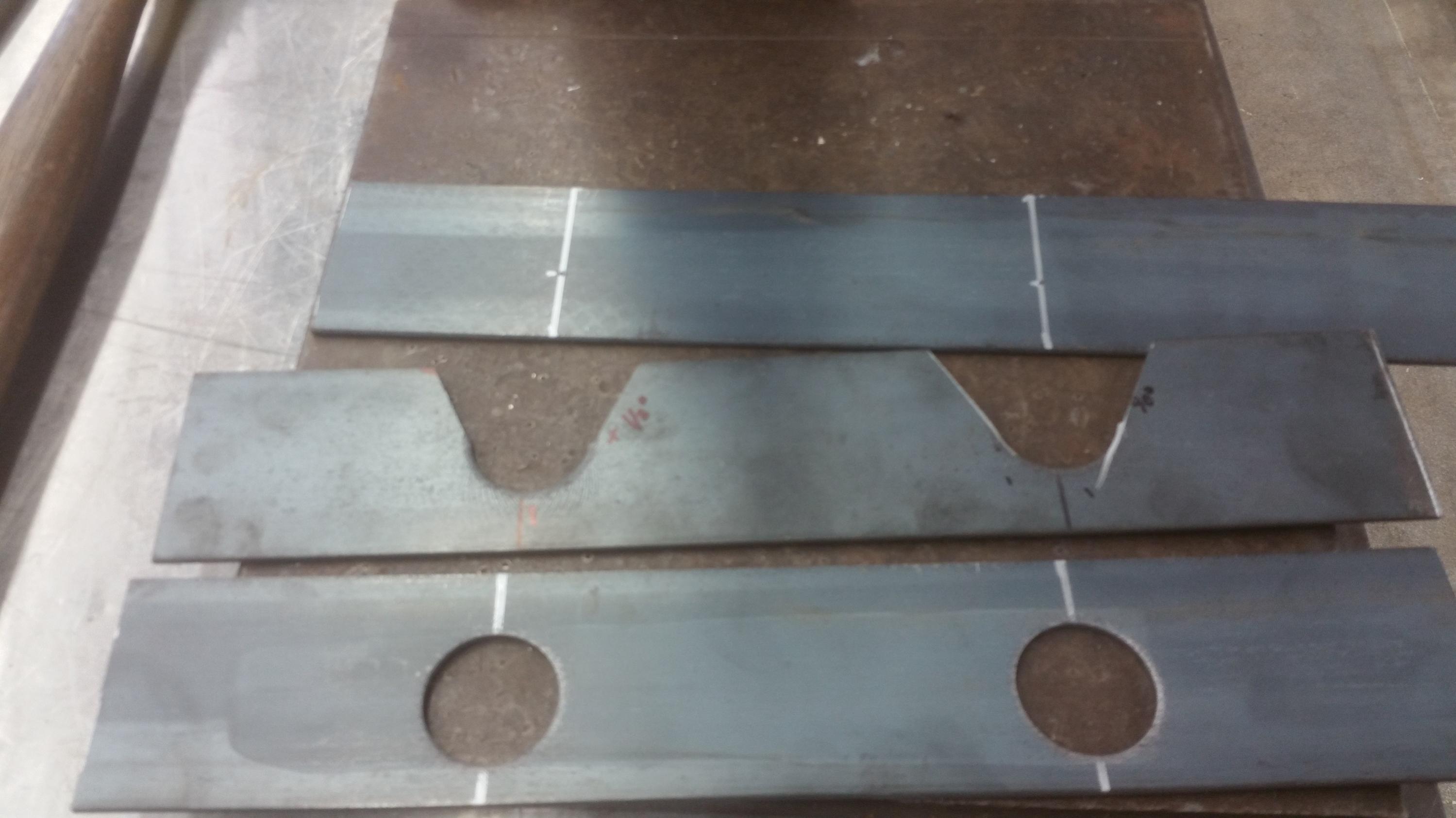

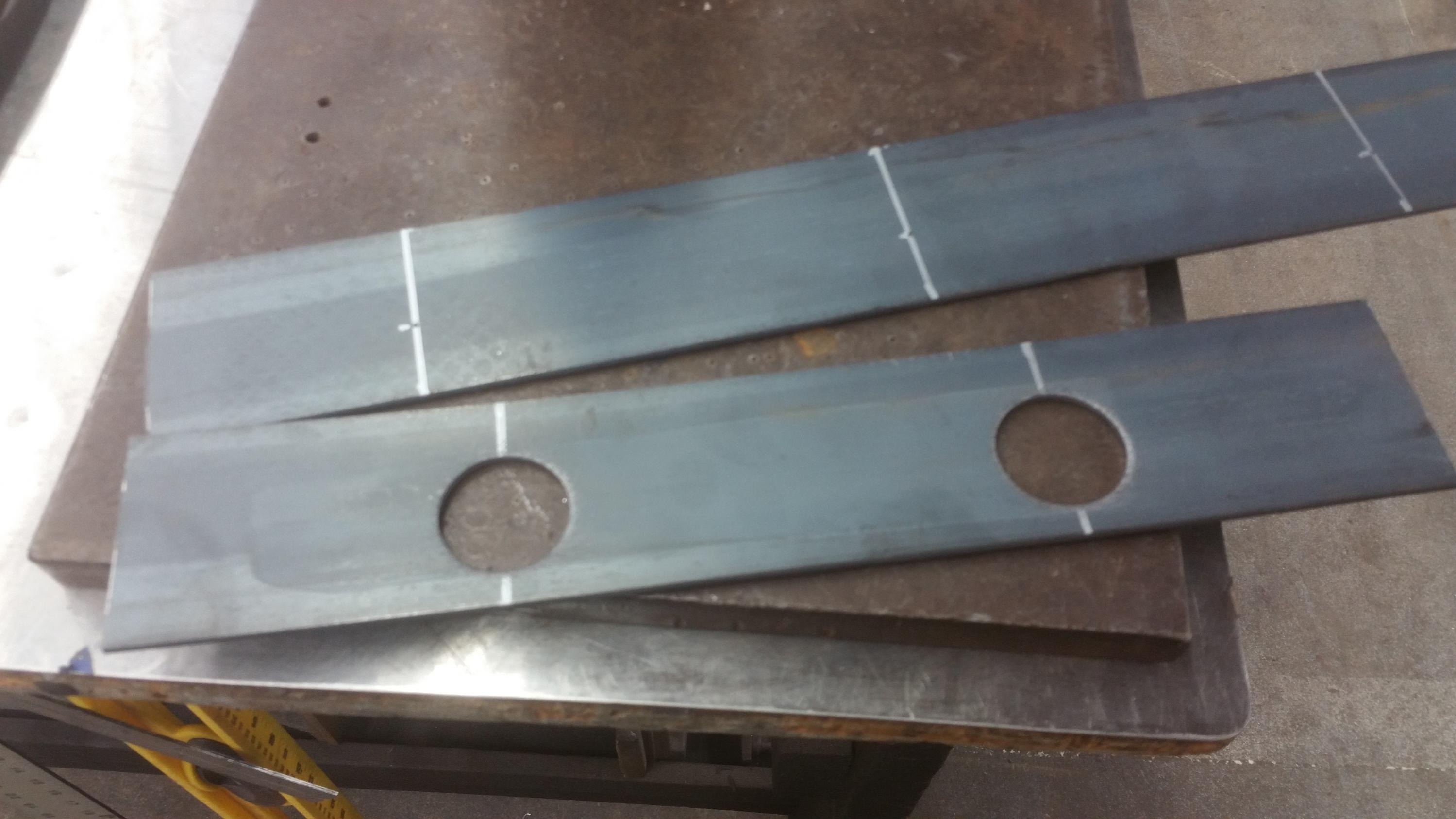

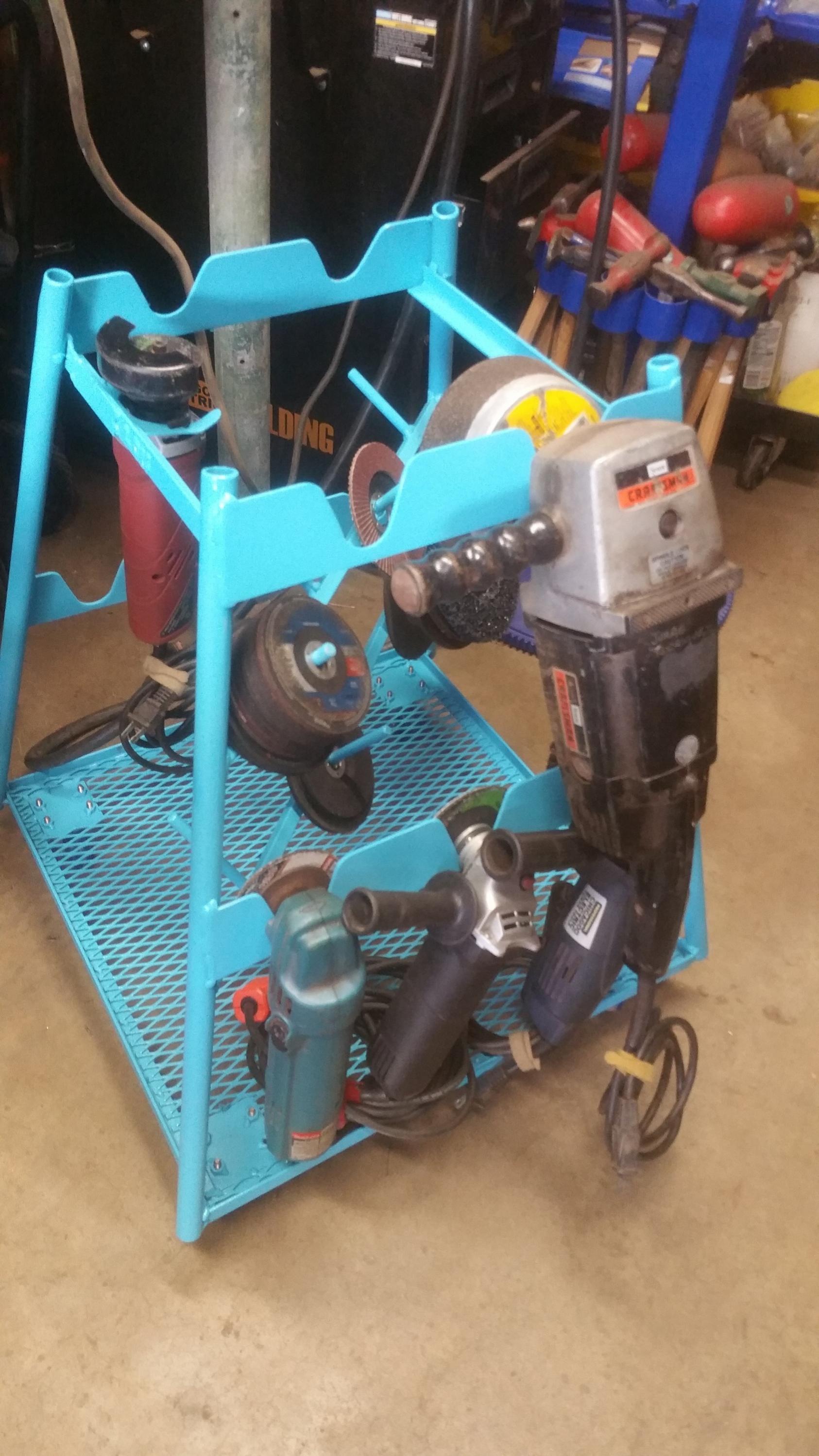

    Was running out of space in my tool chest to store my grinders....and would be going back and forth to get them, this solves both issues. Storage for grinders their disks, wrenches and anything else to do with grinders...and I can have them where I'm working.
