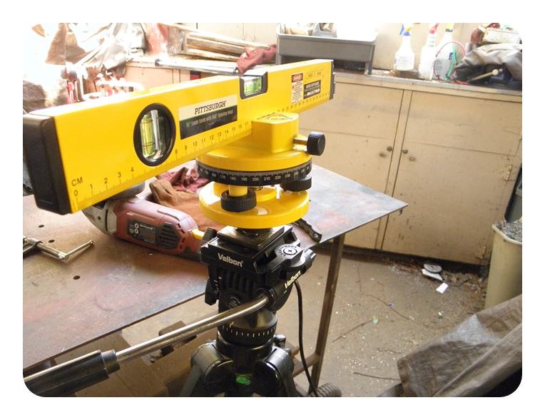

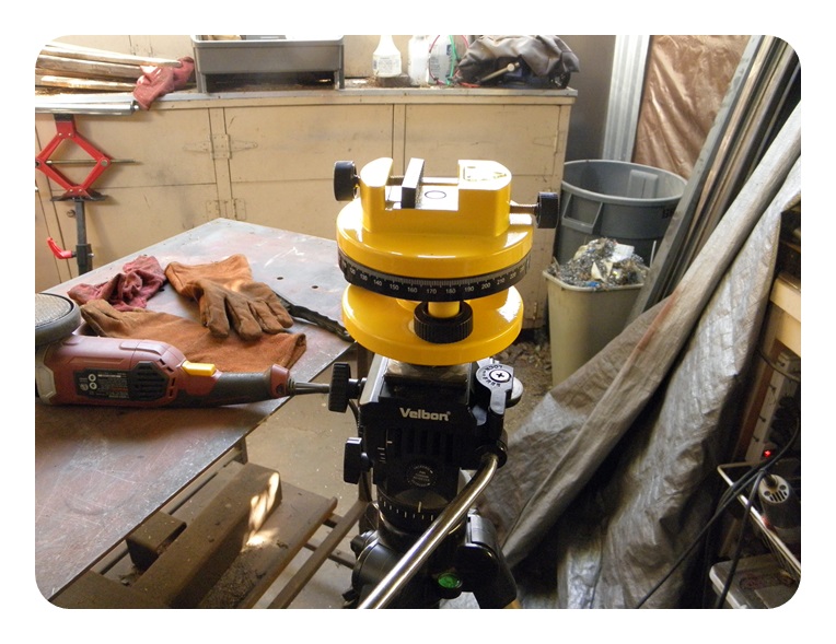

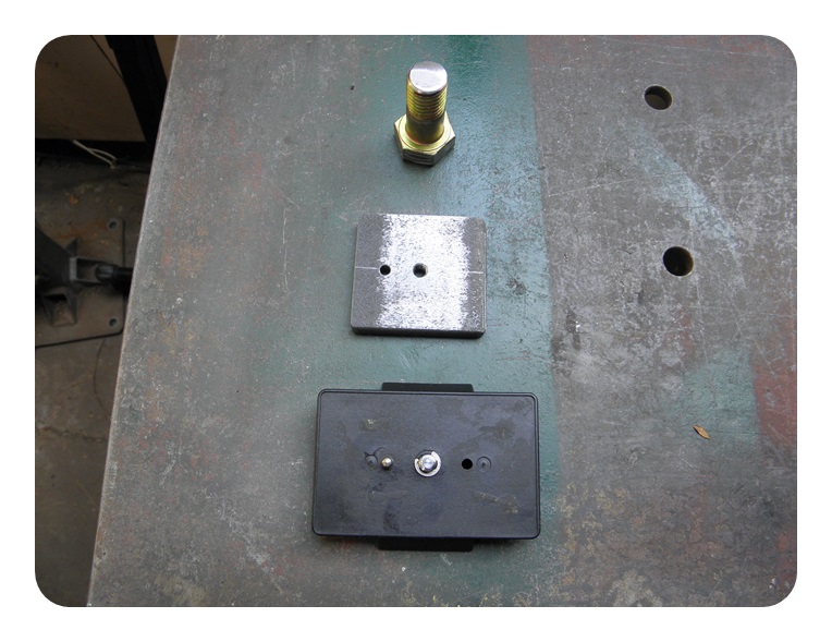

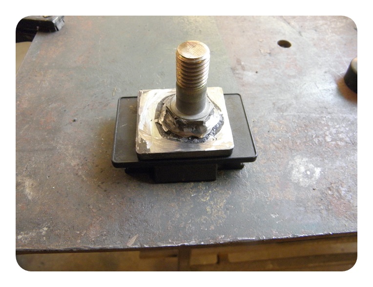

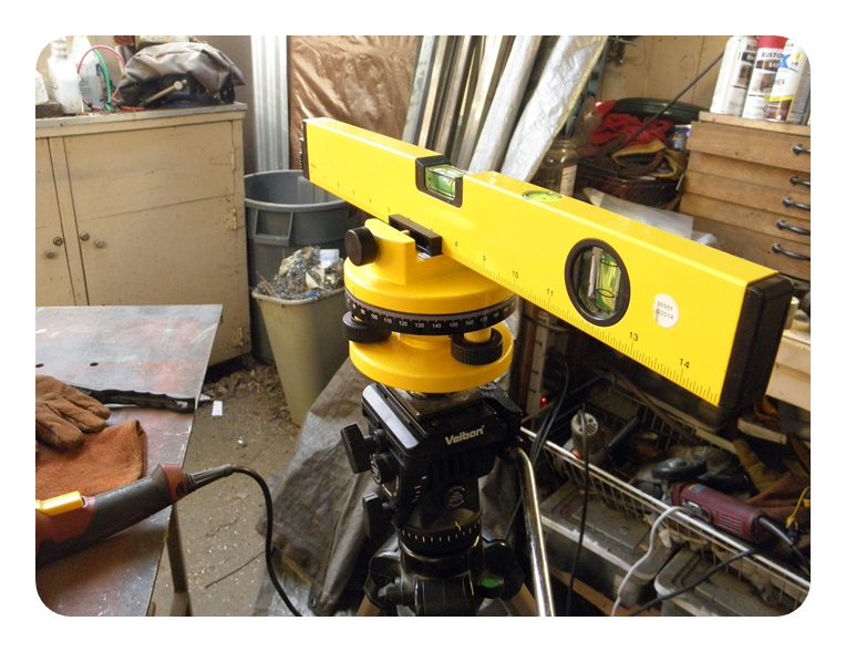

H.F.- Laser Level Mod Adapter Plate. Made from 1/4 '' CRS plate/5/8" Bolt
This mod allows me to use a much better tri-pod to hold the line level.
