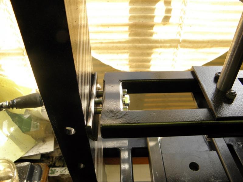

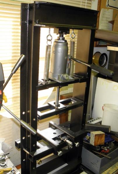

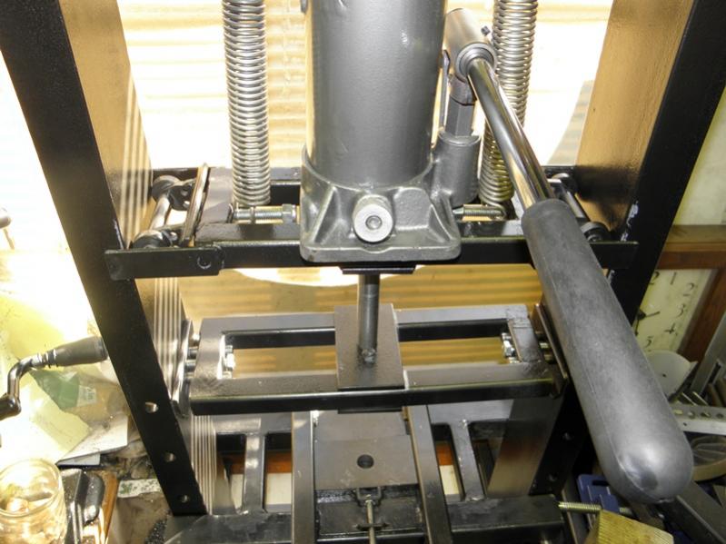

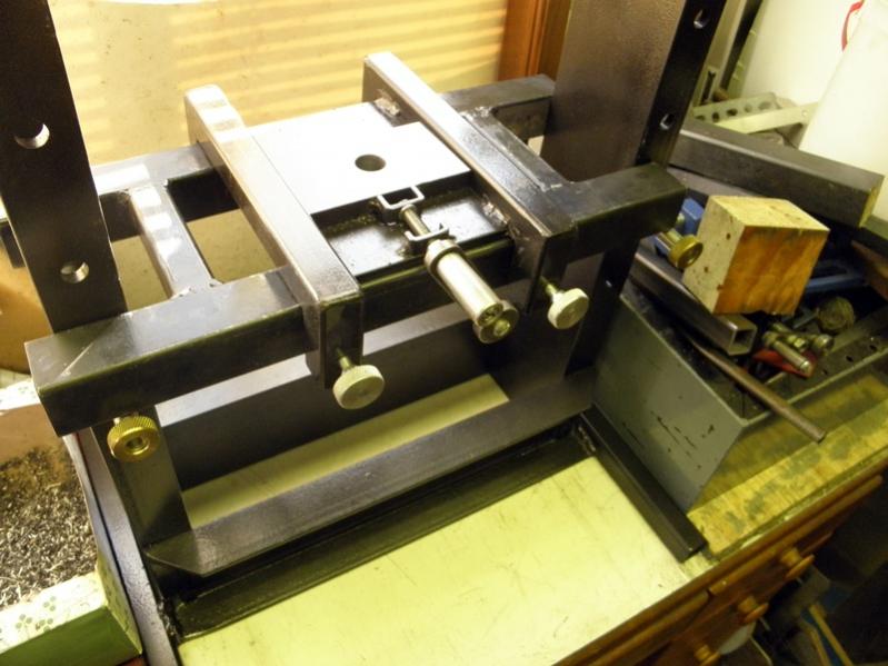

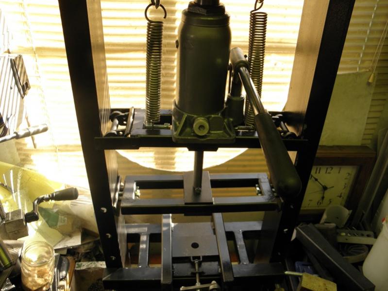

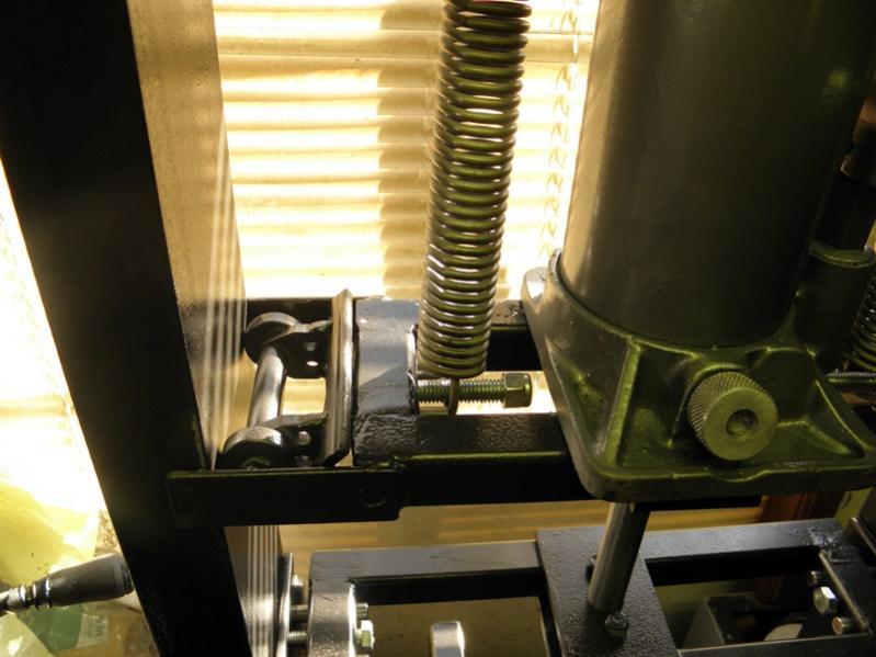

"H" Style Home Made Shop Press. This shop press is made from steel,brass. The movable trolly has steel wheels that glide up and down the up rights and creates less movement of the carriage and the ram rod thereby keeping the alignment of the upper and lower dies consistent.
