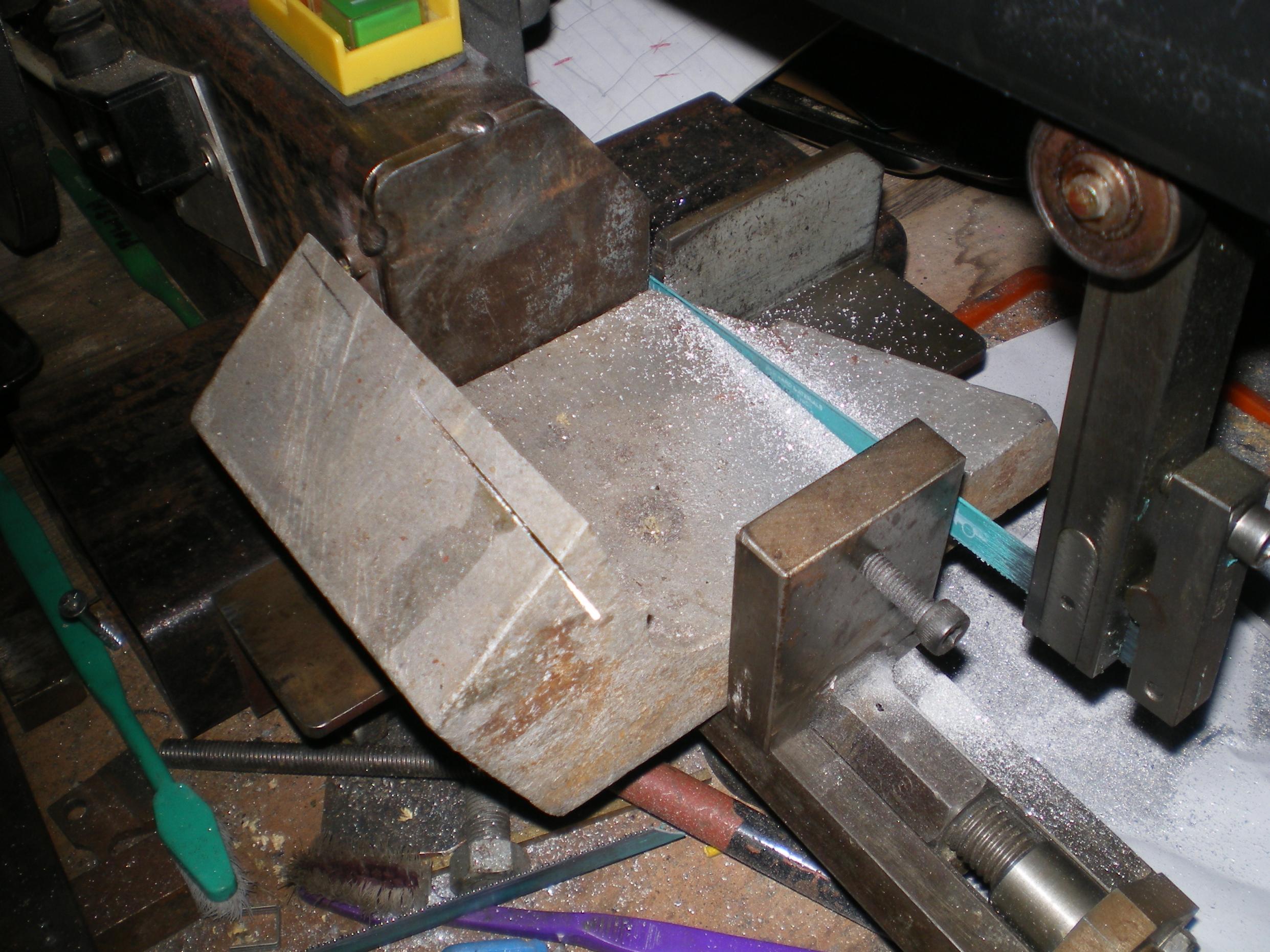

Hi Pete
I was talking about solid material and the blade seems to clear the chips without clogging.

Hi Pete, glad the video helped.
Regarding blade tension I just tighten the blade adjustment until it seems to not want go any further and the blade is resistant to twisting, tried the all hard blades but they break too easily so bi-metal is the way to go.
