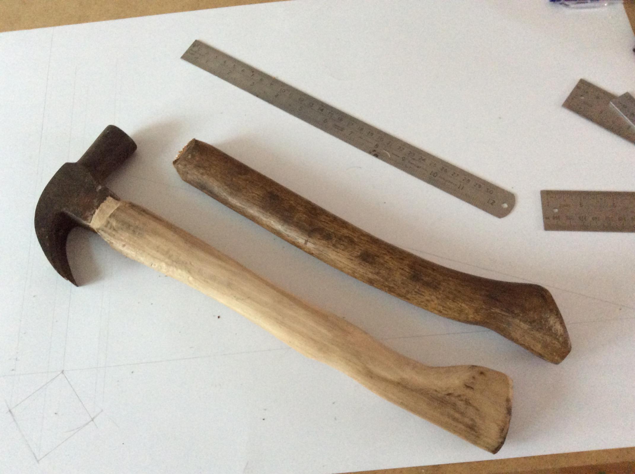

Hammer handle replaced
Attachment 39118
Silly of me to break it, pulling an annular nail, I do know better, but admittedly, give way to impulses. Fortunately had a spare hickory hatchet handle, very little work needed. 4 short cuts on bandsaw, some shaving, rasping and sanding. Used the old wedges and find it slightly better than the old. I shall keep that for another hammer! I prefer a deers foot handle, because I can grip it lightly.
'scuse ignorance, but why is pulling nails with annular rings an issue? (they're called ring shanks around here)... yes they grip well, but I thought clam hammers were made to take that. what should be used if not a claw hammer?
Des

Think he means the iron did ok; not wood handle. Ring shanks are a bear in decent wood.

I knew, before I broke it, that the nail would resist and that the handle would be strained, but stupidly went ahead anyway! The old handle is ash, which I don’t think is as strong as hickory. Generally, as good practice, one should assess the limitations of one’s tools (it’s a perpetual source of frustration to find one’s own limitations!) so I know it should be used only for light or short wire nails. I had a pry bar only 3 yards behind me. Still, I didn’t knock out my teeth.
One thing is sure; hickory outranks ash. While densities of seasoned/ dry wood overlap: these are per cubic foot;
Ash, white 650 - 850
Ash, black 540
Ash, European 710
Hickory 600 - 930
That form of handle encourages a proper grip; not only firm but can loosen on the backswing without flying out of hand. Its irritating to see someone pretend to bash away, their hammer grip choking the head. I ask them 'Why do you think that handle so long?'.
No one recalls ash extolled as a tool handle, best seems to be "flame hardened hickory". Looks rather oak-like, on steroids.
