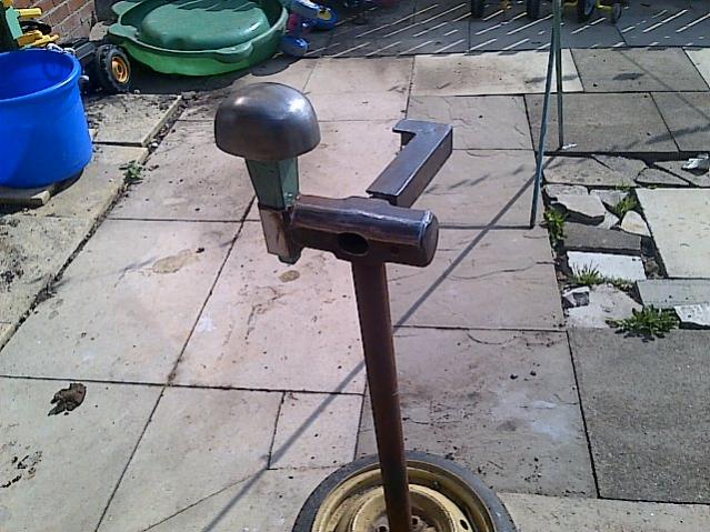

heres an anvil i made using old sledge hammer head that i welded to an offcut of steel tube then welded to old car wheel.
ground radius on side of head for shaping metal on, on one end i welded pce of box sect to hold my domestakes.
on back side i fitted some angle when i was makng up some corner brackets.Attachment 743
