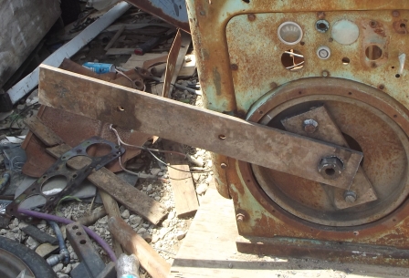

The stuck engine I am working on see http://www.homemadetools.net/forum/h...mpressor-46374
so I cut out this simple tool from the same stock that I made the stuck engine tool out of.
A few whacks with a 12 lb sledge was all it took after the KBS Rust blast had done it's work over night.
Attachment 11524
