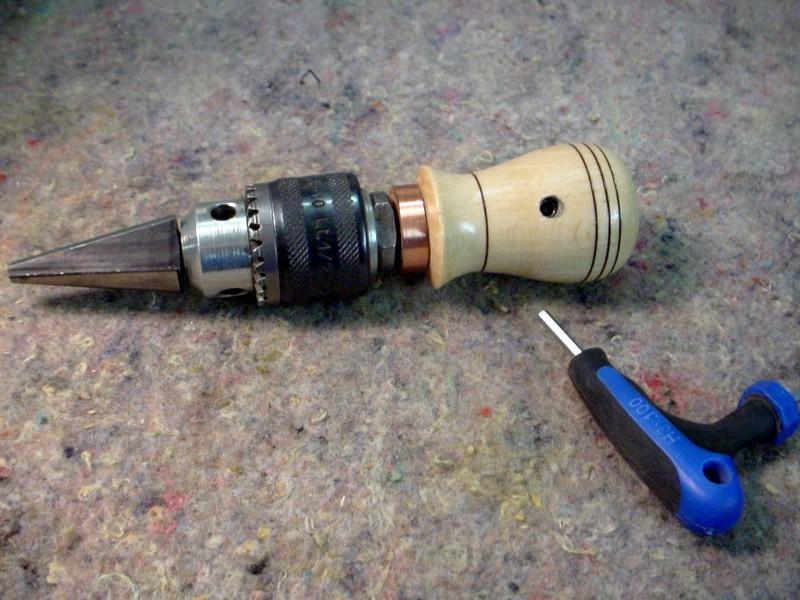

Hello,
This is my hand chuck, very handy for hand drilling, or deburring for instance.
http://www.labellenote.fr/photo/gal_...rin_a_main.jpg
It is a 10mm chuck, with an SDS adaptator shaft.
The handle is woodturned out of beech, and there is a set screw to hold the handle on the shaft.
The screw just goes into one of the flutes of the SDS shaft.
http://www.labellenote.fr/file/homem...ong_Dbit_2.JPG
It can be used to hold whatever you want, it can be a tool like a bit, but also the work piece, for instance when grinding a round piece of HSS ...
