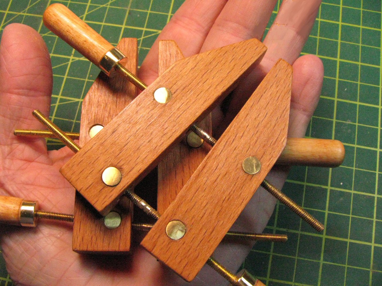

Hand Screw Clamps
I needed some clamps able to clamp irregular shapes so I made these. This type of clamp requires both right and left hand threads. The most difficult part of the project was tapping and dieing (is this a word?) the left hand threads. I have seen other small clamps being made on youtube but they get around using left hand threads by using nuts or copying the machinists clamp.
Cheers, GuyAttachment 19900

They look great! Nice job.
Fantastic! I originally thought that you had full size clamps there but then did a double take and noticed that they are in the palm of your hand. Well done.
Guy
It would be nice to get a little bit more info. What did you do for the tap and dies? Did you buy them, make them or turn the thread on a lathe? It is a very beautiful job you did on them and I can see how handy they might be.
Thank you all for your very kind comments.
In response to ncollar's question, I purchased the right and left hand taps and dies from www.victornet.com/.
Cheers, Guy
