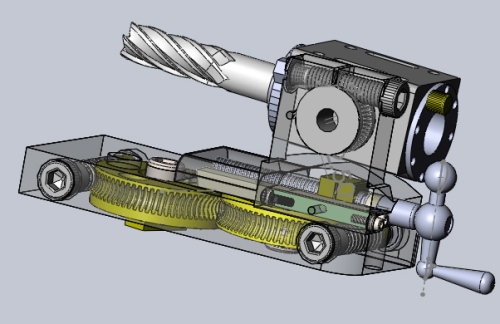

Jamman I don't want to hijack this thread but a .22 rifle has a bore of .22/100 nominal 5/16" is .312" I trust that you are going to sleeve this with a tube that will press fit in the 5/16" bore then ream and hone before attempting to rifle the bore. Do you know what grain bullet you plan to fire through it? because this will also determine the amount of twist you should target for.
the twist in the riflings are all over the board ranging from a 1 in 14 for 48 to 50 grain to 1 in 7 for a 60 or higher with the 1 in 9 or 10 being quite popular in small bores
Spiral end mills the diameter you would need to regrind into a button would need to be at least a 6 fluted mill an odd numbered flute would be better for centering in the bore but I've never seen a 7 fluted end mill that small which would also have a very tight spiral of around 1 in 1.5 to 1 in 2 far too tight to be reground into a button. but if very careful attention was paid to the regrind of a .250" end mill there might be enough material in the cross section of the fluted to yield the features of the button when the grinding was completed.
I suppose you could do this with a 2 fluted mill but it would be very difficult if not nearly impossible to hold it perfectly centered as it finished forming the groves additionally you would still need a fixture such as one I started designing for my Clarkston tool grinder which I no longer have
this 5 axis tooling fixture that I hope to one day build and perfect would probably be what would be needed to make a proper button
Attachment 9872
