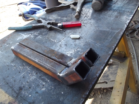

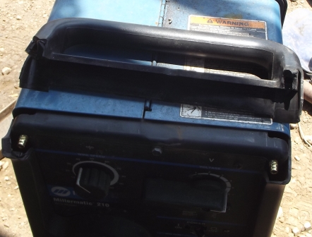

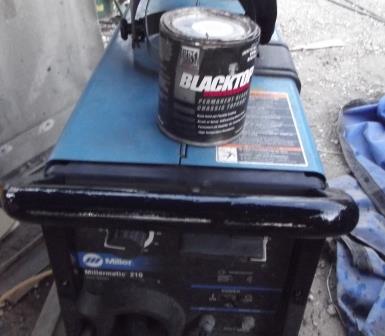

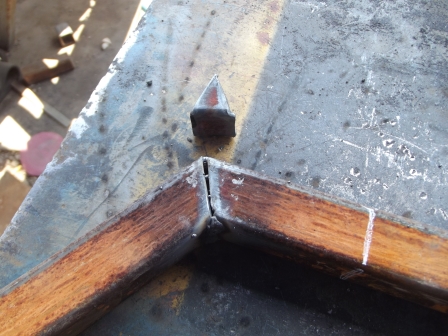

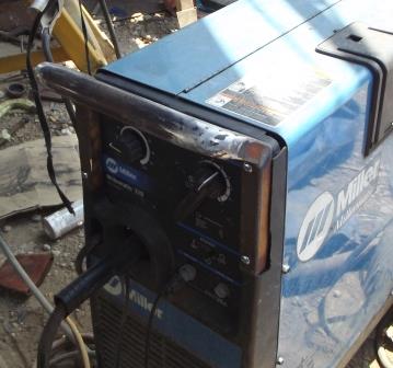

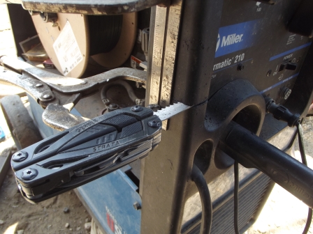

THe plastic pull handle on my Miller 210 mig machine broke, so rather than shell out $130.00 for a new handle bezel combination I opted to make my own
Attachment 9630 Attachment 9631 Attachment 9632 Attachment 9633 Attachment 9634 Attachment 9635 Attachment 9636 Attachment 9637 Attachment 9638
