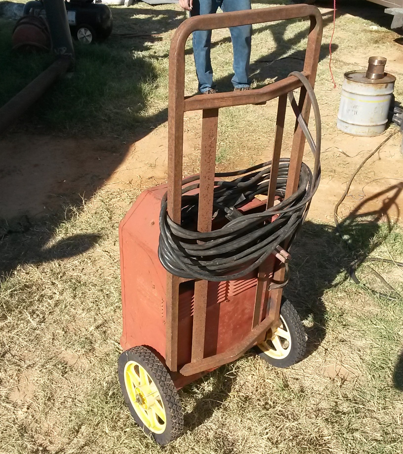

I have an old Lincoln 225 cracker box that is sometimes handy to have around but has always been a pain to move around it used to have tiny little 4" wheels that were impossible to roll on anything other than a concrete floor and it stands less than 2 ft high so again hard to bend over and use the built in handle to move it. I finally got tired of this the other day and installed a pair of 10" x2" lawnmower wheels and welded a handle on it that I had left over from the days that I used to make 2 wheeled hand trucks now it is easy to move around and I have a place to coil the leads
Attachment 31733
When I get the time I will treat it and paint it but for now it is what it is
