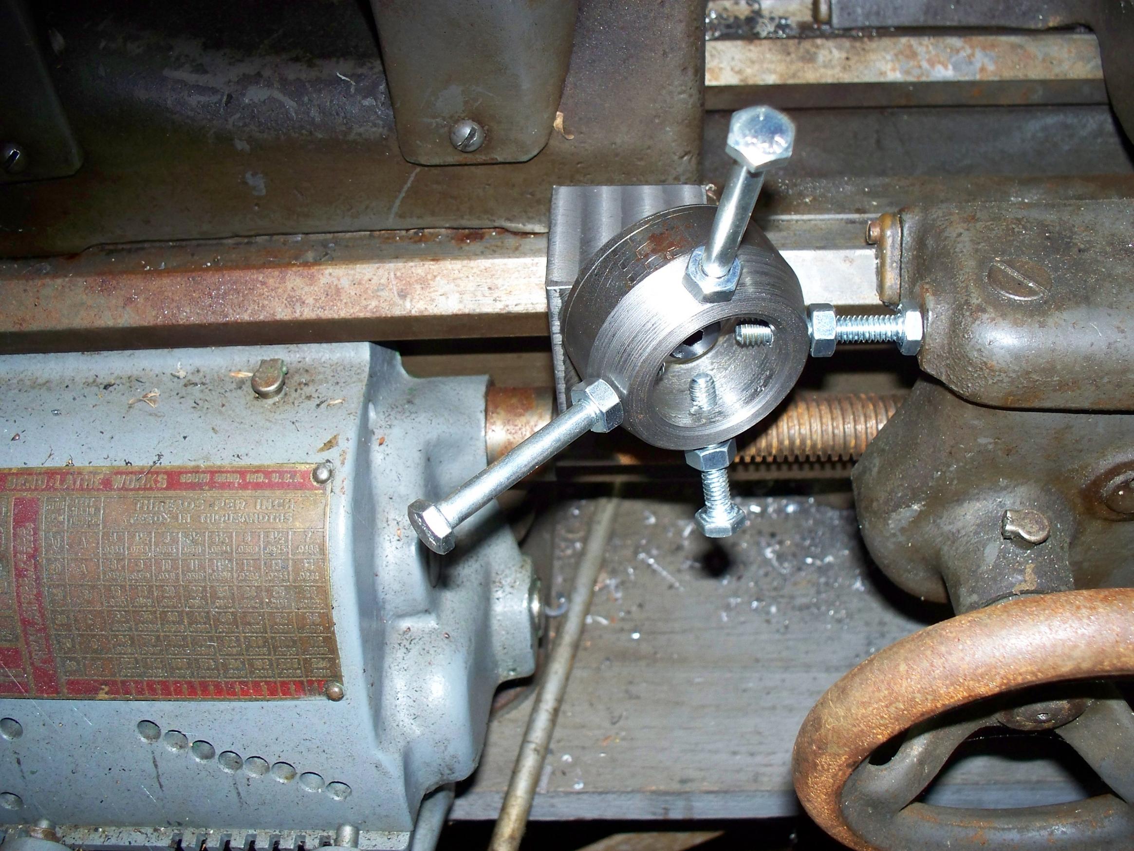

I use this handy four position carriage stop when working close to the collet. The stop pins rotate at a 45 degree angle using hex bolts for stops. Each position has a ball and spring index. Works great.Attachment 7851:thumbsup:
Very handy, I need to make something like this for my lathe!
