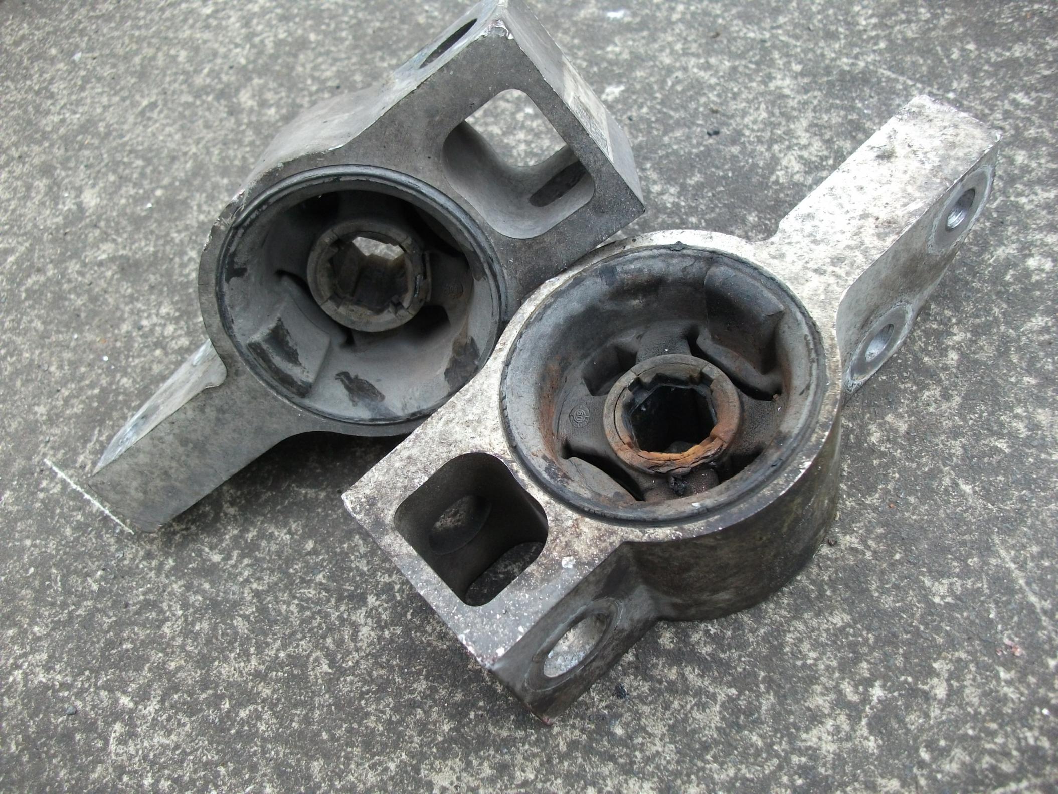

I am lucky enough to get the pick of the scrap from a local auto repairs garage, and a very regular item is the bottom front suspension bush mounting from various VW/Audi models. It is more cost efficient for the garage to replace the entire bush and alloy housing rather than having to extract the rubber bush itself, with the result that I get these complete :-
Attachment 12235

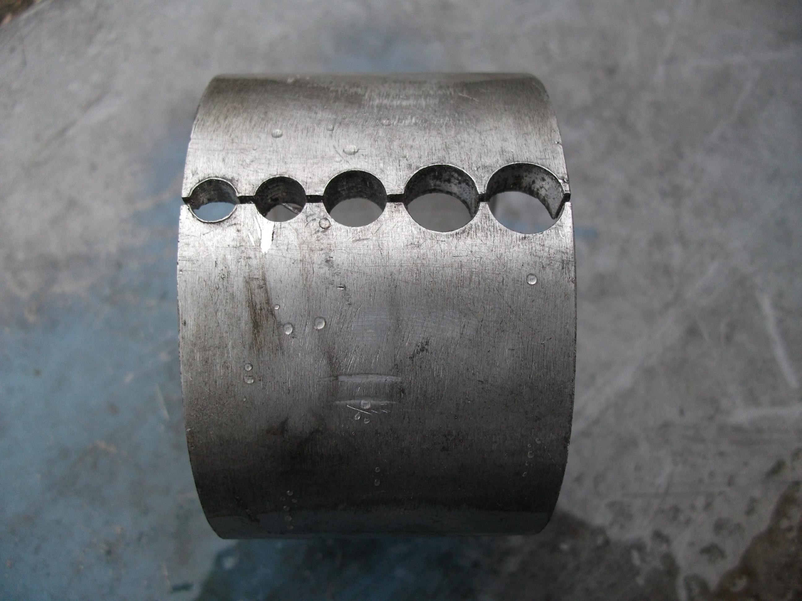

Well, I just HAD to make something useful out of one of these so I came up with a Machine Screw and Bolt Holder for use in the vice, and an indispensible, effective and handy little tool it has proven to be, and VERY simply made to boot ! :-
Attachment 12237
I have posted a very short video of it on my YouTube channel and you can have a look at it 'in action' here:-
https://www.youtube.com/watch?v=ZWmvEUlTZUY
