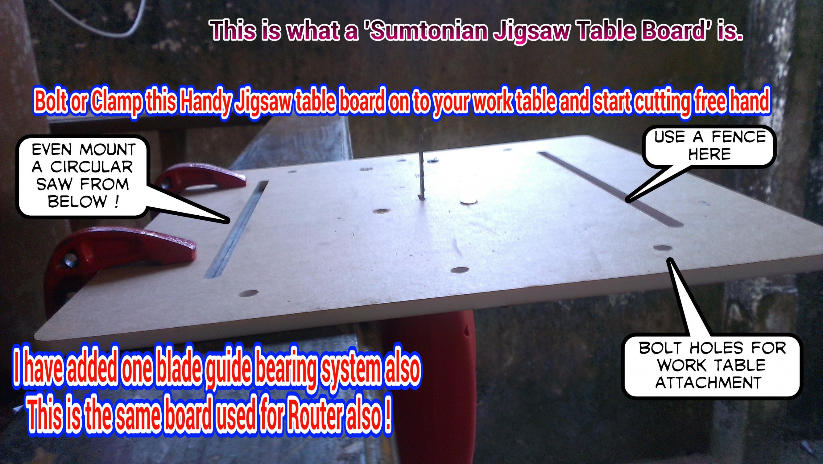

A Handy Jigsaw Table Board
Attachment 9674* * * * * * * * * * * * * * * * * * **

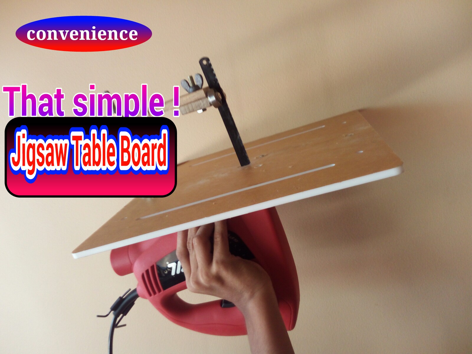

Convert your corded Jig saw into a Scroll saw*
*by this Board.
*Turn Your Corded Dremel rotary tool into a Table mounted machine

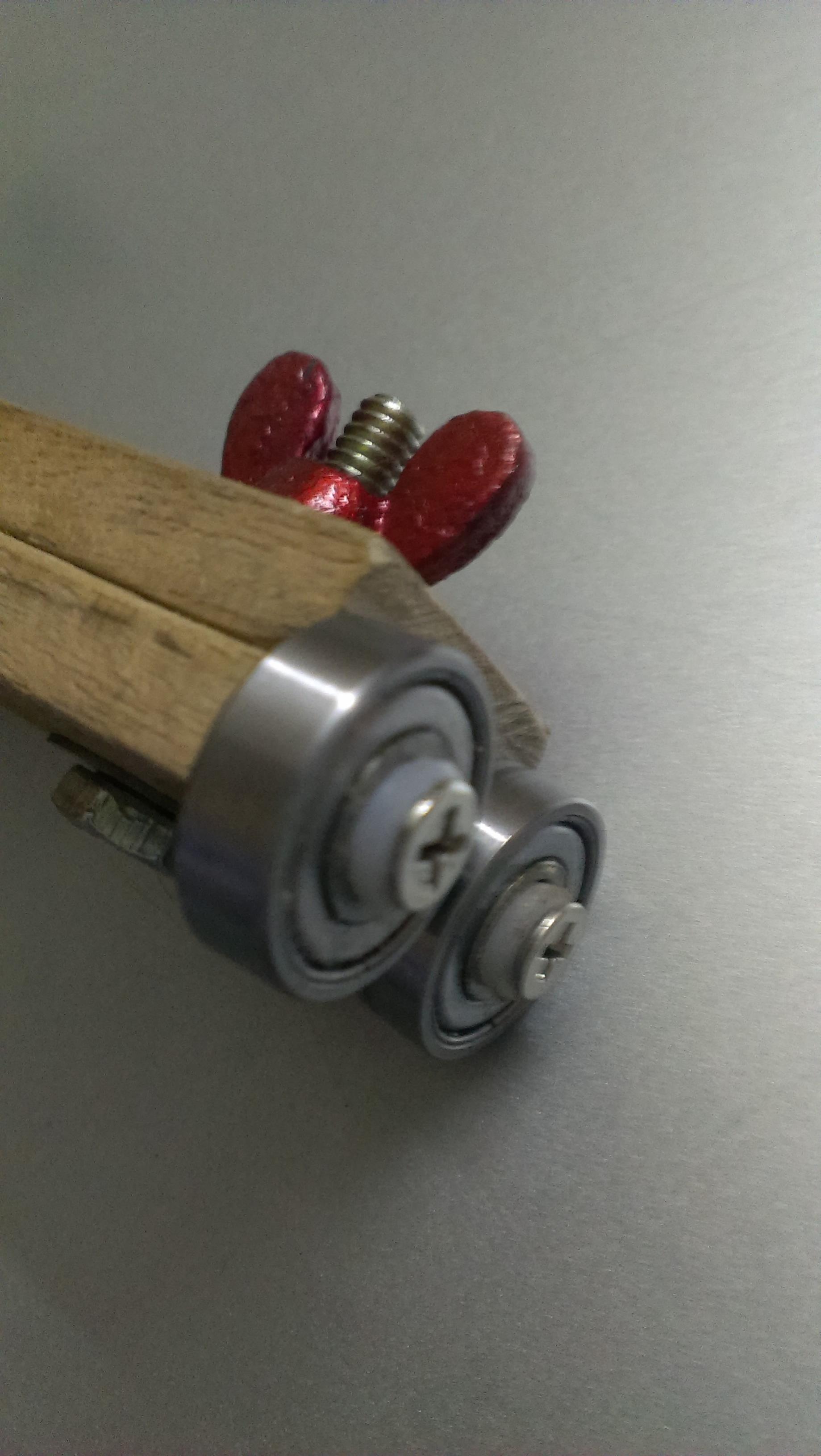

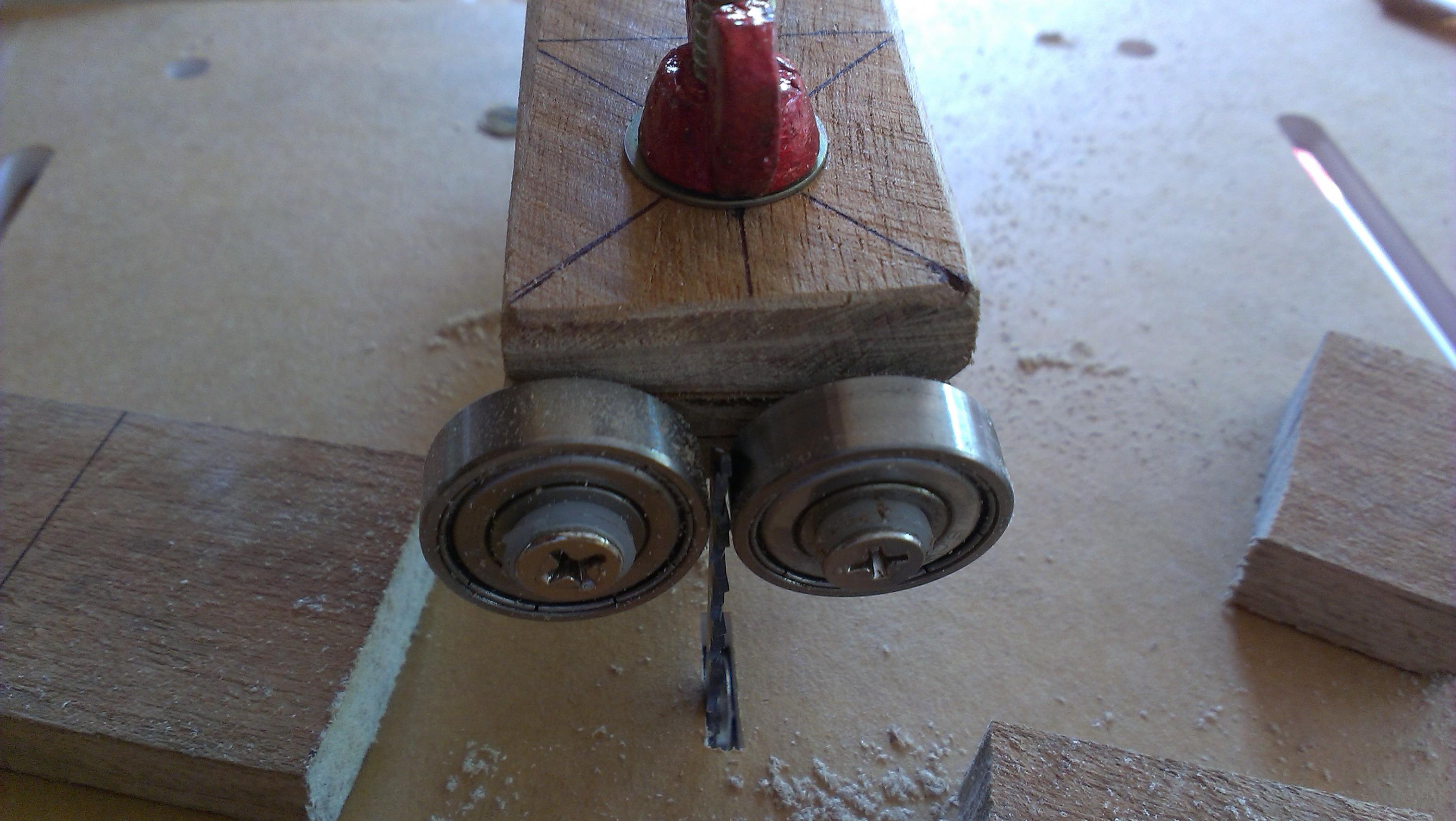

I have added a Blade guide twin bearing system with post, arm and bearings see second photo
Attachment 9675
Attachment 9676H
All above roll out from Sumtonian lab of innovations.
That is why the is called Sumtonian Jigsaw Table Board
Now very complete handy unit with modded 6 inch long Hacksaw blade.
