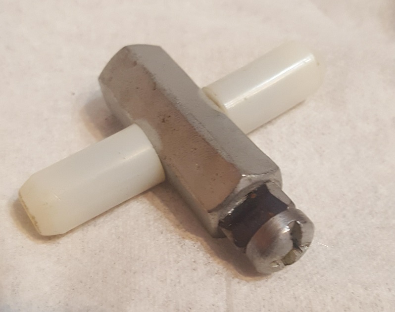

Going through old bits and the like here, I found my homemade gas adapter wrench, thought I share this with one and all, but a little backstory on how it came to be.

So necessity and boredom being the red-headed stepchild of invention, I took a 3/8" Phillips screw, put it in a drill to turn down the head diameter with a bastard file, took a nut and ground off every other point, put the whole thing on a 3/8" coupler nut, a few other bits, and a wrench was made!
Attachment 24090
I know it doesn't look like much, but over any holiday weekend, it put a LOT of $5 and $10 bills in my back pocket at the hardware store, for moving their adapter between tanks. Had one of the other guys take it when I wasn't looking, he was all pissed off because it wouldn't work for him - didn't tell the idiot the fittings were left-hand thread!!!
