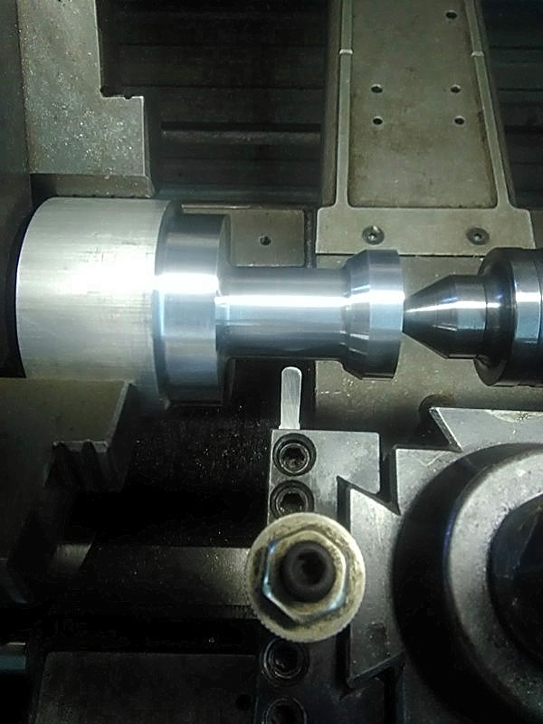

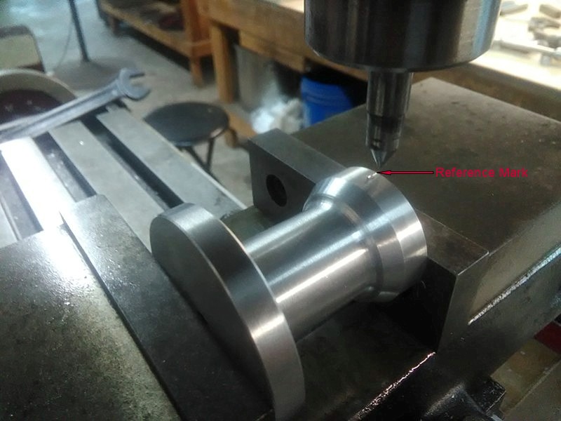

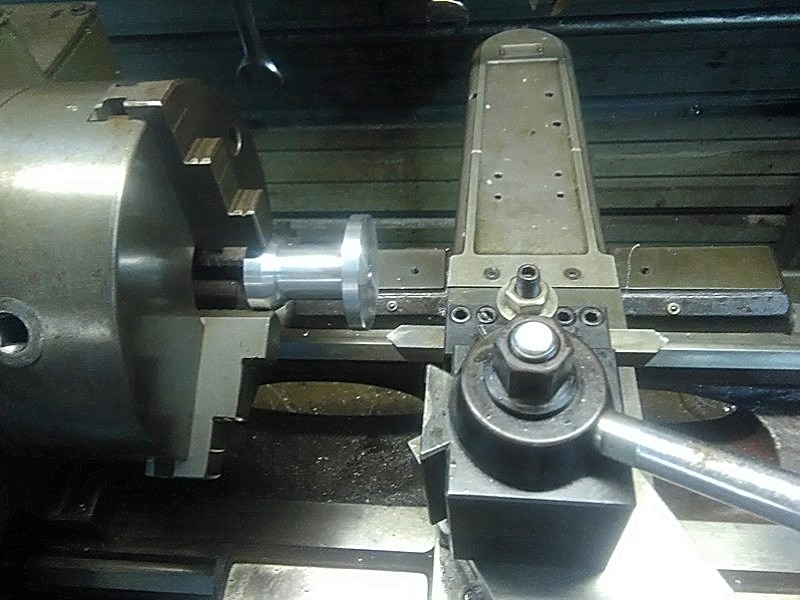

    The other day I was using it and discovered a crack in the cross feed screw bearing housing, it was pot metal as well, so I had to make one of those, I made it from a piece of 2.750” round 6061 aluminum.
    One tip on making this part, when you get ready to drill the two 17/64” mounting holes use a piece of 5/16” C.R.S. round about 5” long to locate the centers of the housings, clamp one side of the housings together and drill the opposite hole then visa versa. The reference mark on the housing was scratched on using a piece of 3/8” round HSS tool bit ground to a very sharp point held in a 3/8” collet in the milling machine, locate the center of your work piece with the tool bit, touch off and go down into the surface of the metal about .007” deep then cross feed ¼” long.

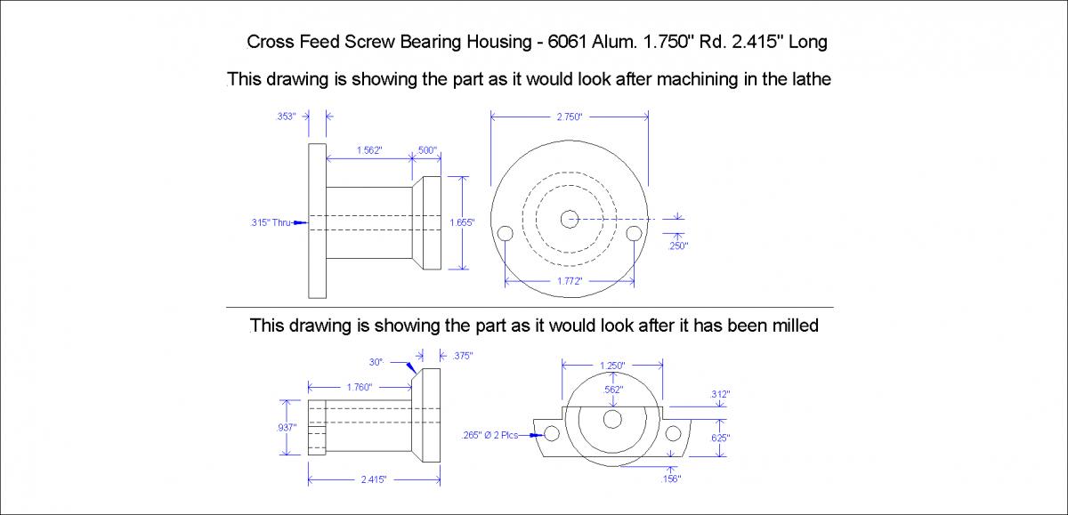

    Below you’ll see some photos of the machining process and a cad drawing of the part, I hope anyone with one of these little machines will find this information useful.
    Turned and ready for parting off
    Facing off to required length

    Scratching the reference mark

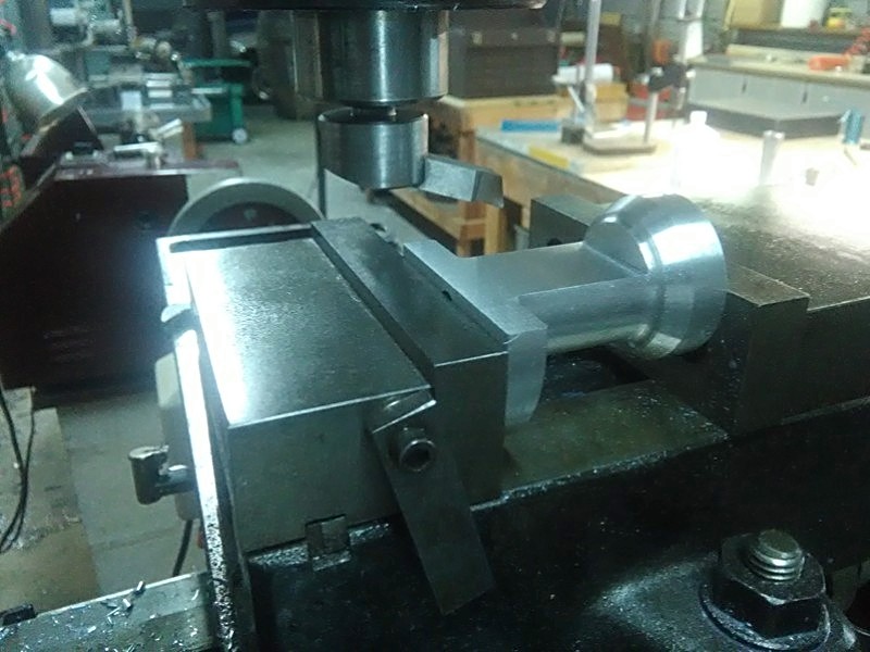

    Milling the flat surfaces

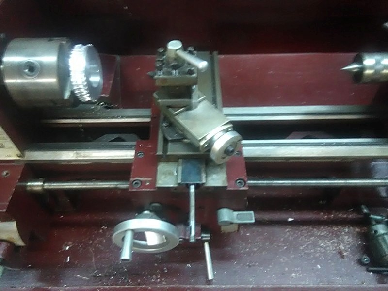

    The lathe this part will fit to

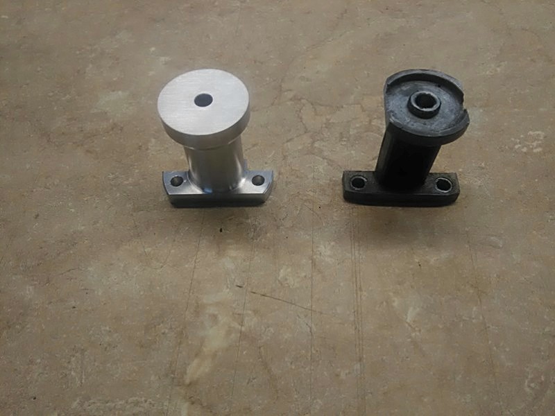

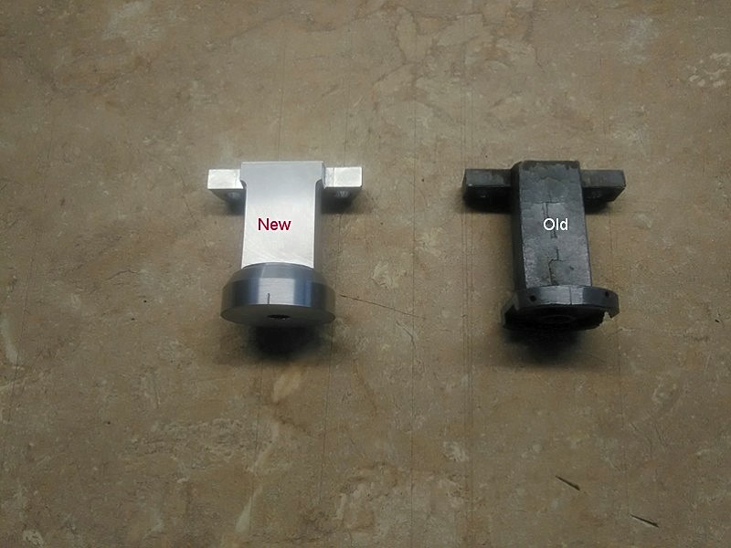

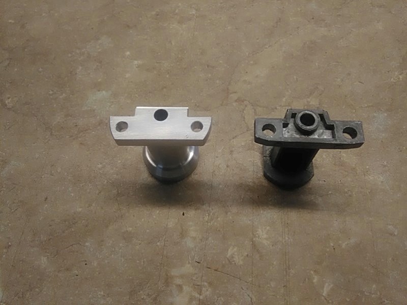

    Showing the new part against the old part

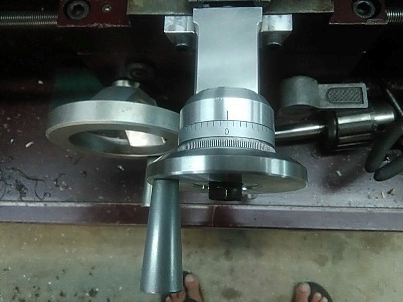

    Installed and ready for work

    Cad Drawing
    Basic Instructions

    Nice work on improving your HFT lathe and thank you for including the drawings. Also looks like you made other improvements such as the cross slide handle and easy to read and adjustable dial ring.
