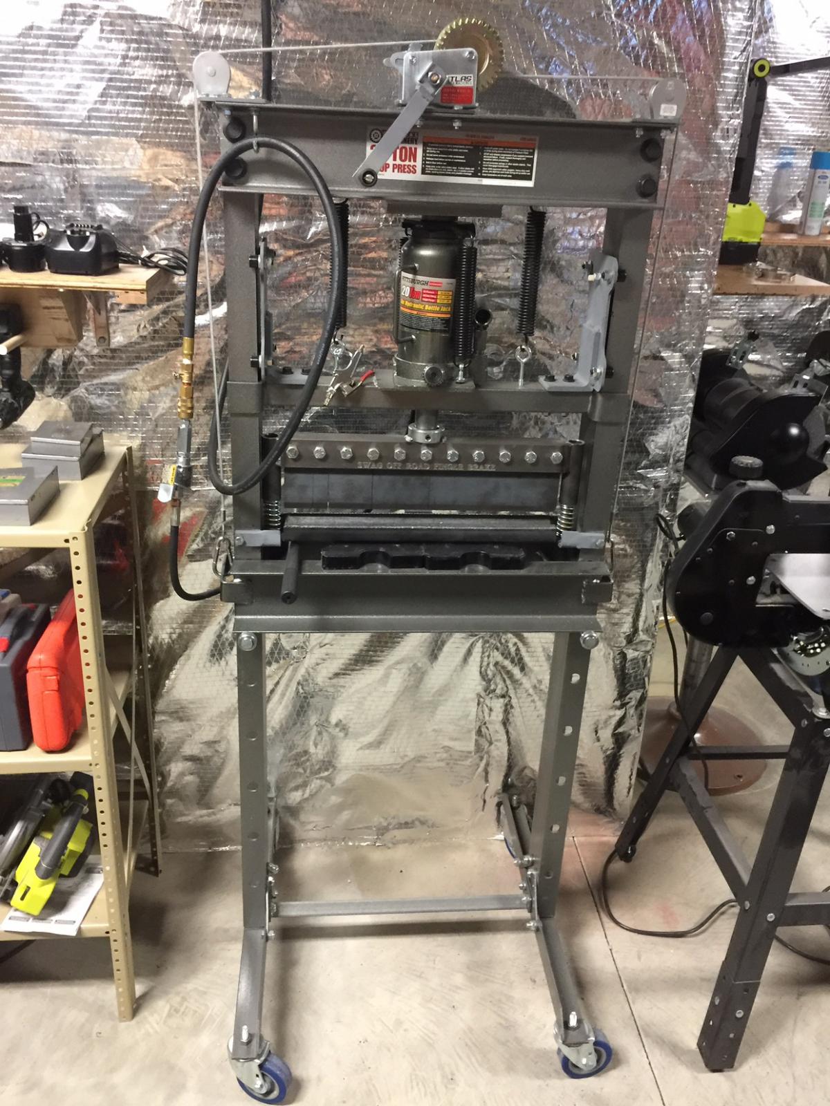

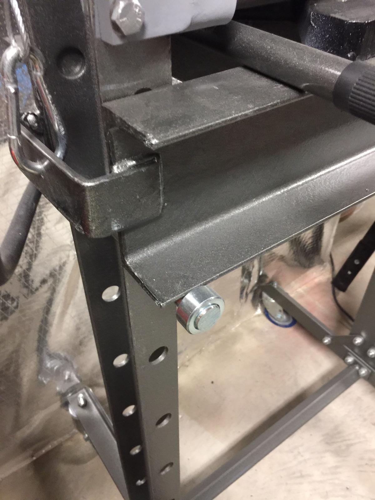

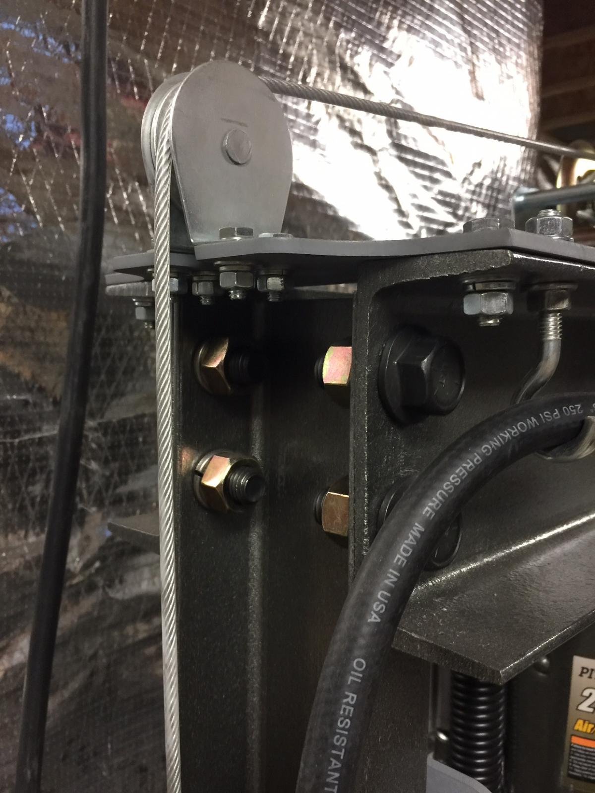

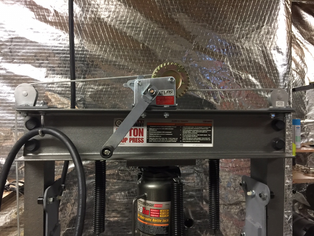

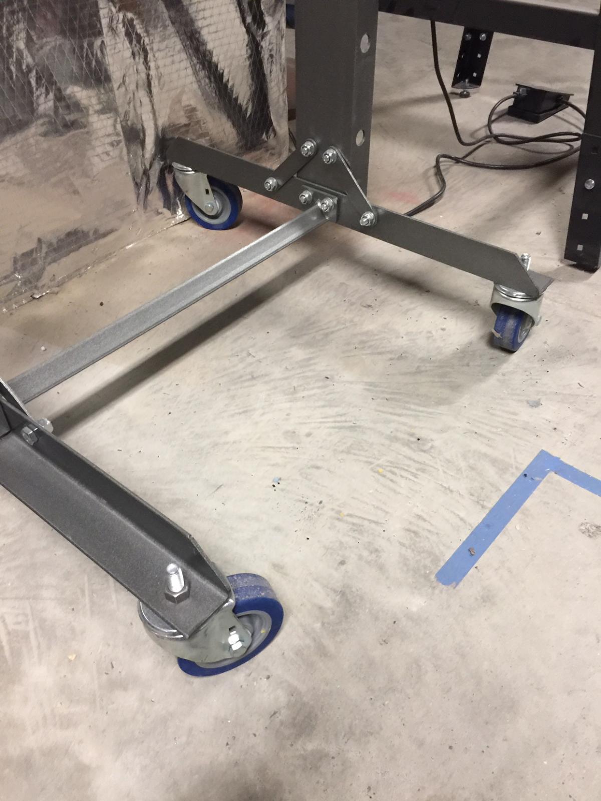

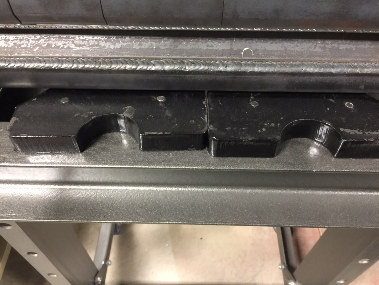

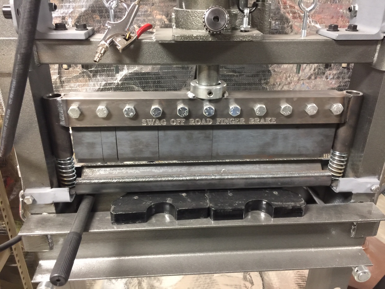

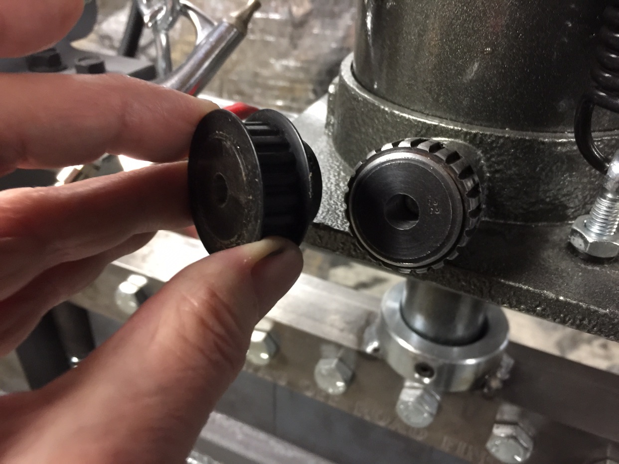

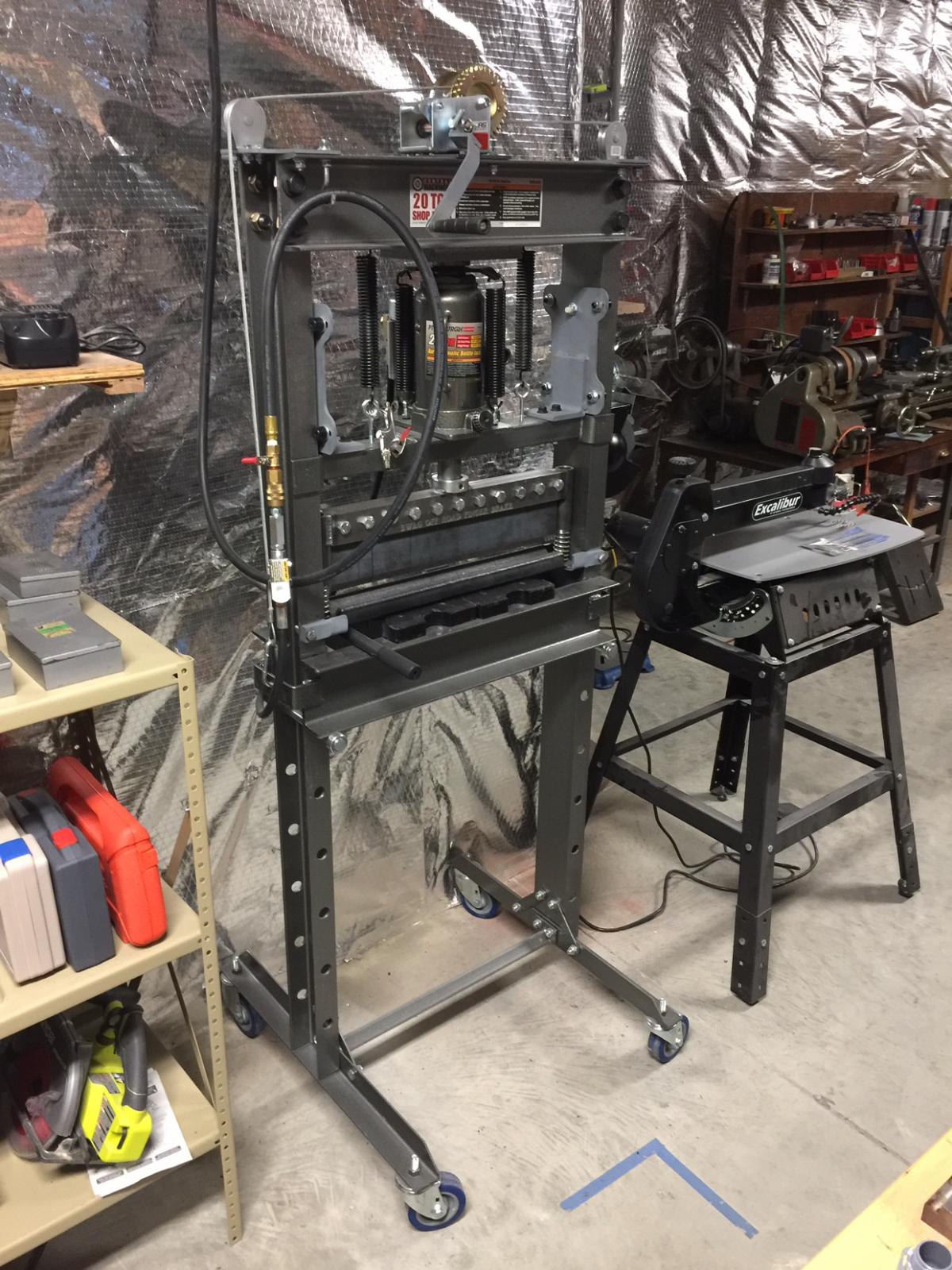

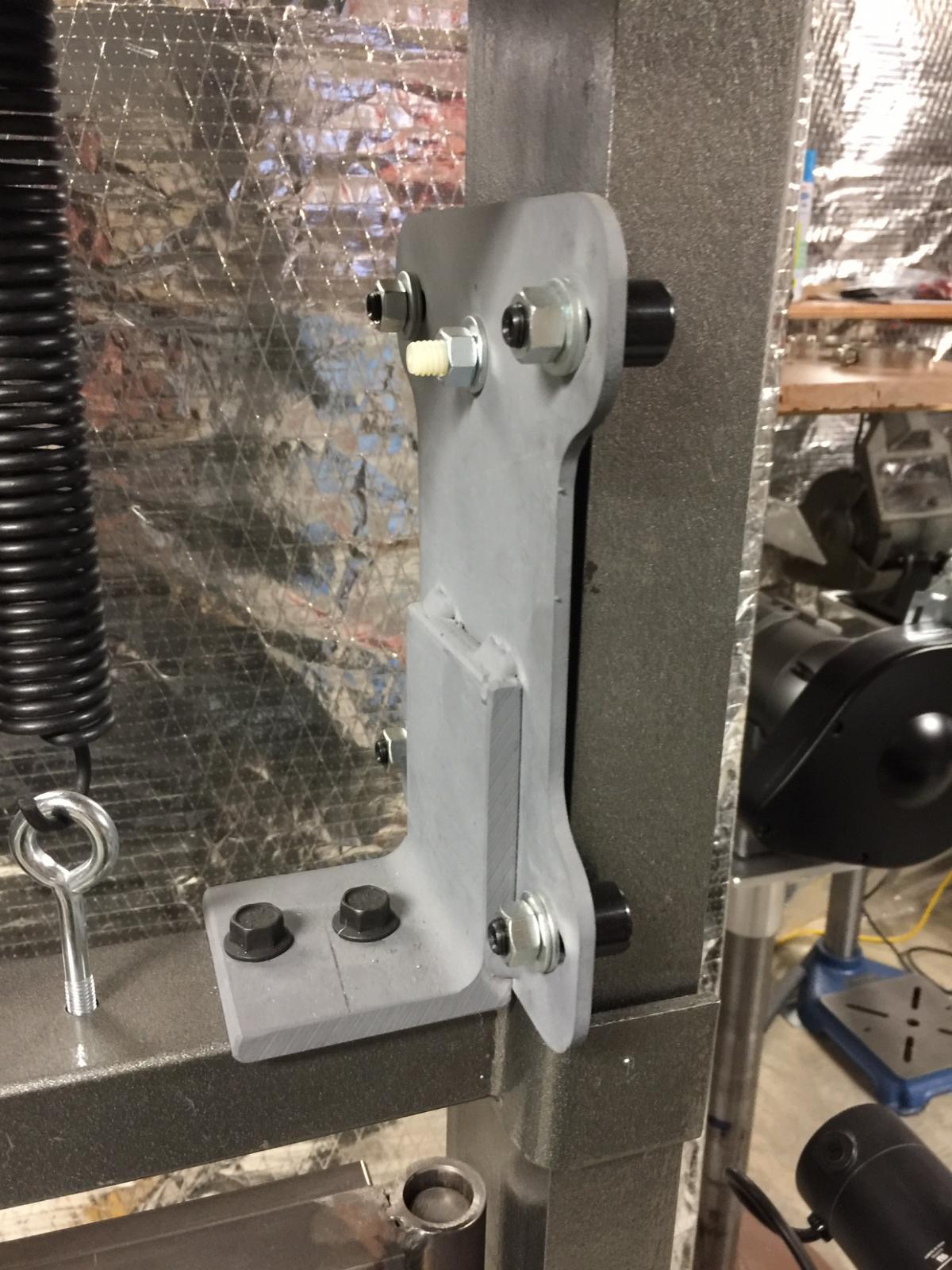

    Like a number of other idiots, I bought a $180 Harbor Freight 20 ton press and then proceeded to pour over $500 into it. Oh well, here's the result.
    Mods include:
    Casters
    Pinned the plates

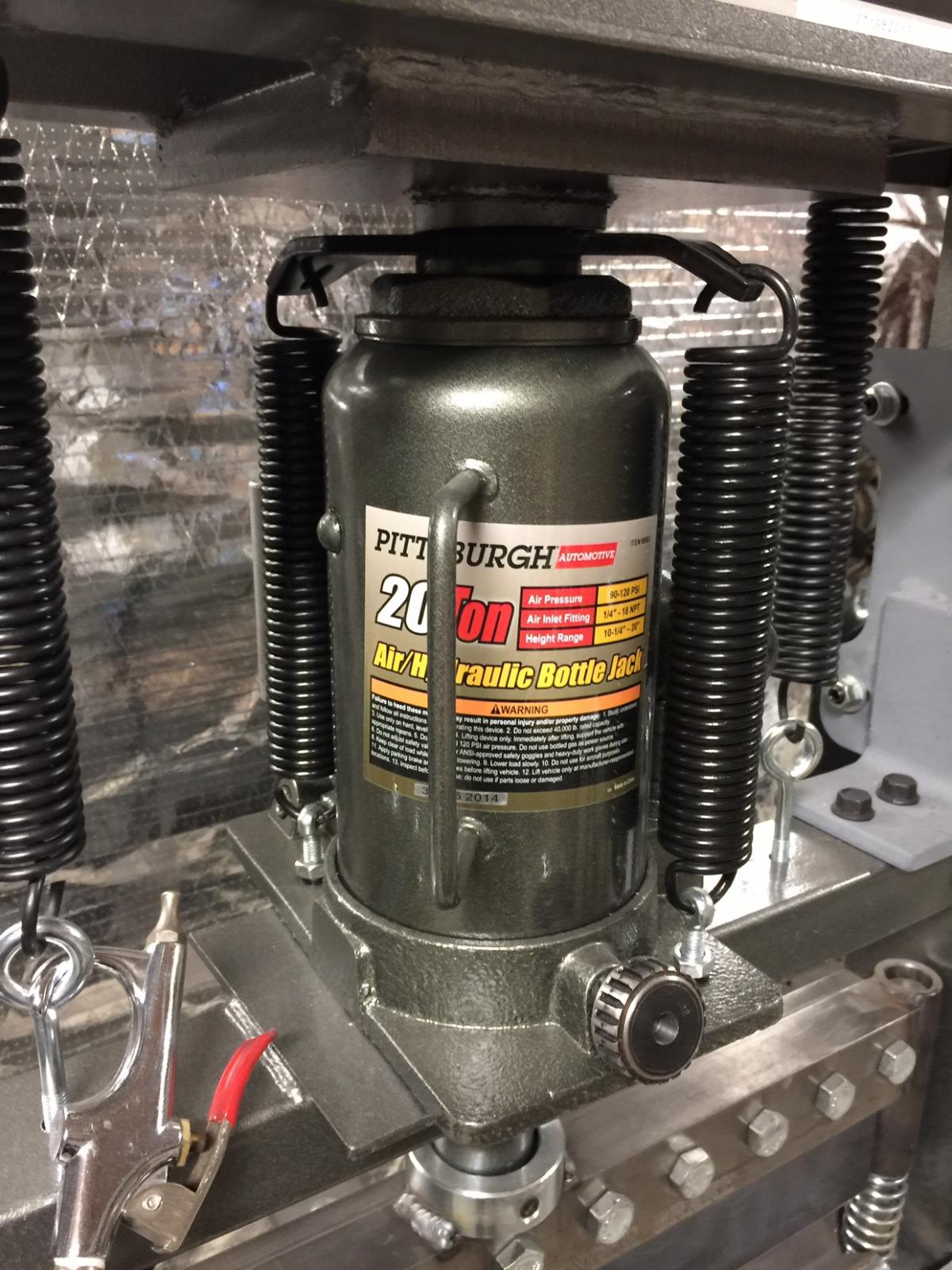

    Air over hydraulic jack
    Boat winch for table
    Individual grade 8 bolts
    Needle bearing guide rollers
    Swag finger brake
    Knob made from turned down timing pulley
    Shaft collars on ends of table pins

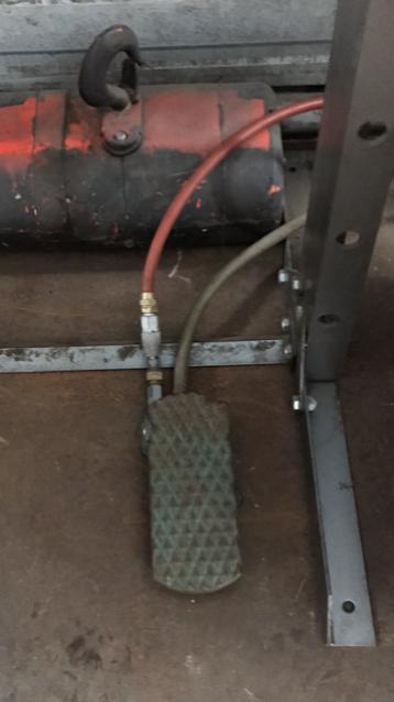

    I've done similar upgrades to my HF press but I added one more bell, or whistle, a foot operated air valve...

    I bought the 12 ton press when I was putting together several HK rifle receivers. I did what I could to stiffen up the unit, but nothing like what you have done here. I think that I may have to revisit my alterations, and go more for what you have here. I especially like the rollers and the knob for the jack. Nothing more frustrating than trying to use the OE bar for tightening and loosening the valve on the jack.
