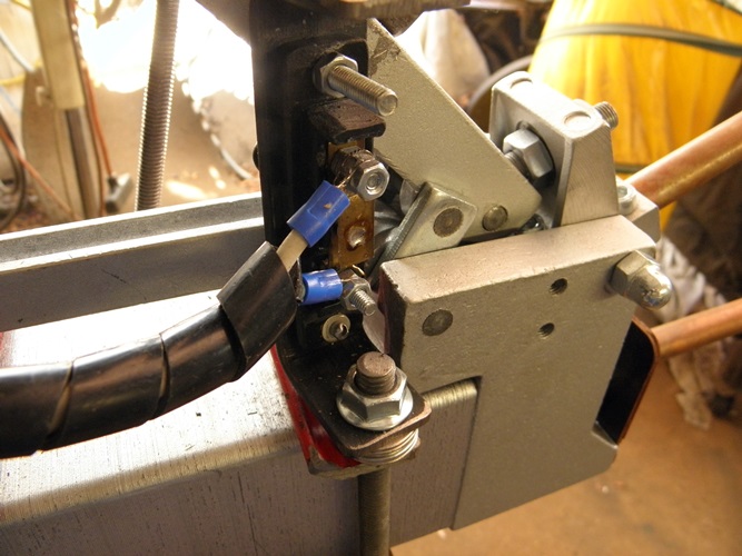

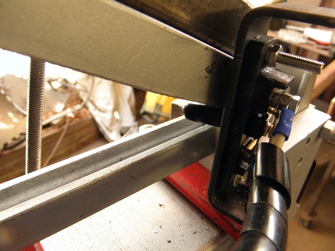

Harbor Freight Spot Welder Modification Relocate switch. Made bracket for switch to be actuated when foot pedal is depressed.

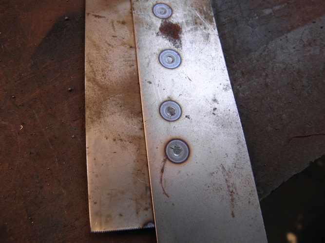

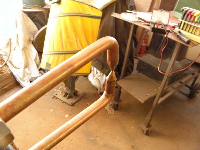

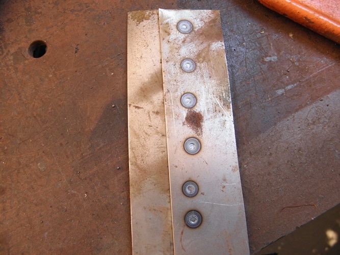

this is a 230 volt spot welder and works perfect as you can see from the photos.
A second and a half does the trick!!!
