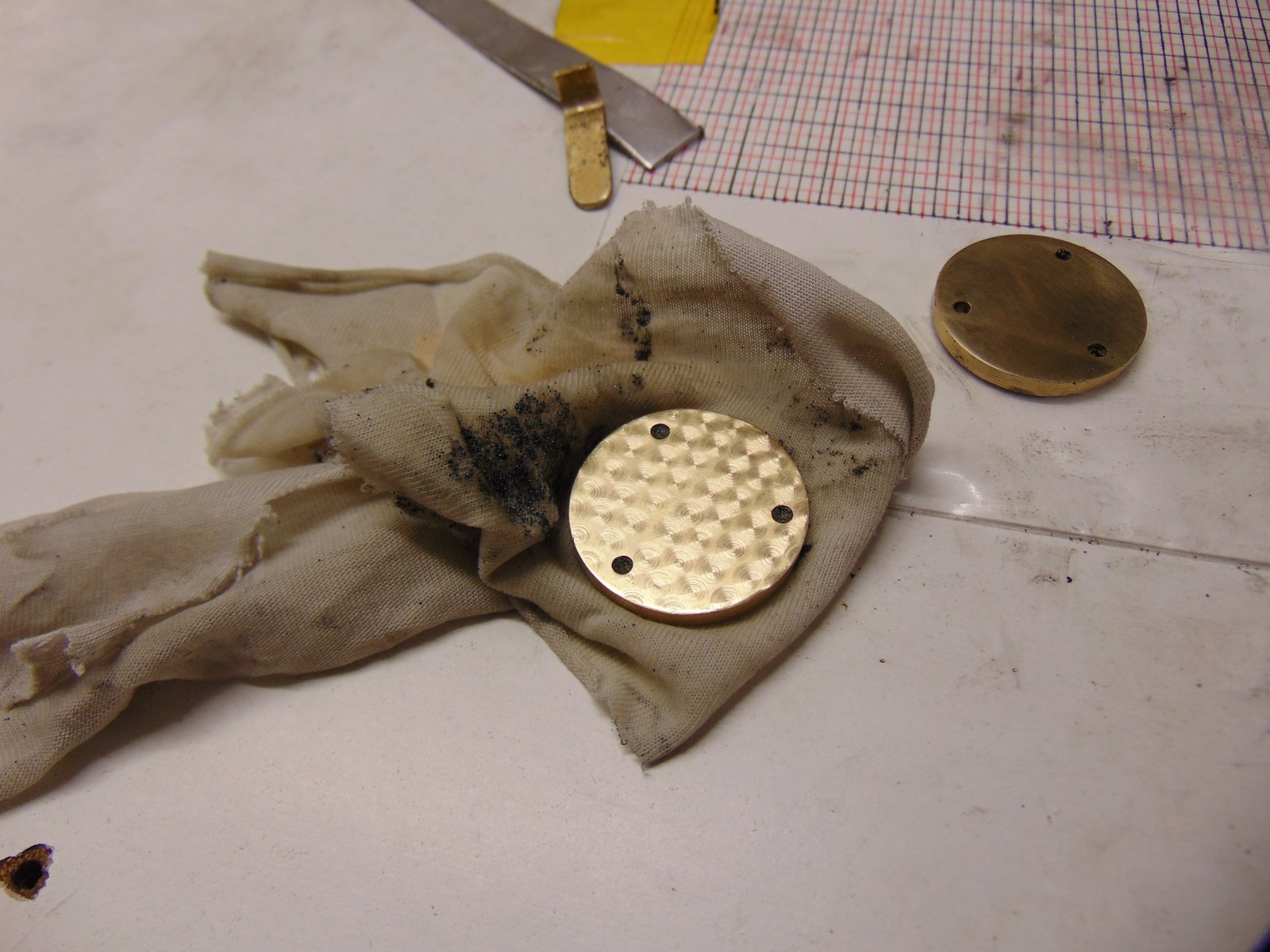

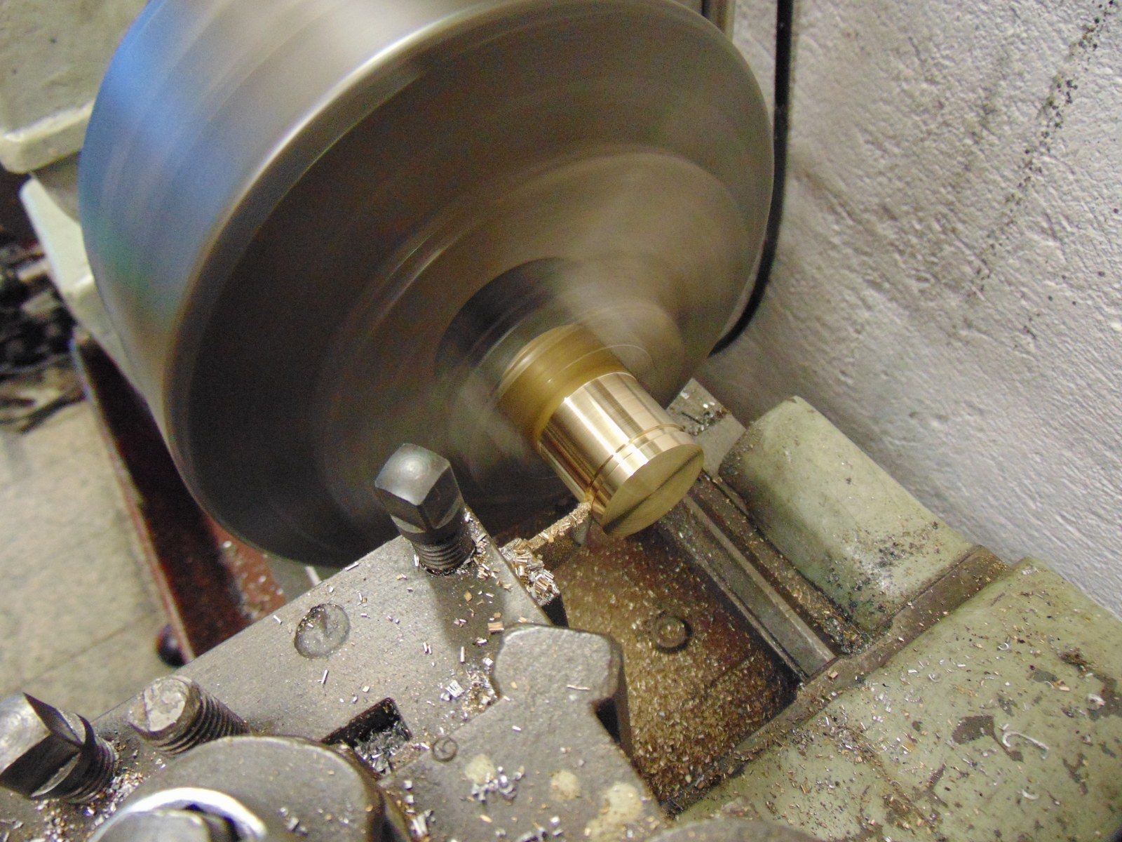

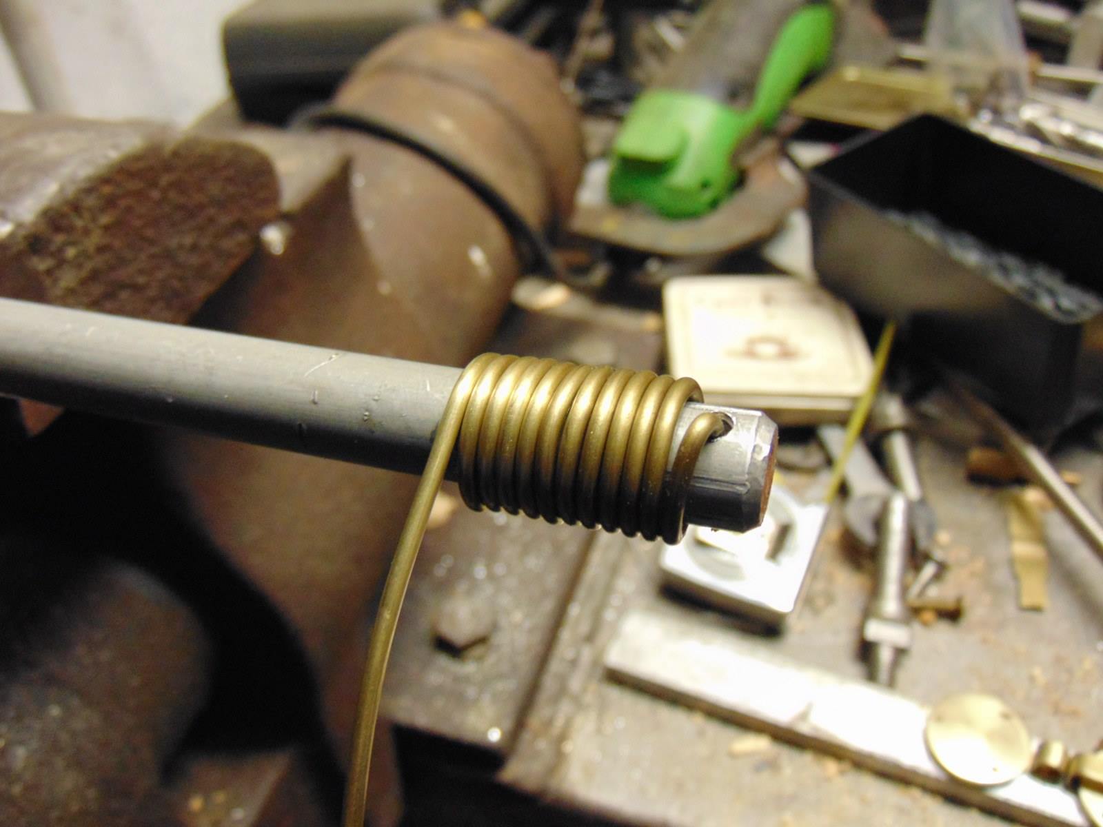

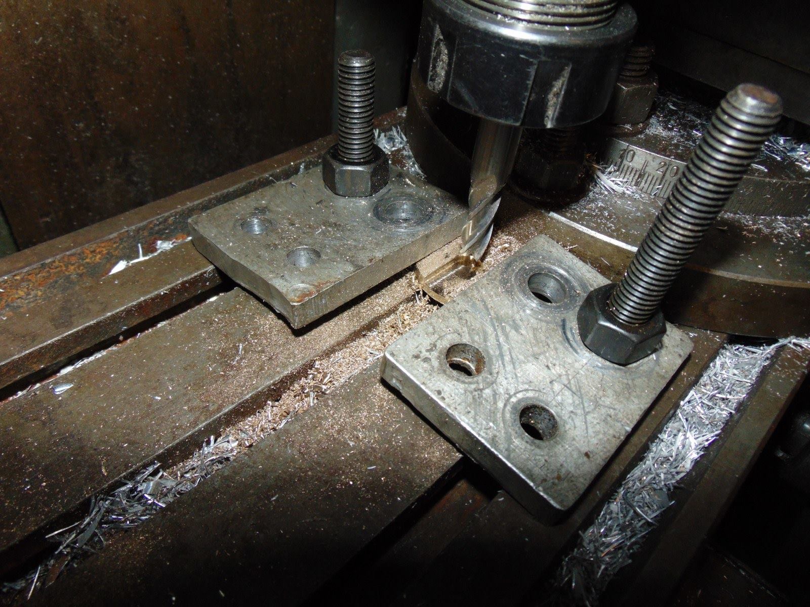

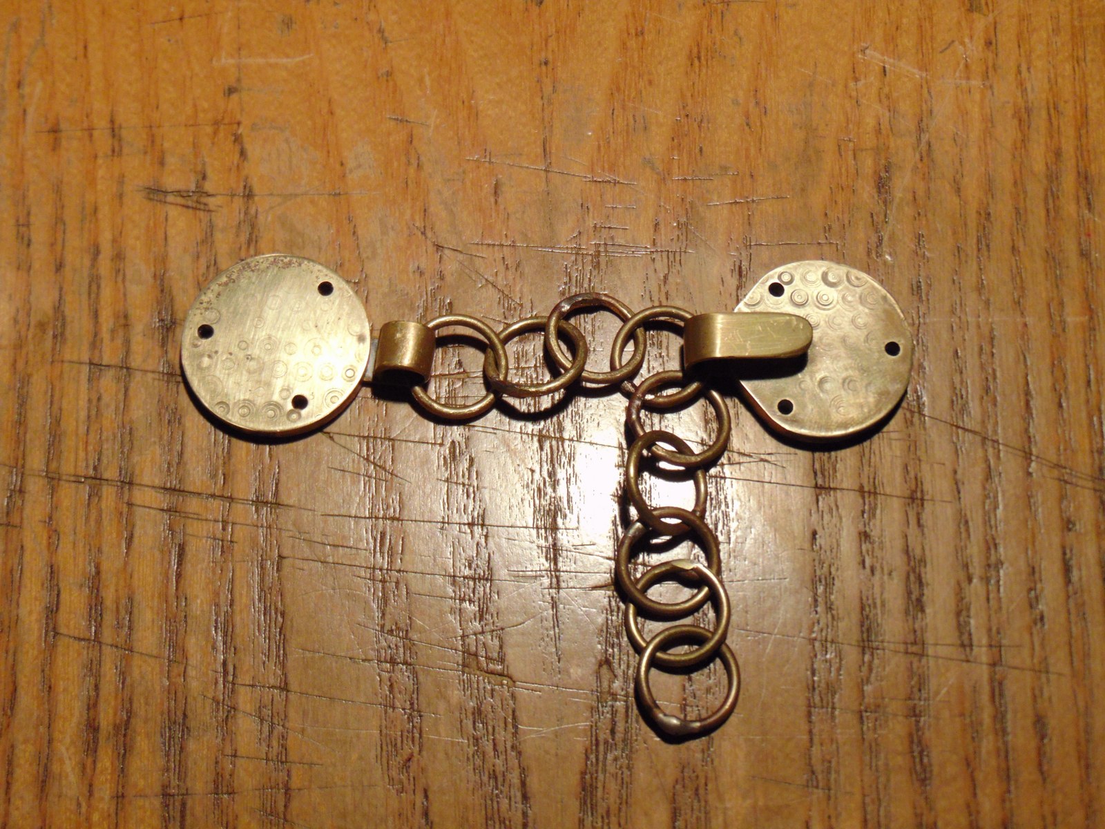

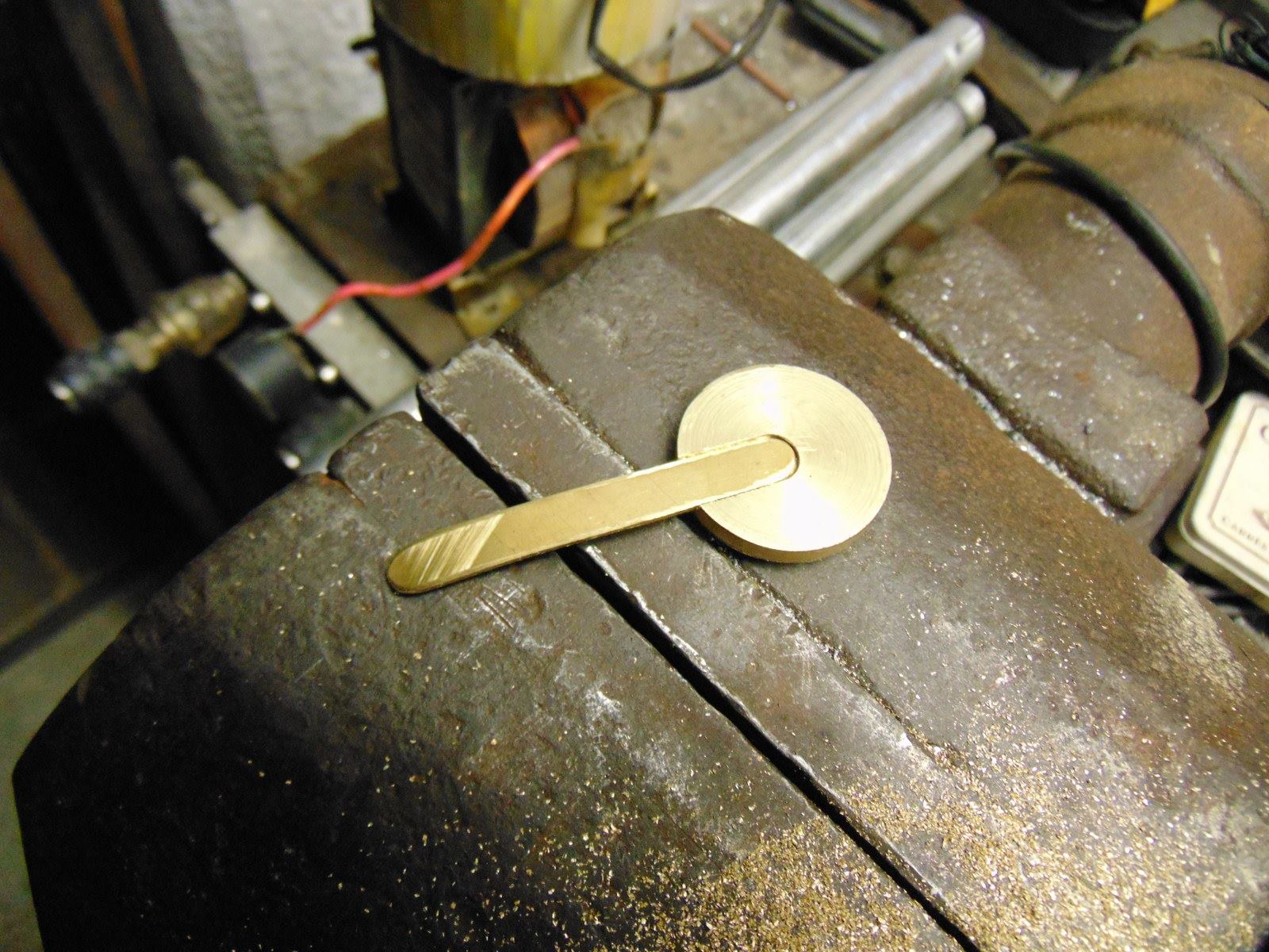

    Just finished the cape closure, ("alamaro" in italian Language) because I built a Tabard.
    Solid brass machined, milled and brazed. I build also the chain with brass wire.
    I chose engine turning as finishing, although the appearence was very nice, it seemed too new for a very old cape, so I decided to give a vintage look.
    This closure can be used with heavy coat, apron or something that weight a lot. My cape is more or less 3kg finished, only one point lock.

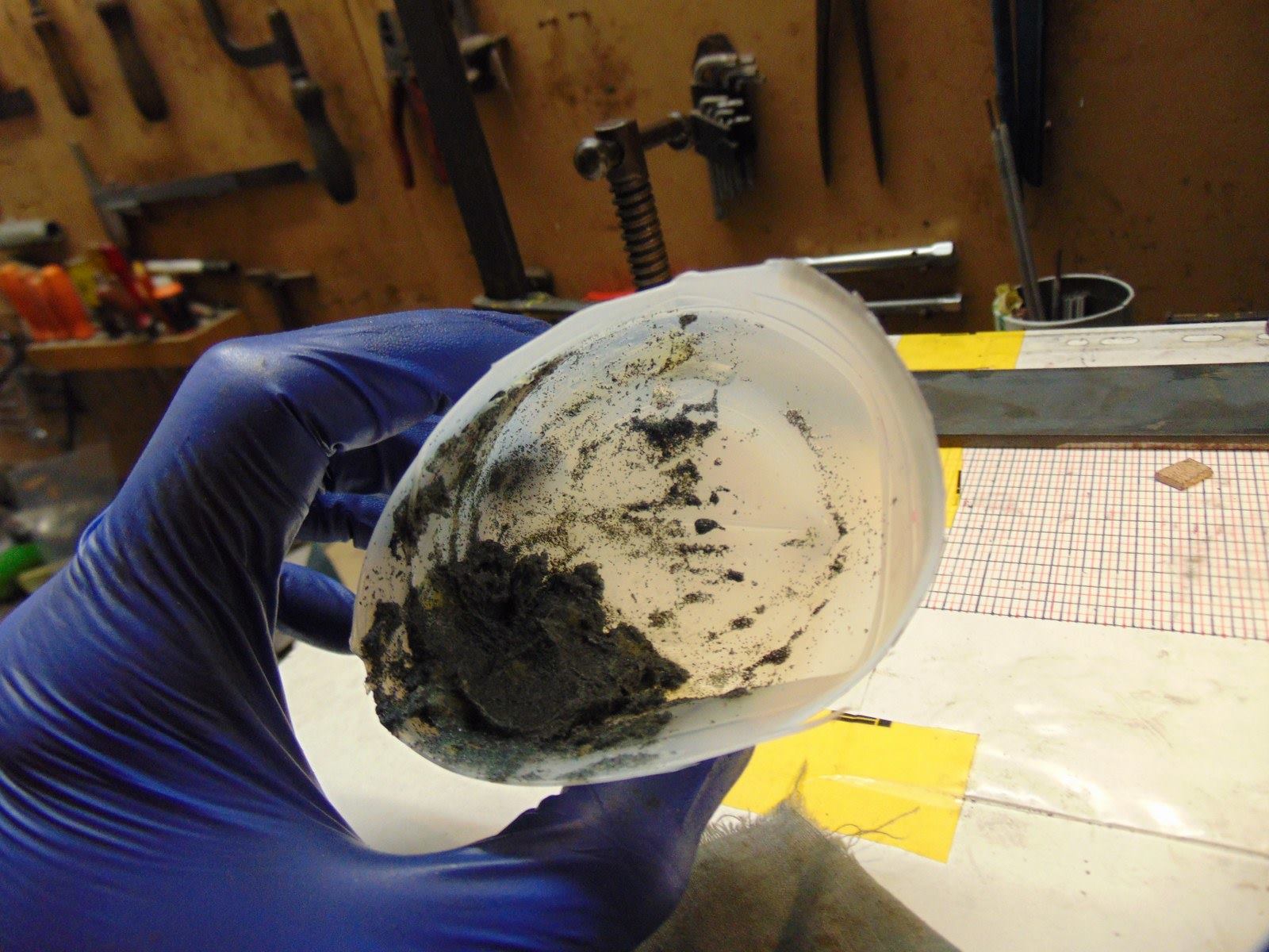

    I used oxy torch and iron dust, I tried by chance a couple of years ago, it seems working quite well for this purpose. After a little polishing with a 800grit sand paper, time and normal oxidation will do the job, I think.
