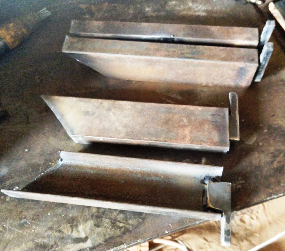

Having a need to rearrange some of my electrical panels and mount my RPCs (rotary phase converters) I needed to make some substantial shelf brackets to lock into the E tracks on the walls of my machine shop van.
they are made out of 3" channel with a 1/2" tab welded on them
Attachment 42076

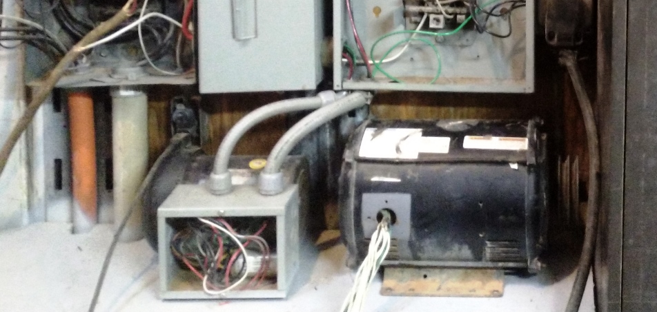

On the left is my 15 amp RPC on the right is currently just an 8 hp motor

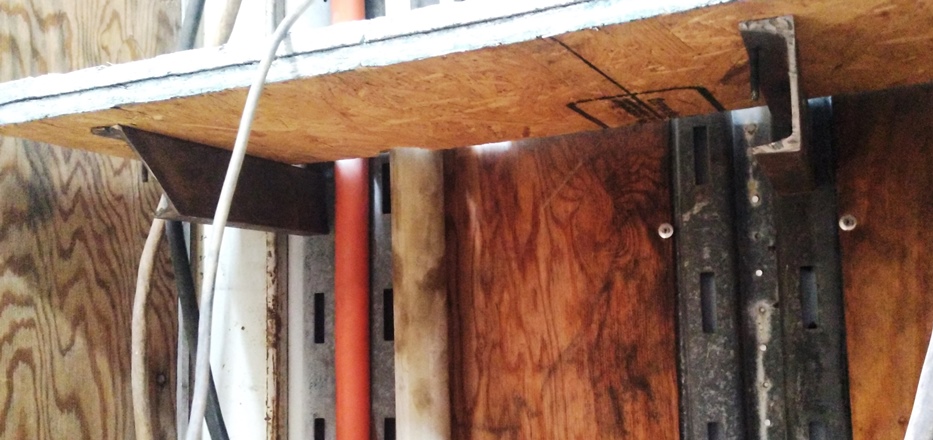

Attachment 42078
