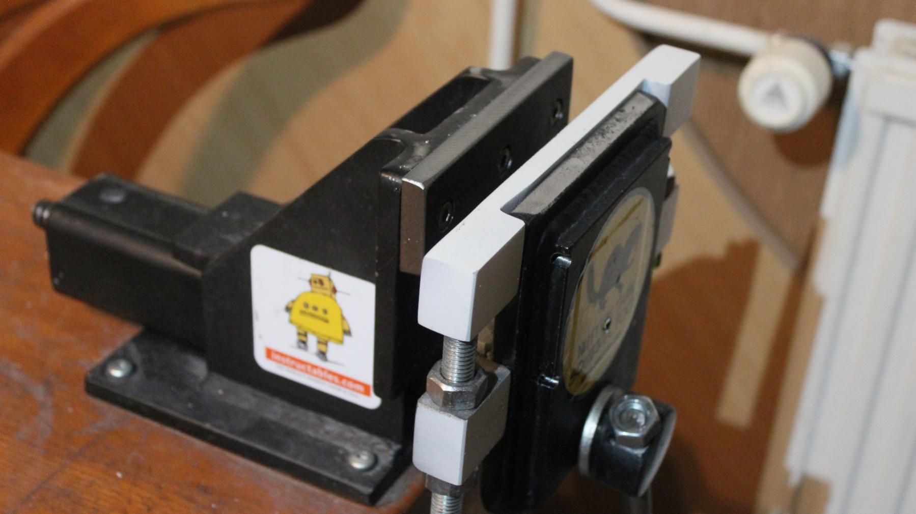

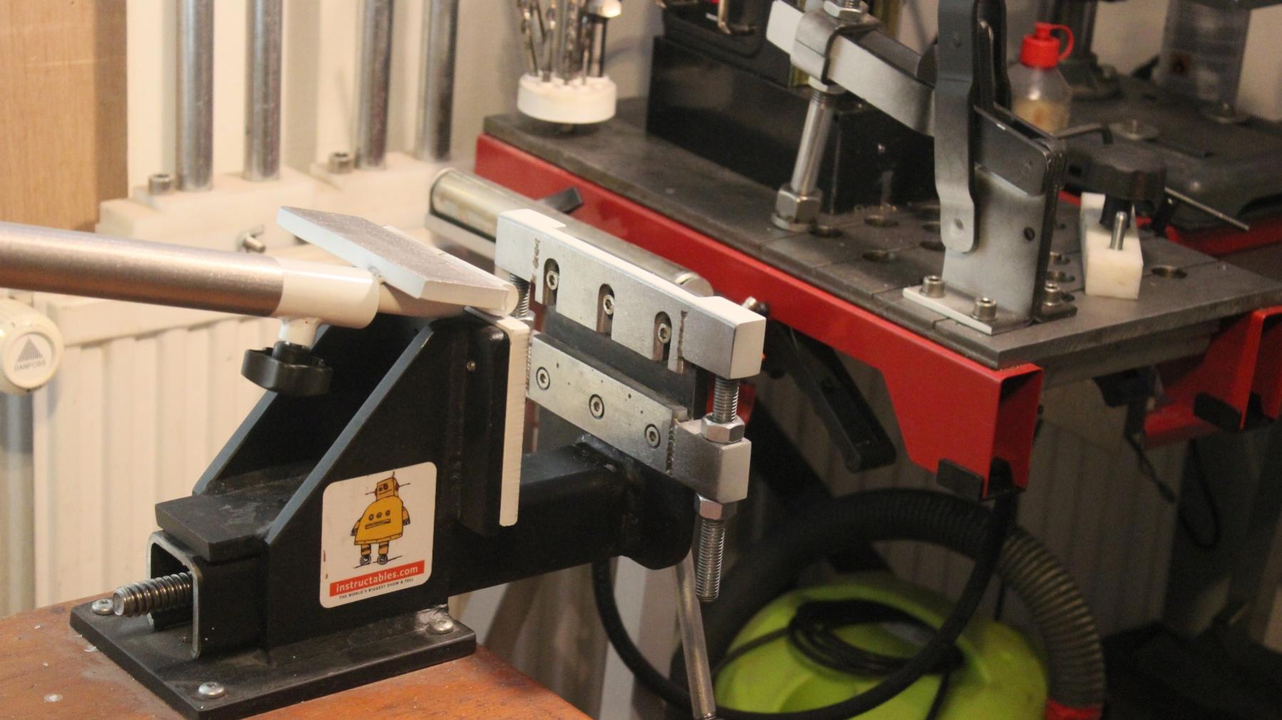

    Made a height adjustment to the jaw of my vise.
    When filing thin objects, allows to lift the other jaw and also the workpiece higher to get better view for the line.
    To clamp odd shaped objects.. helps when bending plastics, allows heating larger area...etc.
    Also it works as a bending radius adjustment when using "my vise bender".
