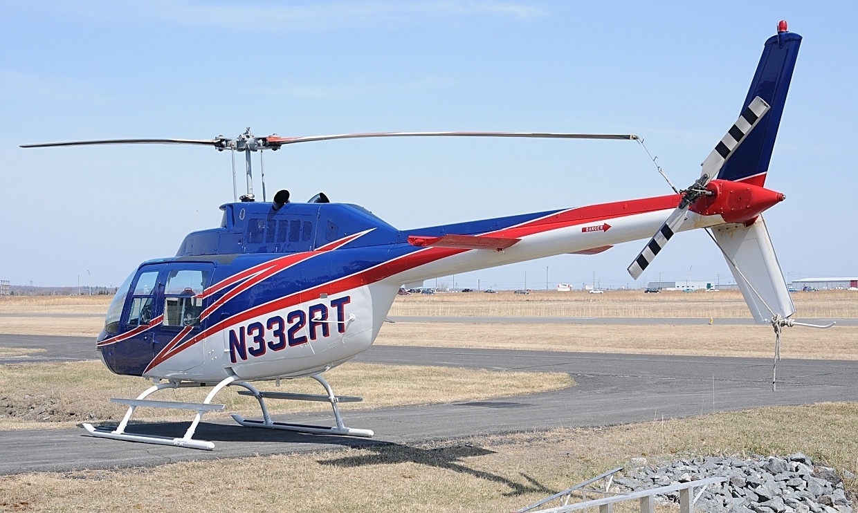

It is (was) a Bell 206 or variant.
Attachment 49375
The tail prop can be hard to see if it is painted a solid color and filmed in somewhat low resolution and frame rate, as Floradawg mentioned above. It also doesn't extend past the lower vertical stabilizer, which is why the tail strikes didn't turn this into a much bigger accident.
