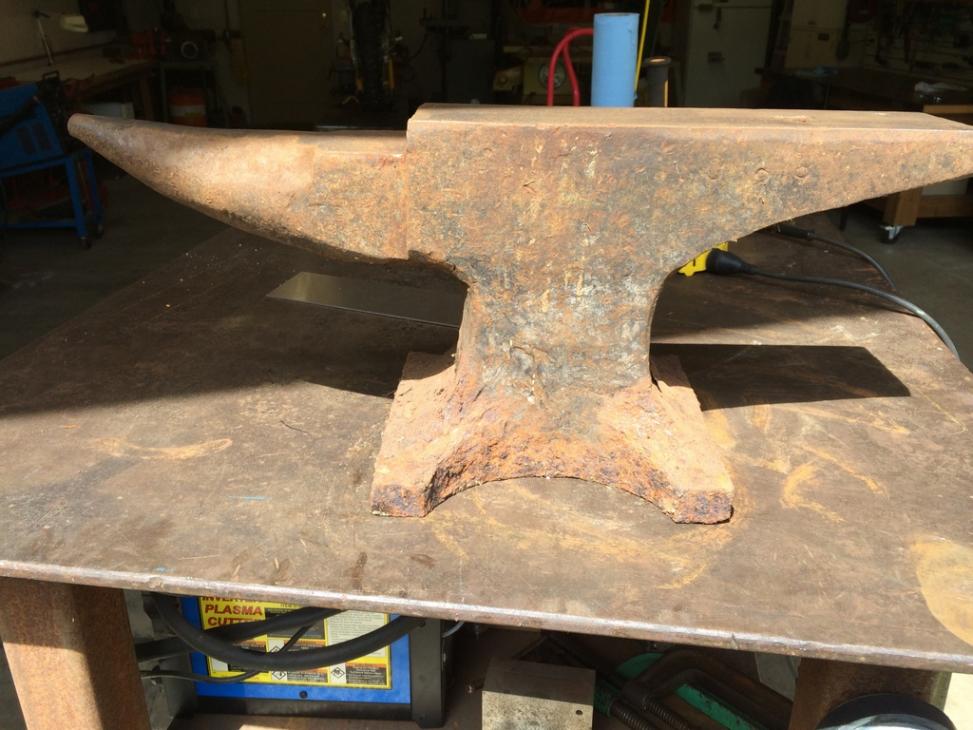

I guess I could start by showing you a "tool" I made recently - More of a "tool holder" I suppose. It stared when I inherited my grandfather's old Hay Budden anvil and needed somewhere to put it.
It was sort of dirty:

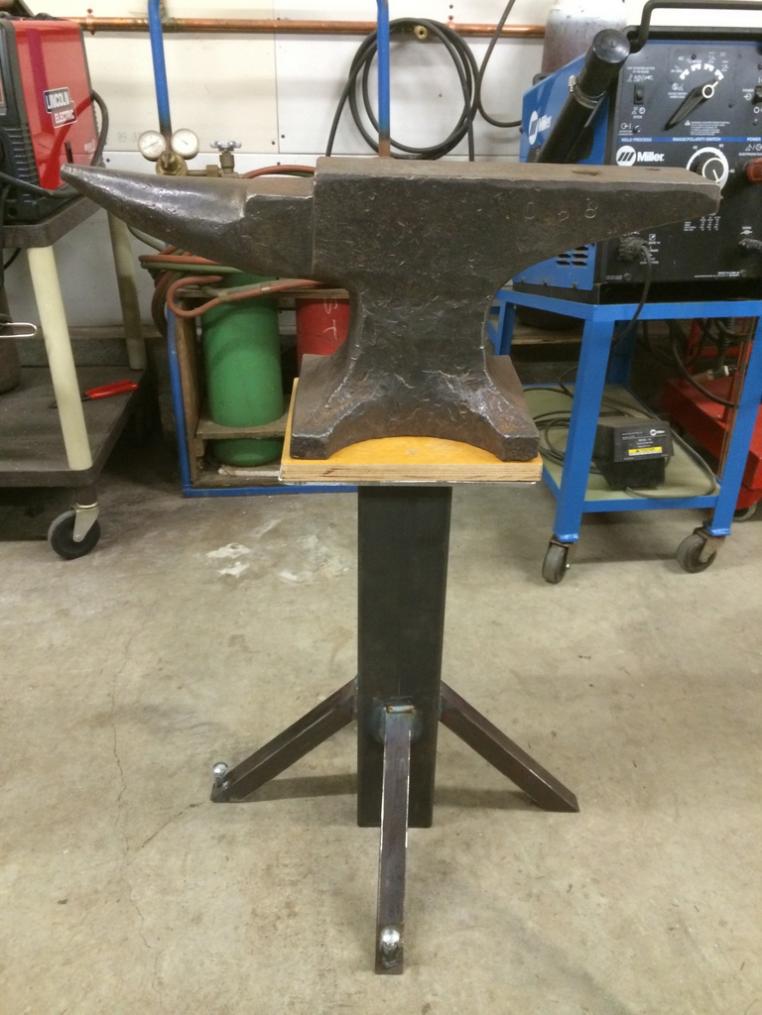

Quick Mock-up:
Attachment 2863

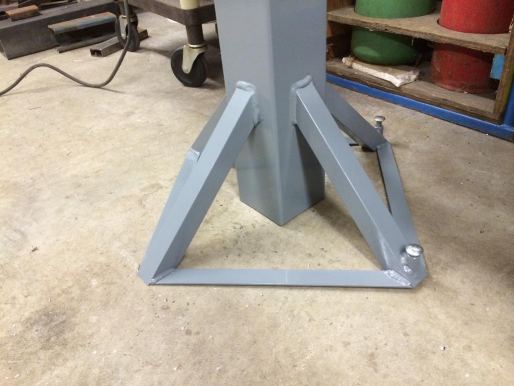

Tied the legs together and added leveling jacks to cope with my bad floor:
Attachment 2864

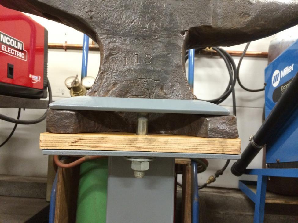

Scabbed a hold-down method:
Attachment 2865

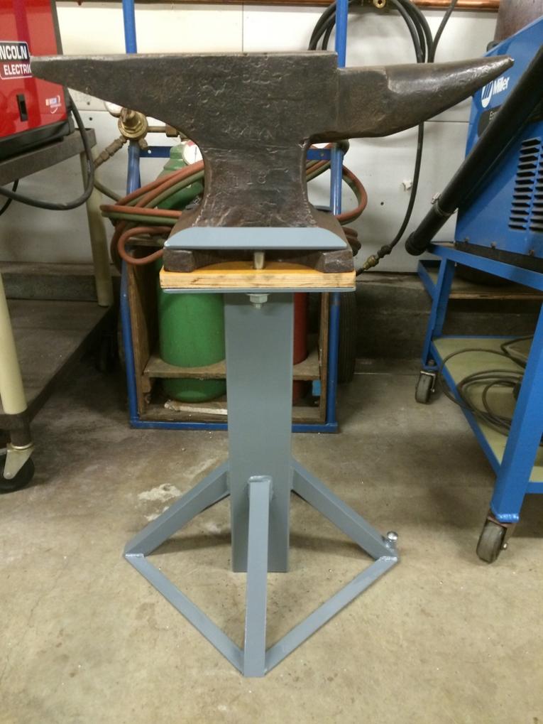

Painted her up and let her collect dust:
Attachment 2866

Nice anvil stand; we'll get that added to the site directly. What else are you working on currently?

Hi Wmrra13, welcome to the forums! Sturdy-looking stand you got there.
Hello Wmrra13. Welcome to the HT forums. Nicely restored anvil. How did you clean off the rust? Electrolysis?
Al
Al,
Thanks for the kind words.
I used a wire wheel (actually more of a wire cup) on a 4 1/2" angle grinder.
This reminds me, I need to put a coat of wax on it...
