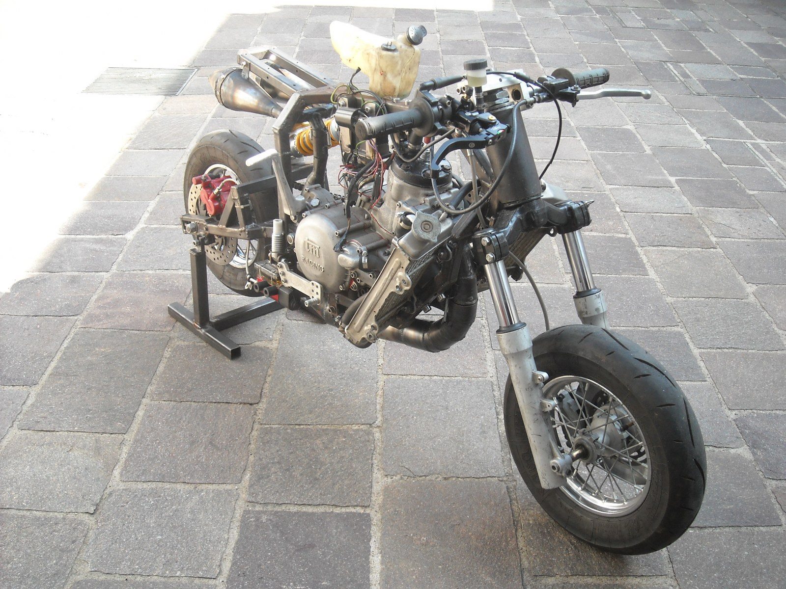

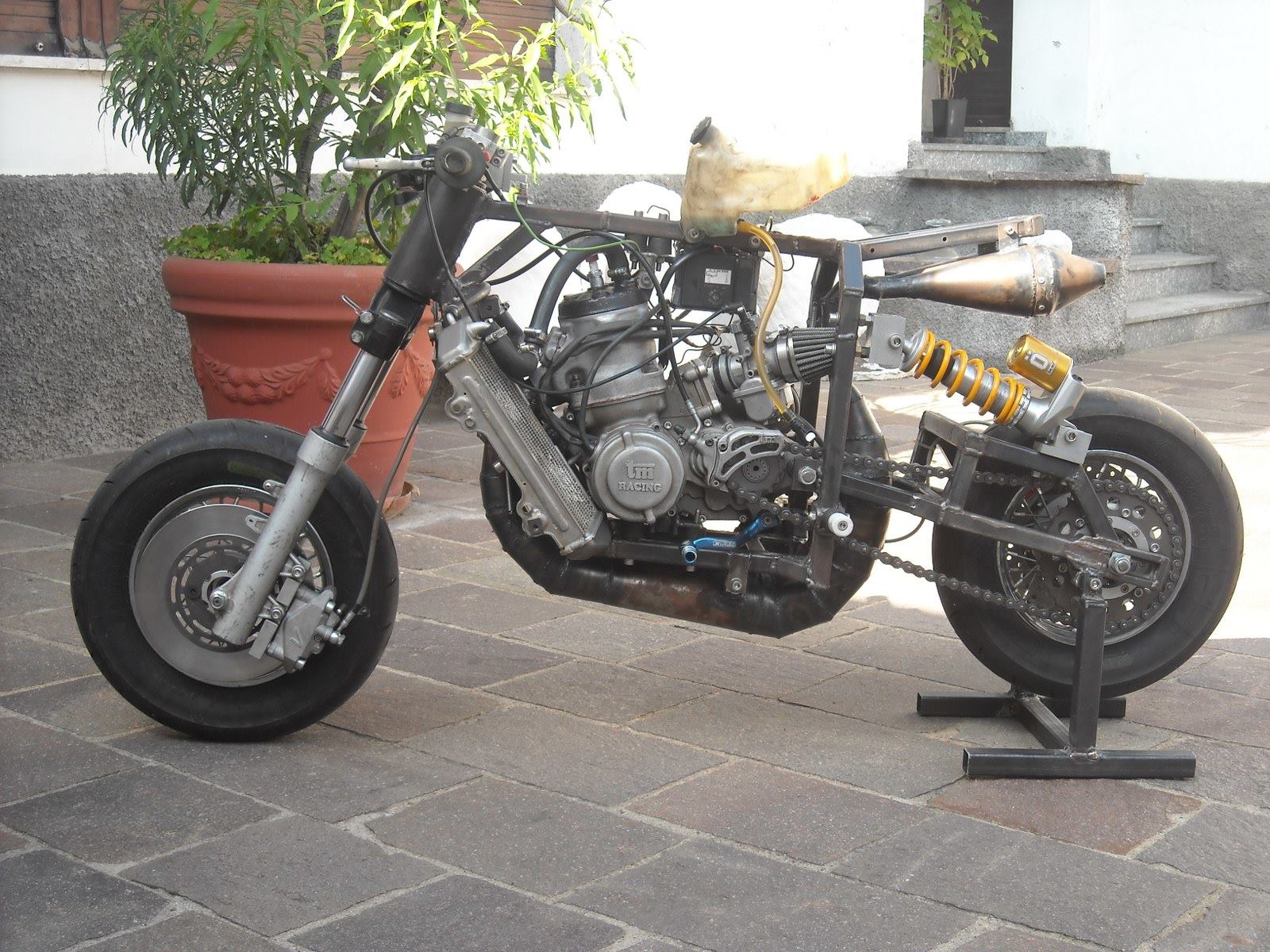

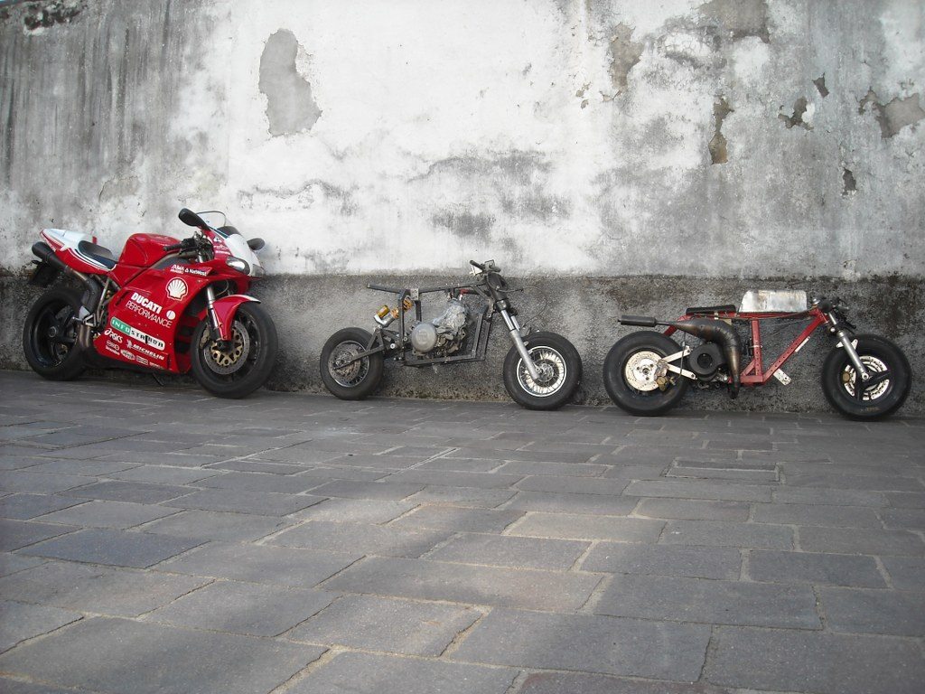

I got passions like: motorbikes ( still prefer 2 stroke ) , big horn speakers, tube amplifiers with handmade output transformers and guns (western, big game rifle and pistol and other tactical stuffs)
I post a couple of photos of my recents projects.

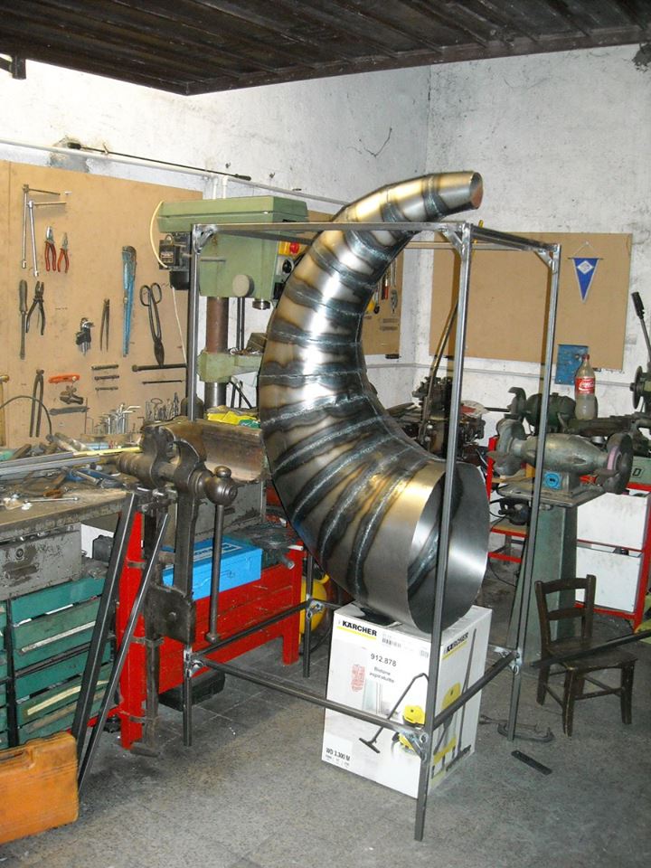

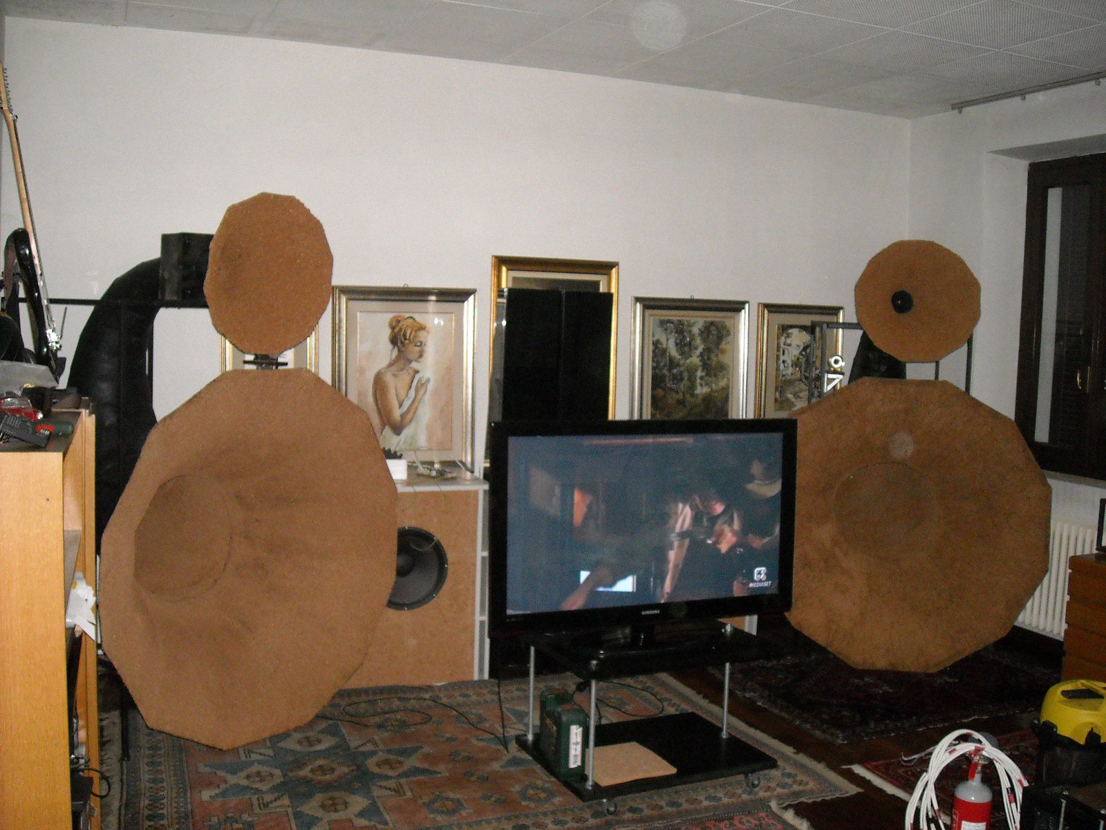

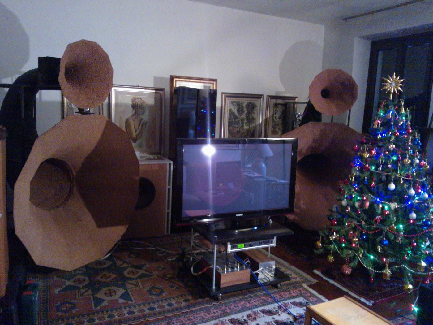

Brief introduction, i tried circuit with almost all the "audio" tube, i was fascinated by high efficency fullrange speaker and low power amp. My first diy speaker was 94db\w\m (fullrange) , the second 3 way with onken 360L enclosure 15" eminence , driver rcf and tweeter apt, the current setup is a mix between onken sub, big Fr double horn, supetweeter, i will add a driver 1" with new horn i have to built on lathe.

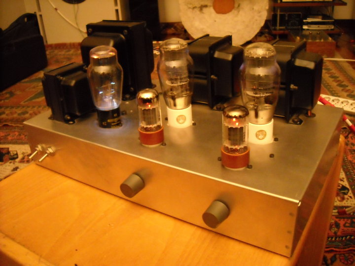

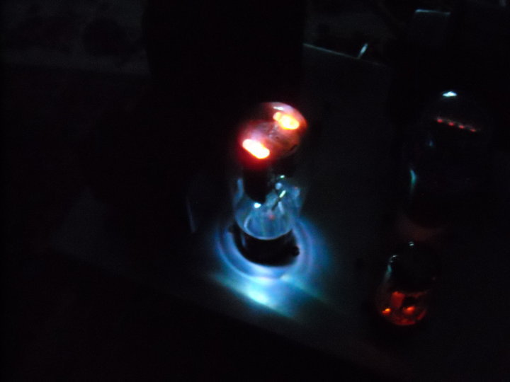

I decided to try direct heated tube like 2a3 and 45, with 6sn7 single ended driver and 83 mercury vapor rectifier with 2 chokes and good capacity enough to silence the sound of power supply. at that time i buyed a couple of output transformer (plus psupply and choke) from Novarria at Milano. "Low priced" 15w rated 16sections and double C core 20hz/20khz, in my opinion nice to look but not to listen:D
After this i tried the tiny Ecl 82 amp "Lo scherzo" of Chiomenti
Scherzo
100va power transformer, 2 chokes (i want to modify the ps with gas tube like 0a2, 5651 and maybe a tube regulator circuit) and for the first time i made the output xformer. 60H of primary inductance, 5k, 20hz fq min, really hand made each coil ,flat, teflon insulated. The good thing is that this little amp capable of 1,6w in triode connection sounds much better (above all in the 30\500hz) than the 2a3, much better than i sold the dht and i kept the little monster;)

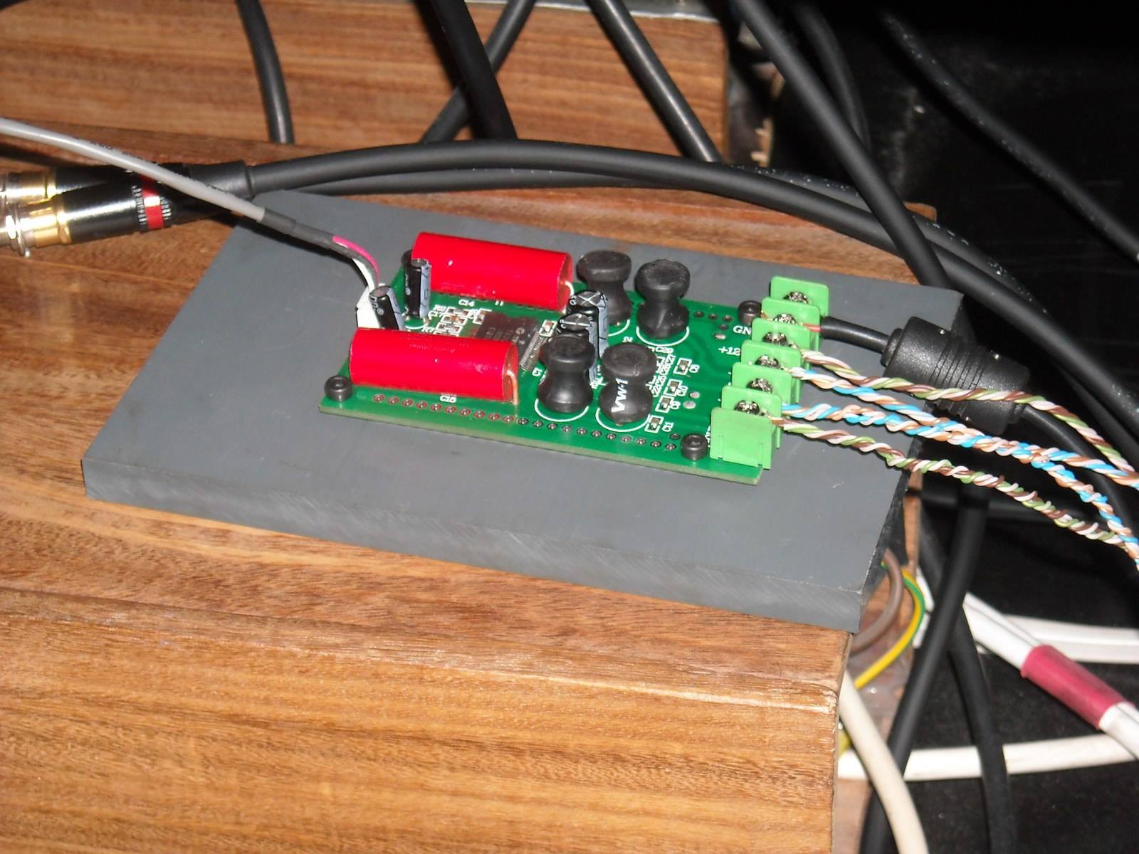

Now i got this ecl82 as primary amp, with 110db\w\m speaker i dont need more than 0,5w in normal use, the gainclone inverted lm3886tf for sub, and a cheap chinese board (i'm testing it) with ta 2024 chip for +13khz tweeter.

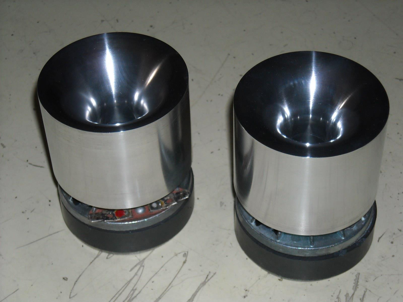

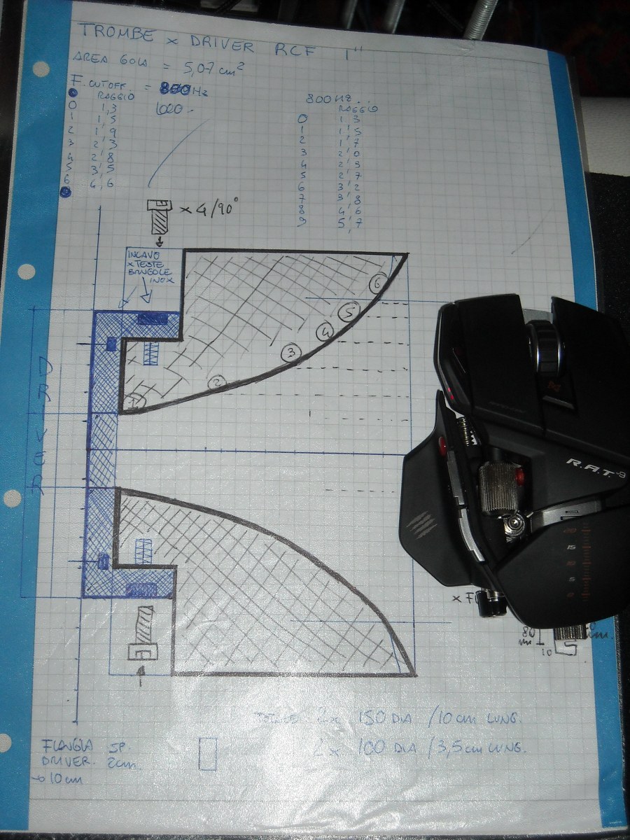

one of my next projects is a couple of horn made on lathe from a solid 130mm ( +/- 5" ) round bar of aluminum. the drawing i made is a bit old, i want to change something in the back flange that links the horn and the driver, close to tweeter horn in the first post. (rcf 1" nd1710, titanium diaphragm).
I have to create some good threading internal tool for lathe and learn how to use properly, i was looking for some project in this forum, according to you what's the best (and easy to make) tool? i'm not a boss at grinding :D
Attachment 6487
Have you seen these?
Internal Threading Tools
If you post a note in our Help Me Build subforum, you're sure to receive some useful input.
Please keep us apprised of your progress… :hattip:
