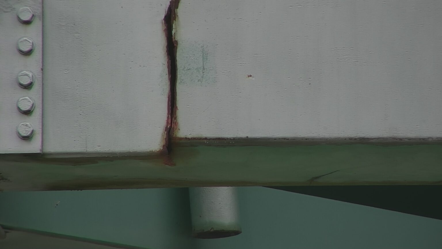

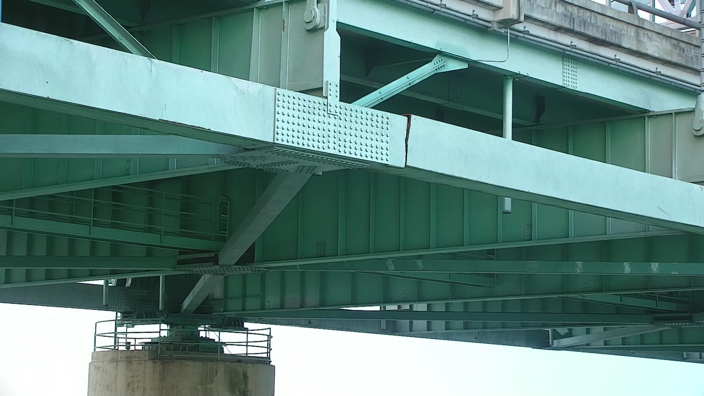

In the left picture, is that a mark from tape that was on there AFTER the crack moved? If so, that looks quite old.

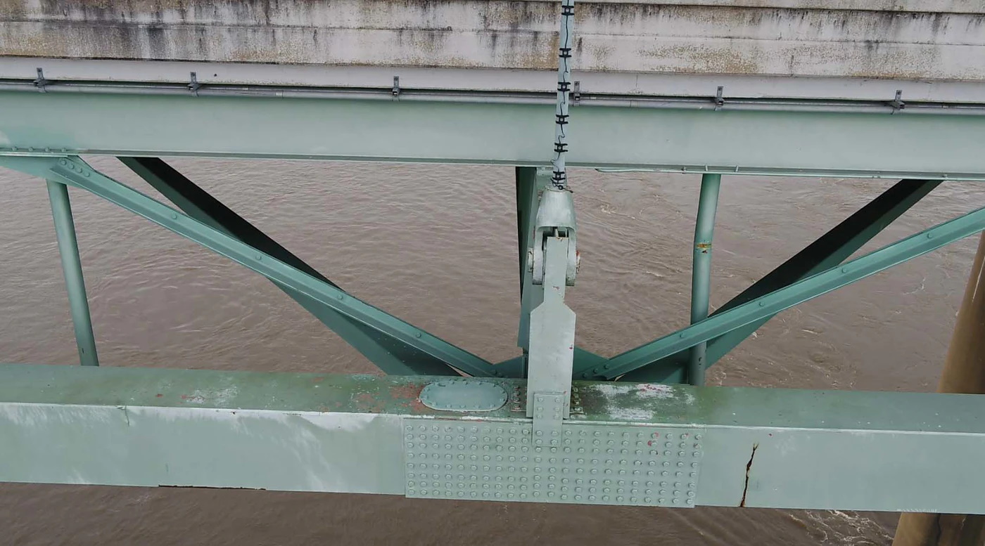

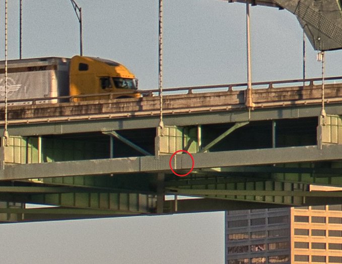

A twitter person took this photo in July 2019.
Attachment 39562
The bridge was inspected in Aug 2019.
The yellow truck is westbound.
Attachment 39563
The right photo looks like it cracked on a weld. It's so straight (the 'crack'), and the edge looks like weld failure of insufficient penetration. Like they tried to weld it from the outside and inside, and hid it all with grinding it off then painting with primer at the fab shop.
It would be interesting if the supplier supplied a welded beam and not a solid beam as speced.
Of course the question is if this beam has a problem what about the other thousand making up the rest of the bridge.
Shows what might happen when you go for the lowest bidder.
All speculations of course.

The Arkansas DOT released this photo from drone footage taken in 2019 of the cracked beam on the Hernando de Soto Bridge in Memphis. The ARDOT leader of the inspection team has been fired for missing the crack during reviews of 2019 and 2020 inspection reports.
Source: Arkansas DOT
Attachment 39571
The Drone footage shows the obvious crack, the inspector general was fired because he did not even look at the drone footage or take a walk.
