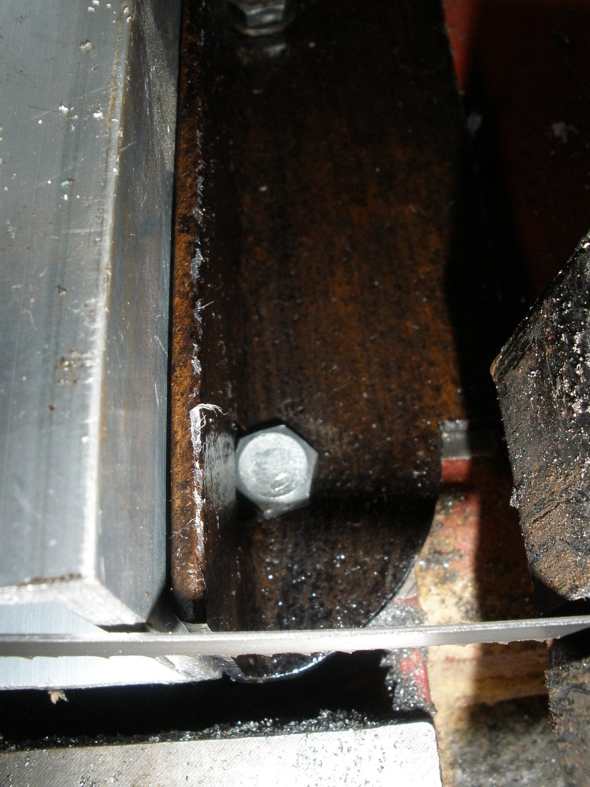

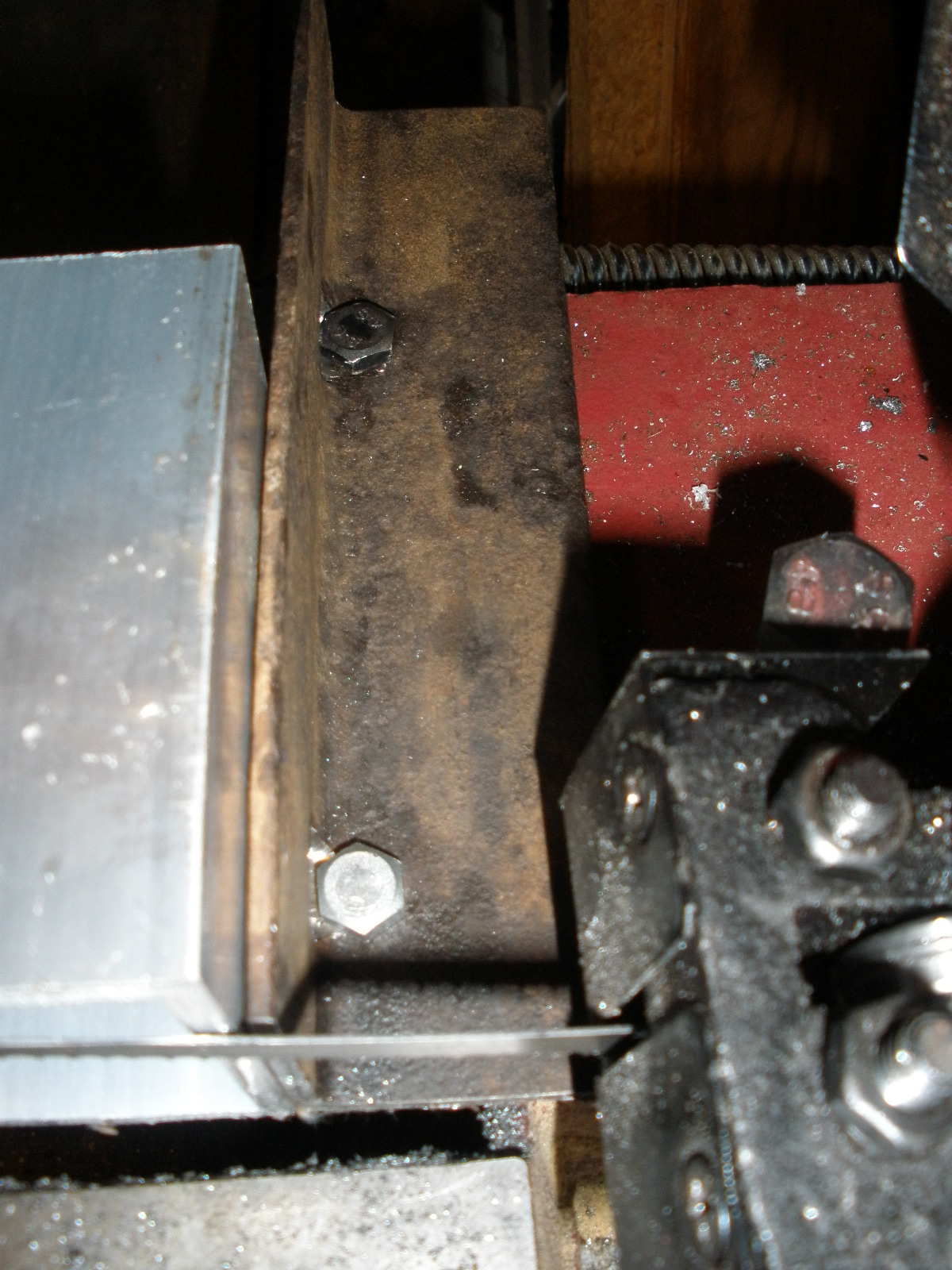

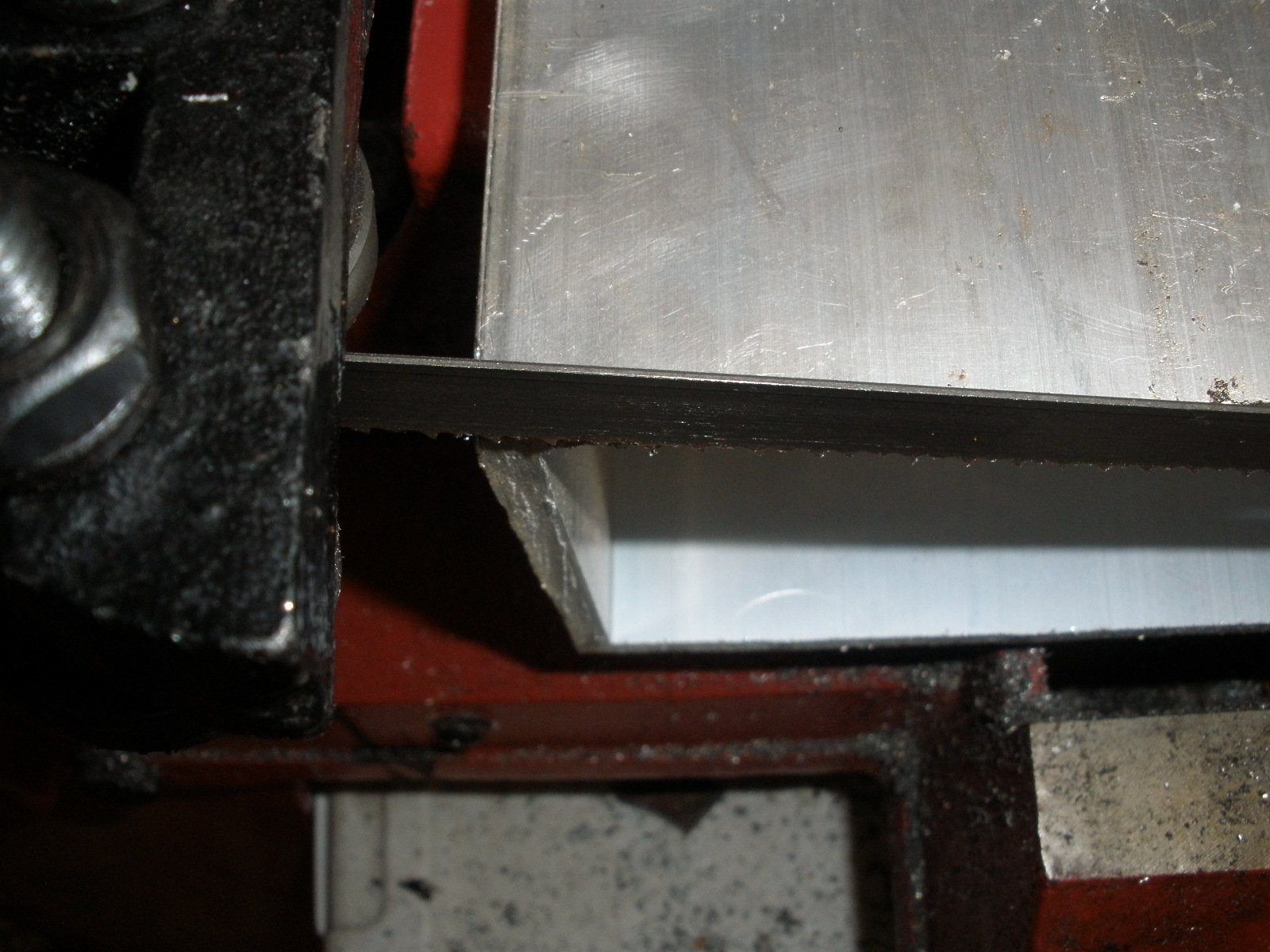

HF Bandsaw fix so it can actually take 6" wide material
The time: round a decade ago.
The place: California.
The mission: Build custom lighting controls for a famous traveling circus from Canada.
The panic: The 3" x 6" aluminum tube I need to cut a bunch of pieces of won't fit in my ^%$%#! 4x6 bandsaw!
The solution: Replace one jaw of the saw to allow larger items in. Pictures follow.
Attachment 34117
Attachment 34118
I made it closer to the blade while I was at it so now I can cut short pieces. The jaw is just angle from my scrap bin.

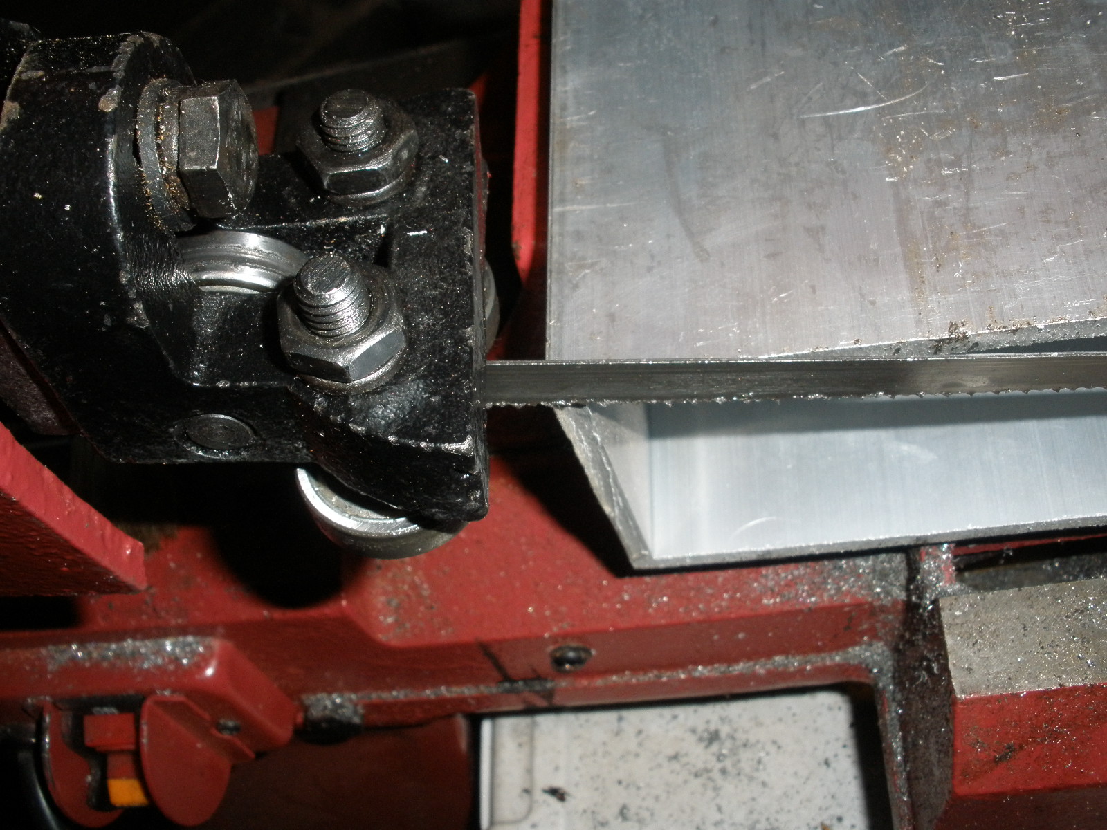

Attachment 34122
Attachment 34121

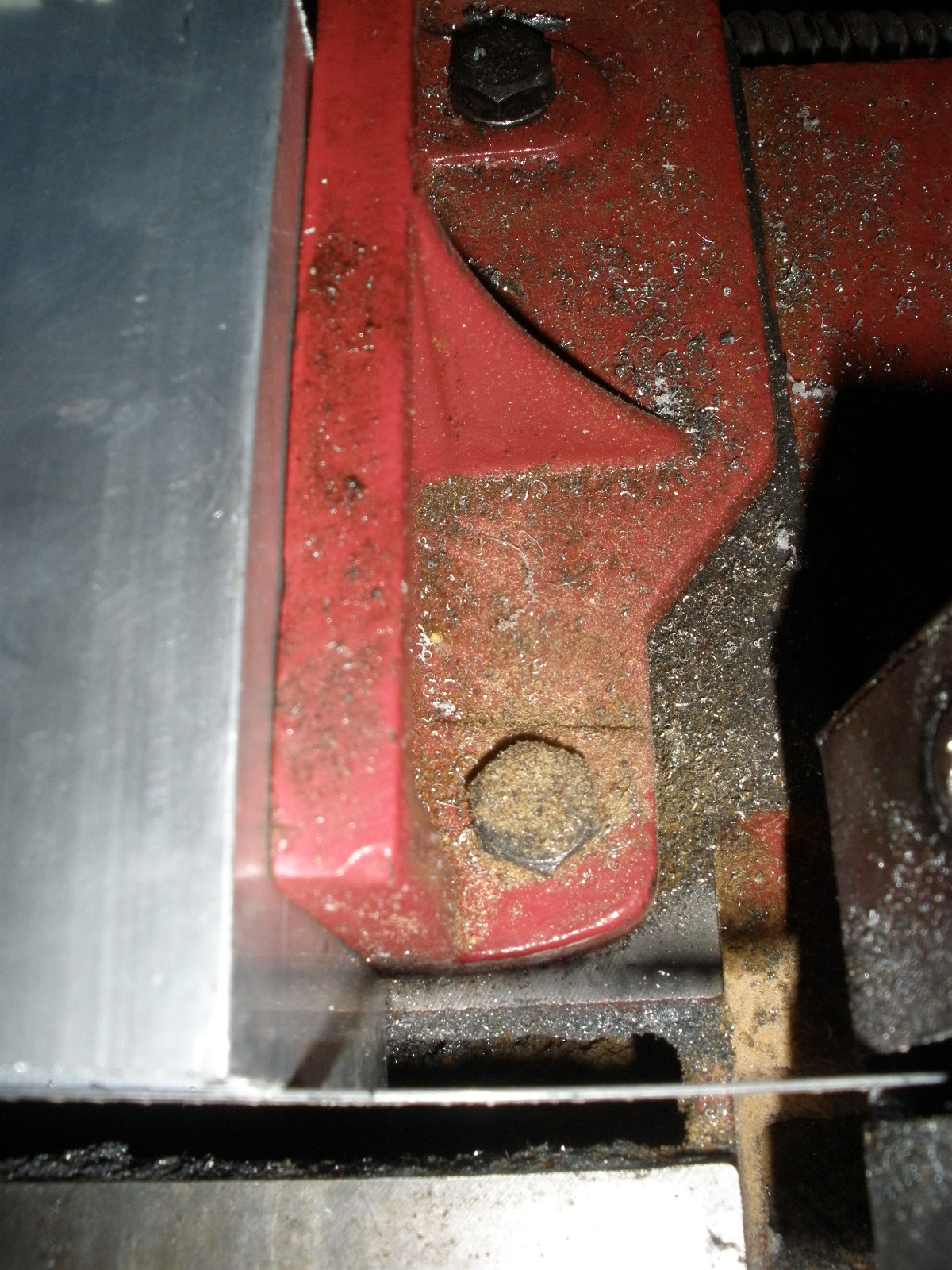

Rounded corner
Attachment 34120

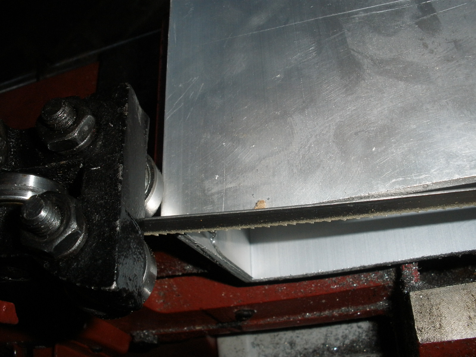

Done
Attachment 34119
