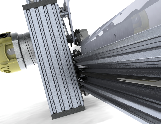

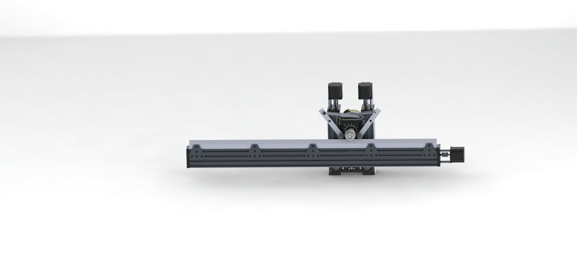

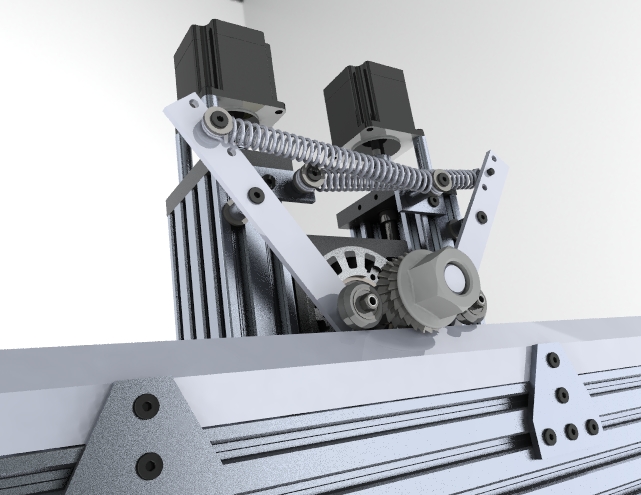

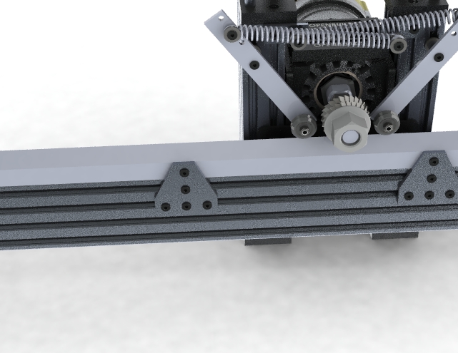

I am in the project of making a bamboo rod CNC mill.
Basically the machine is quite simple : it is a rotary 60degrees mill cutter cuting the bamboo rod in a perfect isosceles triangle.
The cnc will work on 2 axis :
- one axis will carry the bamboo rod on a X axis
- One axis will carry the spindle up and down on a Z axis.
The goal is to be able to control the size of the triangle shape rod.
I have used the V-Slots technologies from openbuilds.
Please find already some pictures the project that I have done. Don't hesitate to share with me your feedbacks.
