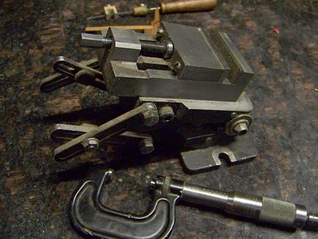

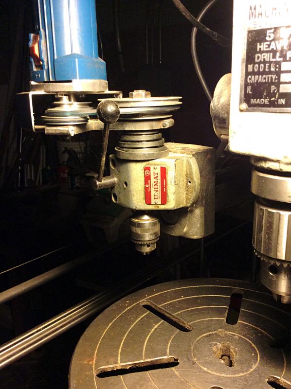

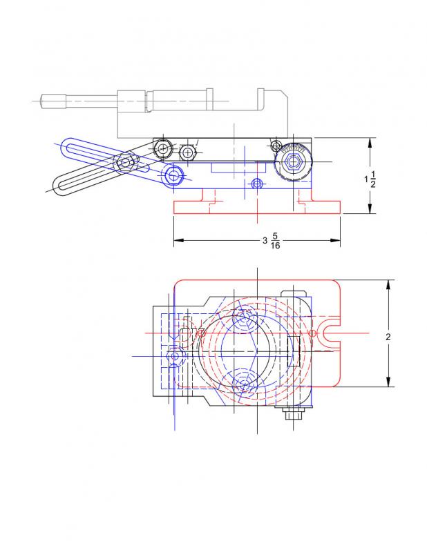

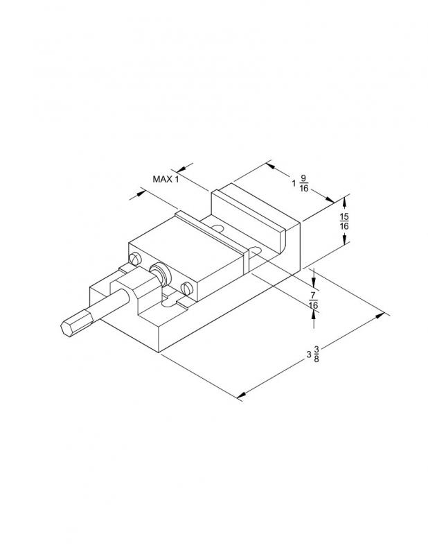

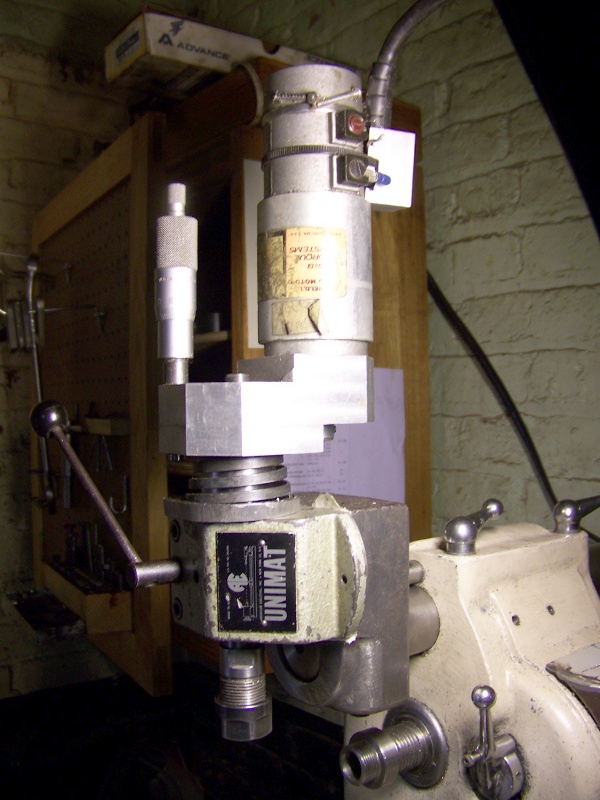

3 Attachment(s)
Thanks!
The Unimat headstock makes a nice small drill press, especially with a bigger motor but I had to change the way that mounted so wouldn’t interfere with anything. I bought an extra headstock so I can leave this one attached and just transfer the quill, but the headstock casting attaches to the adapter using the standard draw in bolt.
The toolmakers vise is a lot smaller than some of the originals in old Brown & Sharpe catalogs but handy for things I make. It takes the same 1/4” hex handle as my other one.
Attachment 22956Attachment 22954Attachment 22955

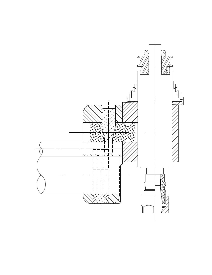

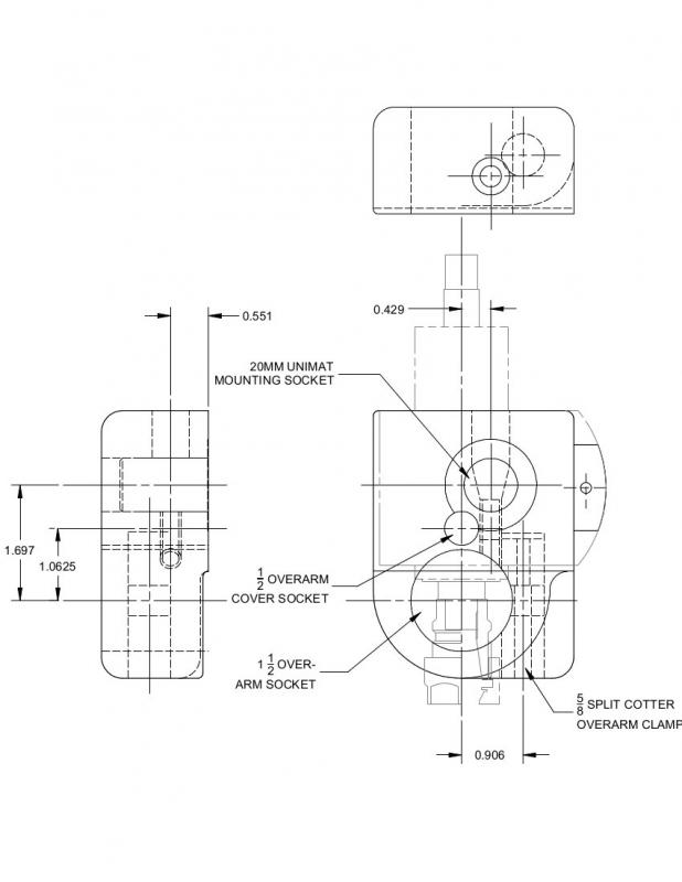

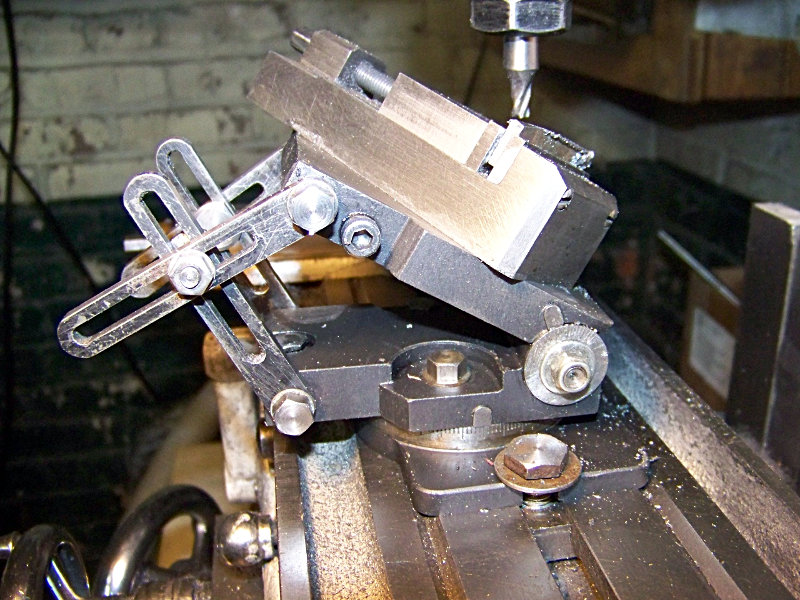

2 Attachment(s)
2 Attachment(s)
Here you can see why I made the adapter so it puts the Unimat headstock backwards, which then meant I had to make a new spring cup.
I tried to follow the example of the Unimat by reducing the number of tools needed while setting up the vise.
Attachment 22994Attachment 22995
An interesting adaptation. What is the machine it is mounted on?
Hi, Dick.,
Thanks.
Both are on my Atlas horizontal mill in the last pictures. The Unimat adapter clamps onto the overarm, and the smaller rod above that fits mounting hole for the overarm cover and helps getting it closer in alignment.
I drilled a similar hole in the right angle adapter for it that clamps on the column of the 14” bench drill press.
