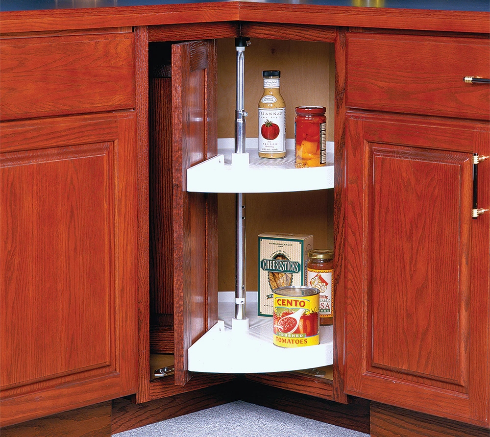

    In the houses we built the corners always had a Lazy Susan with an "L" shaped door. In our current house the dishwasher would be to the left of the corner and the stove to the right. The thing we liked is the cabinet door is fixed to the Lazy Susan so there are no odd swinging doors to bang on the surrounding cabinets or appliances. It's practically invisible, just a 1/16" gap all the way around. Massive storage, no damage and easy to access.

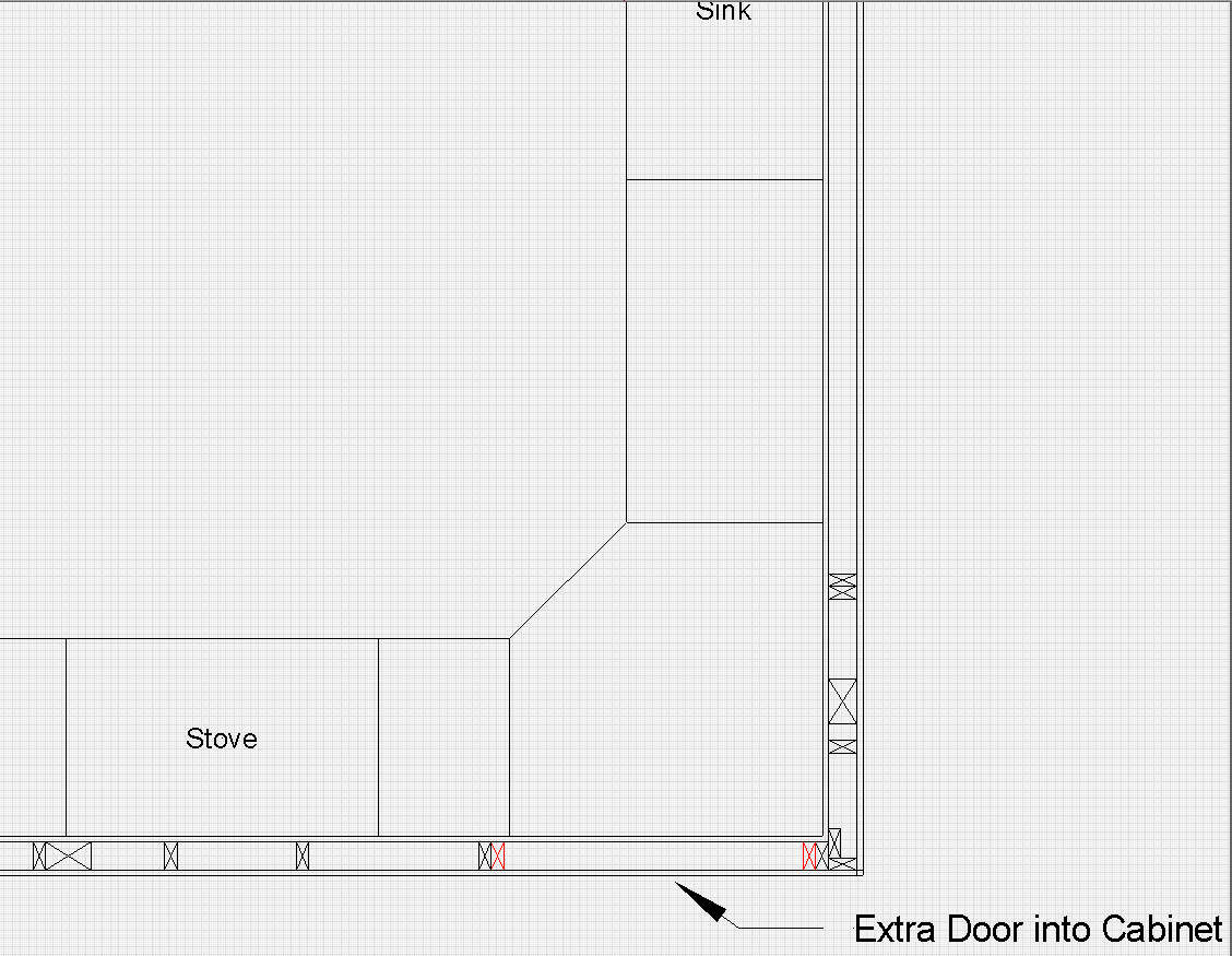

    We had a different take on that corner space. We had access to the back side of the space with a door in the wall behind the cabinet.
    My wife wanted to store various appliances there, hated lazy susans, and the door on the back side made the whole space usable. Have to have a wall behind the cabinet with a hallway to do this, but it works great.
