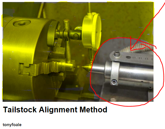

It is brilliant when people post pics, quite often one finds little hidden gems that the author is so used to that he never even mentions it and therefore never take the credit for it.
this pic was to show how to align your tail stock, hidden in there was an easy way to know haw far your tail stck spindle is out.
Thanks for this one Tony.
Attachment 21529
this will be much quicker than counting the turns on the tailstock wheel. :hattip:
