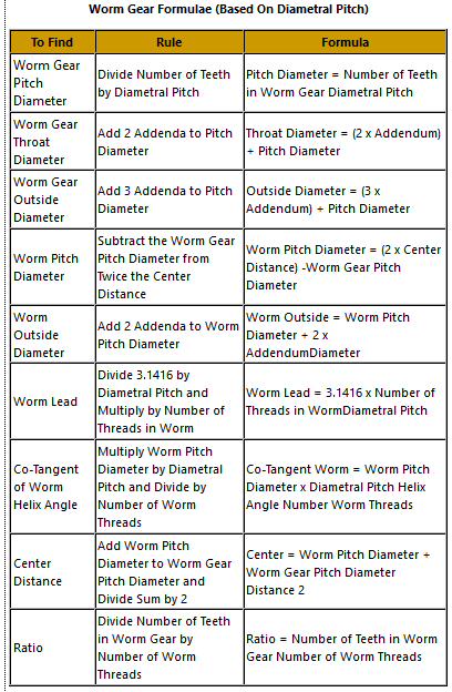

Need to know diameter of worm wheel for the following numbers of teeth: 30, 32, 36, 40
for worm dia 24 mm x metric trapezoidal thread TR3
Even have plenty round bars of phosphorus bronze in various diameters wouldn't like
to use hit and miss approach.
