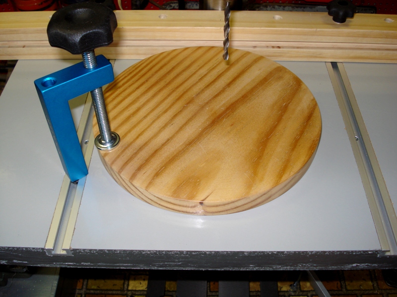

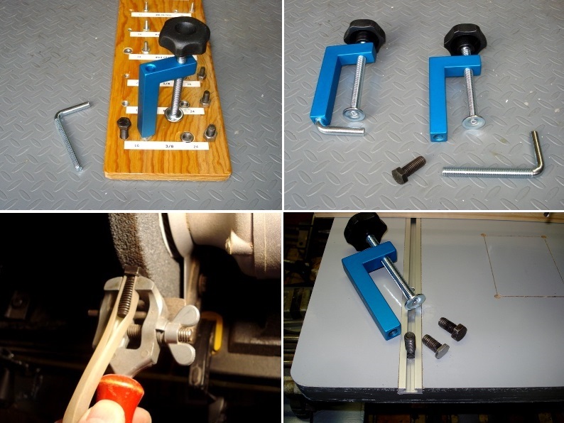

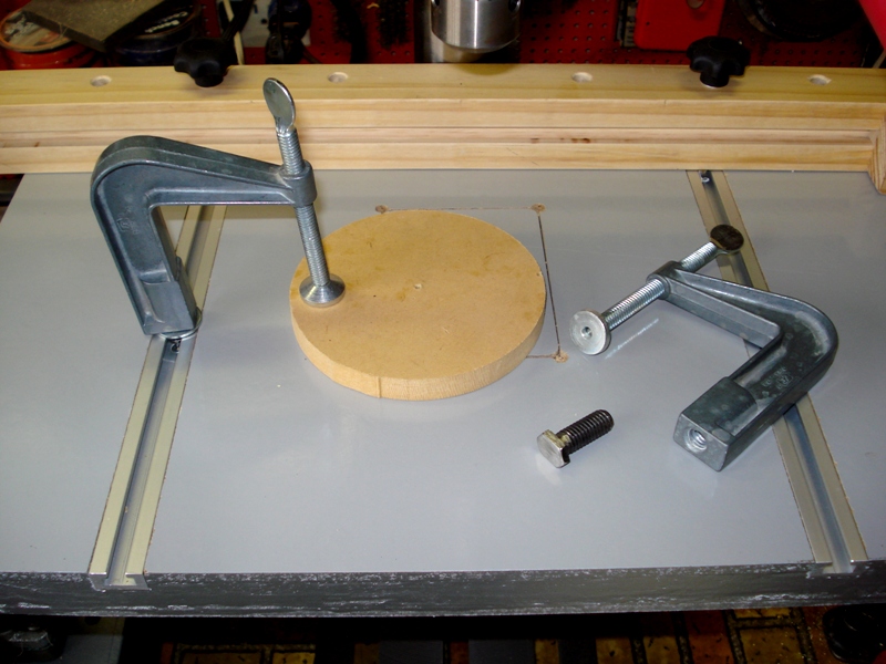

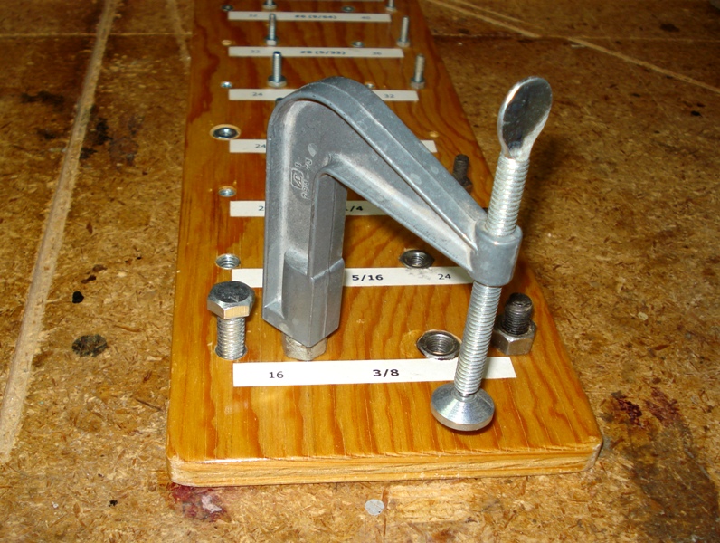

Besides fixing devices previously showed in the post http://www.homemadetools.net/forum/d...ss-table-51244, here I share two more:
By changing the “L” shaped arm of a “universal fence clamp” with a 3/8” bolt (16 TPI), grinded to fit and run into the T-tracks, you get a hold down clamp with which you can securely hold a work piece, against the table.
Attachment 13905
Attachment 13906

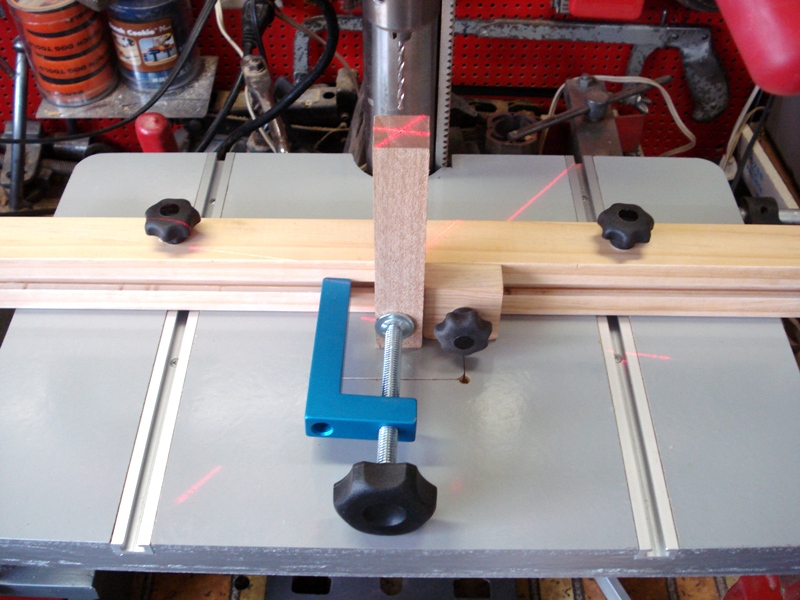

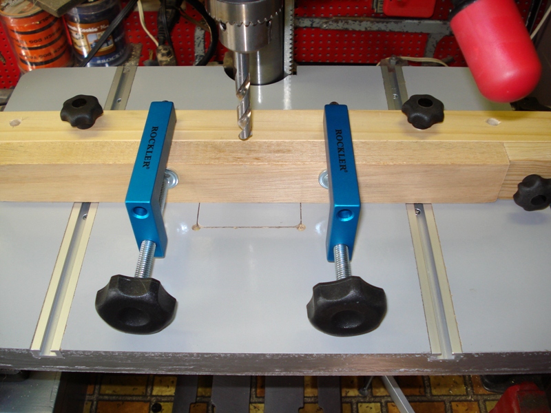

By drilling some 11/32” holes on the fence, you can use, as intended, the universal fence clamps to hold a work piece, against the fence.
Attachment 13907
Attachment 13908
