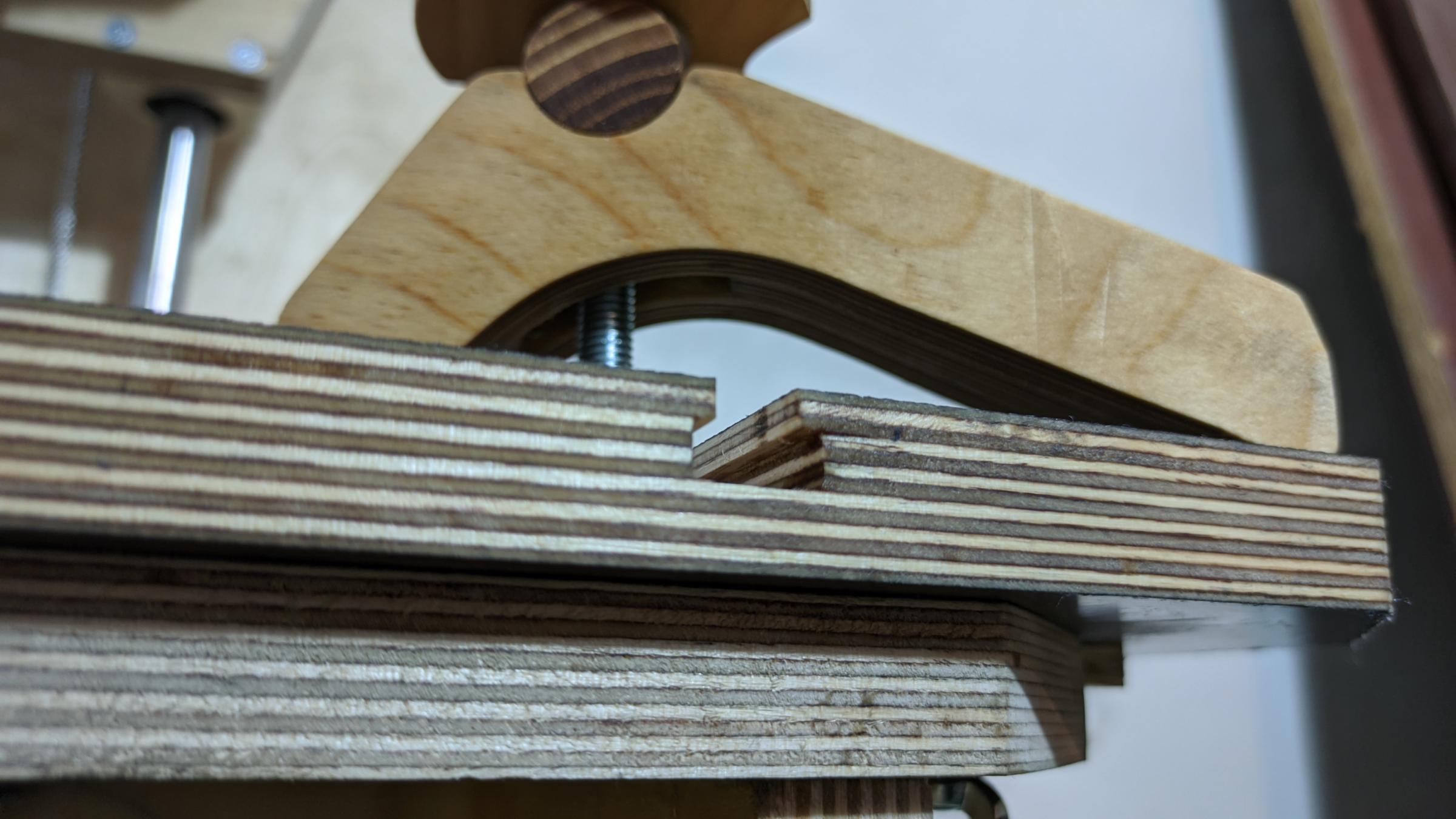

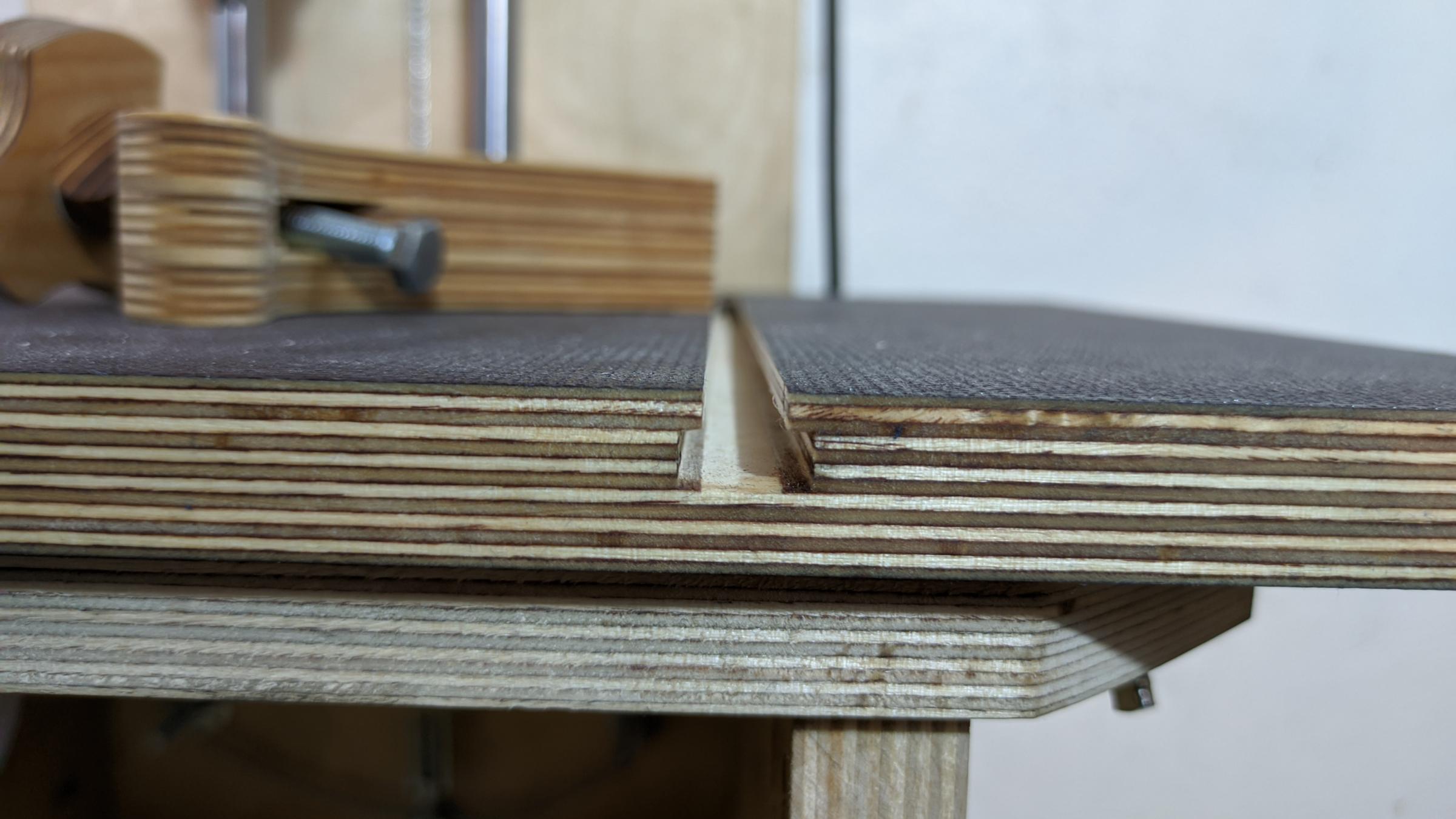

Today i will show you how to make a Hold Down Clamps for woodworking
https://youtu.be/ZXIPJDy8d-s
Free PDF templates - https://mazaydiy.com/plans/t-track-hold-down-clamps.pdf
T-track clamps for CNC, drill press, table saw:
Attachment 36938 Attachment 36939
Personally I like more T-shaped heads, less digging into the sides of the slot and possible spinning or jamming. Of course of you have a mill they're easy, but in a hurry I've taken a few pieces of brass strap, cut into appropriate length, and drilled/tapped holds in it.
