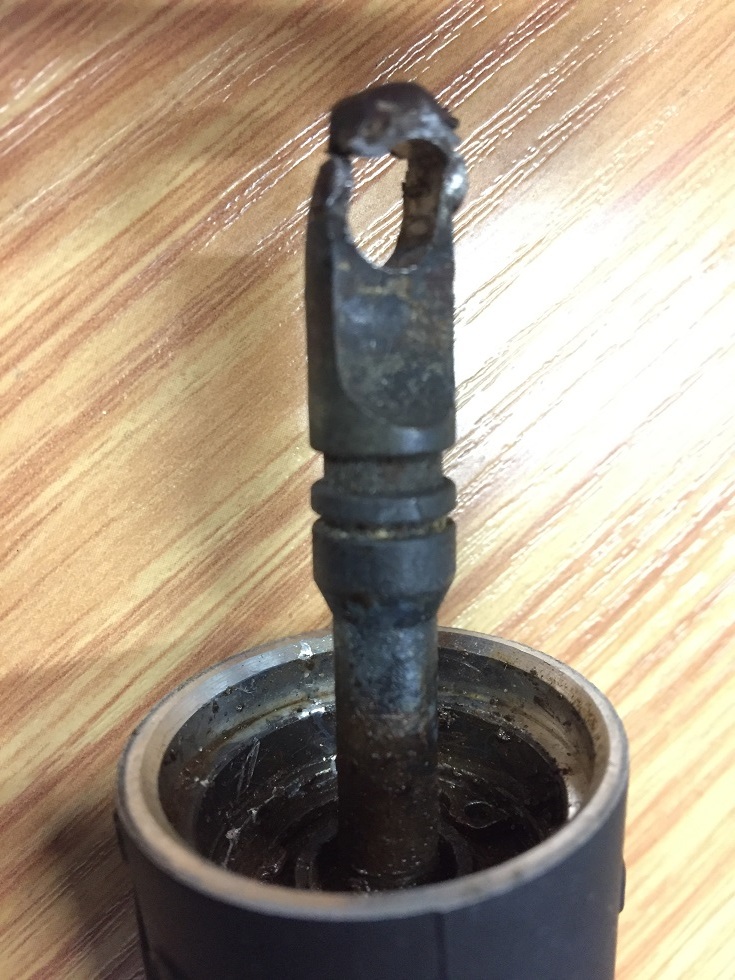

I have to try and repair my friend's HD front brake master cylinder push rod the week end.
Attachment 24845
Was wanting to turn the damaged part down and tread the shaft and screw the replacement part on. Easier to repair in the future.
As you know there is a ball shape in the cylinder. Any ideas as the front is nor thicker than the shaft??
