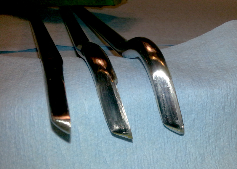

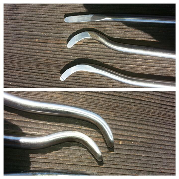

This was another project for my Woodworking Guru friend which took me down many paths and taxed my skill levels and tiny shop pretty good. He wanted a set of 3, 3/8" hollower to match his 1/4" set of Keltons which are quite nice tools made in New Zealand. His weighted handle is double ended and accepts 1/4" (6mm) and 3/8" (10mm) tools. As I know less than a little about these I asked him to borrow the set for a couple of days to figure out what I needed to do to build them from 3/8" O1. Here is a picture of his 1/4" set. As you can see there is a shallow curve, a medium and an acute curve and the two latter are actually compound bends. We'll get to the relief angles later.

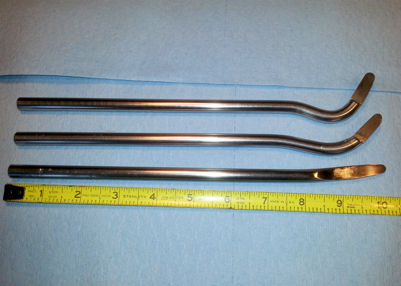

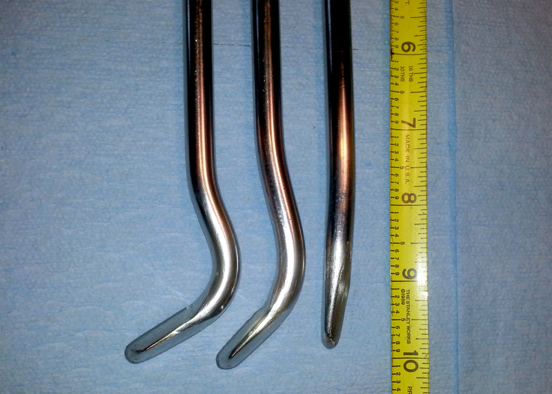

Basically I measured everything I could and actually made tracings of them in my engineering book. Also got the length specs from their website and scaled everything up to 3/8" including the radii. Upon close inspection I realized these actually have some (carbide probably) inset for the cutting edge.
The first one I bent in the vice because it was so shallow of a bend and then started grinding, sanding and filing the flat and relief angles of the head. Once I got that done and pretty much sharp, I heat treated it by heating it cherry red, soaking for as long as I could then quenched in oil. No "Tinks" and a file wouldn't touch it. Then tempered it in the oven twice for an hour each at 450ºF and come to room temp both times. It was very hard but have no way of knowing how hard it actually is but will say that I had to start with a more course diamond tool to get it going...guessing maybe 50ish on the RC scale for my little setup. Worked it down until I felt it was sharp enough. Gave it back to him to let him try it before I went any further. Results were spectacular according to him and a piece of Dry Pecan (hard as rocks I understand) he took it to task with.

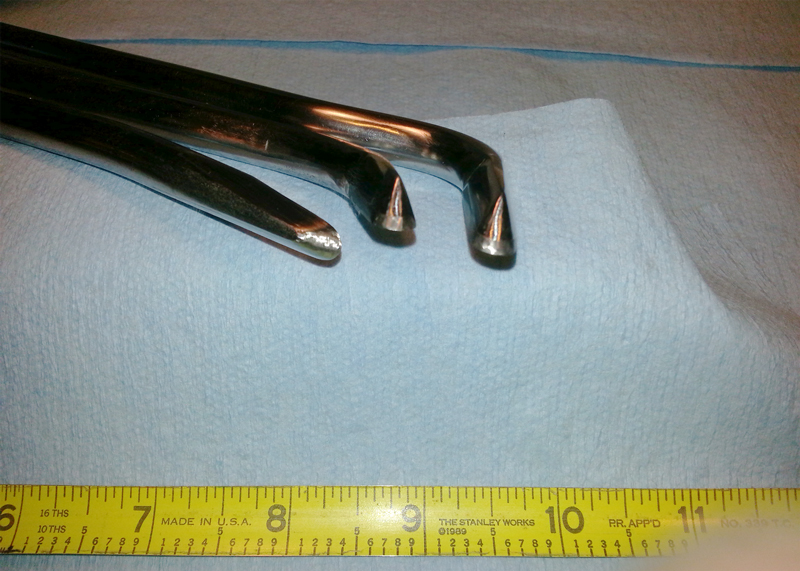

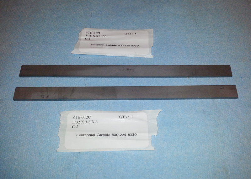

Now I had to figure out how to do those compound bends and that's when I whipped up the "Rod Bender, Cheap n' Cheerful" I posted earlier. I also wasn't convinced my heat treatment would hold up so I ordered up some C2 Carbide from a great source I found on line. Centennial Carbide is a great source with good prices and Nice folks which I felt would be a good share here. Here is what I got but they also have fine grain also.

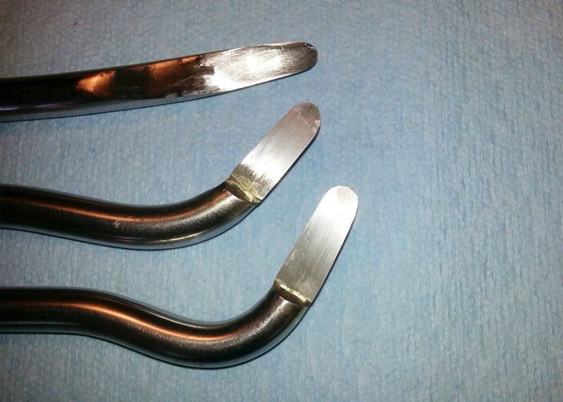

For the other two I pondered milling them in the lathe first like I did for my Scraping Tools but argued against it because I could mess up the milling when I bent it and wasn't all that sure how it would go or how much scrap I might make. So Off to Bending them and it actually went pretty well but did have to heat them several times and bend again then move the rollers a bit to get them to match the scaled tracing profiles but as you can see the bends came out pretty good in my estimation.
The basic profiling of the cutting area went pretty well but worked diligently to get them flat to get a good silver braze for the carbide. I thought I had a Dremel diamond wheel for the carbide but didn't so I ended up snapping the 1/16" off in the vice....not pretty but close enough to work. Silver soldered them and proceed to work the relief angles like I did the first one. This was tough because I couldn't work the carbide with my Silicone Carbide belts and ended up using my 120 grit diamond grinding wheel and a double sided lapping plate, 6" plate I made. I have 2, a 360 & a 600, then hand DMT's up to Extra fine (800-1000G). In some ways these were tougher to bring to edge and profile than sharpening my 27" Katana which has a convex profile and edge over a long run. because one little lack of concentration or slip with the diamond would cost me a half hour some times.
