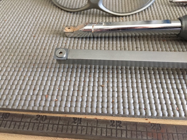

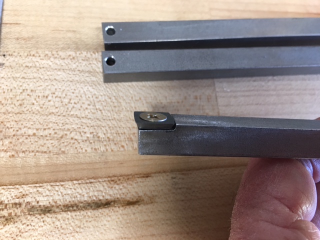

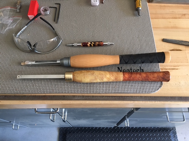

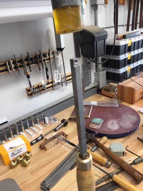

I set out to make a Carbide Wood Lathe Tool better than the one I purchased. Photo contains the purchased item on top and home made tool on bottom.

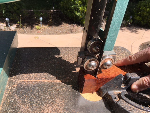

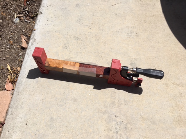

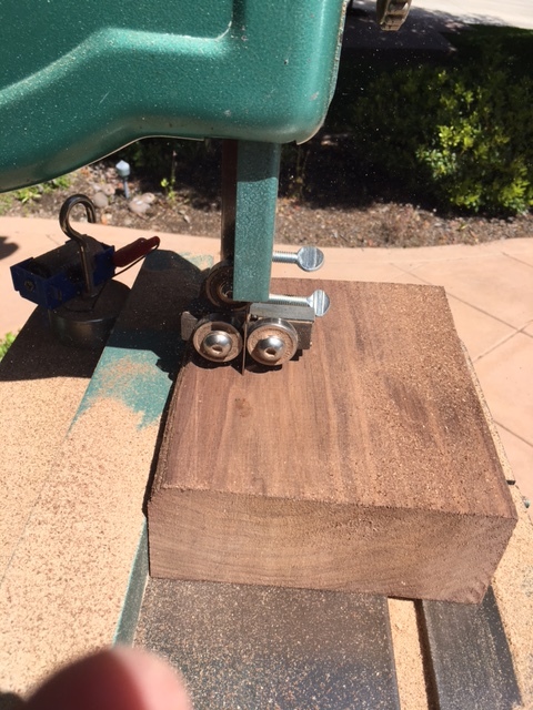

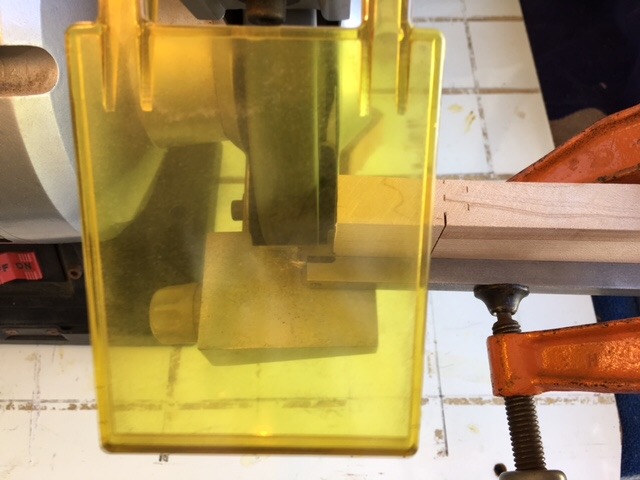

Cutting and Gluing Wood
Attachment 17657
Attachment 17658
Attachment 17659

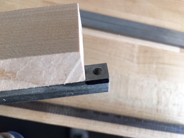

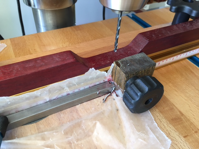

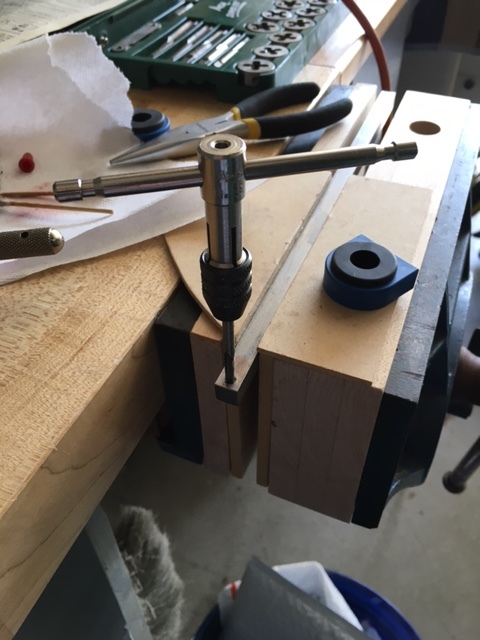

Drilling, Tapping and Grinding SS Bar
Attachment 17660
Attachment 17661
Attachment 17662
Attachment 17663
Attachment 17664

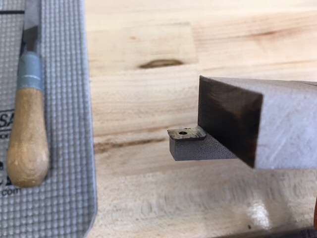

Attaching Carbide Insert
Attachment 17665

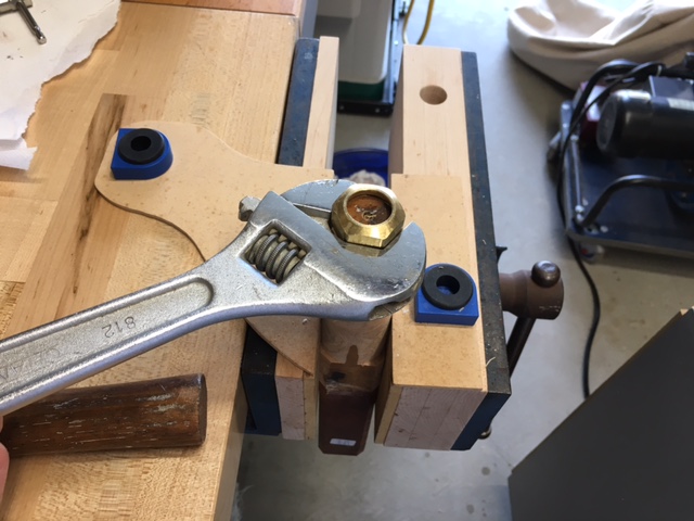

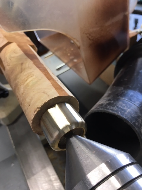

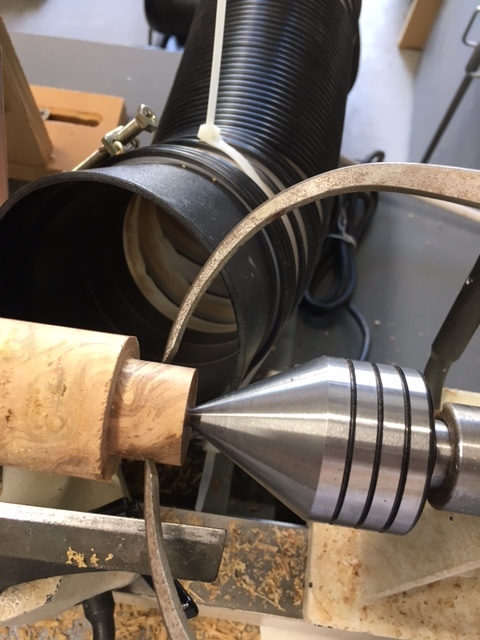

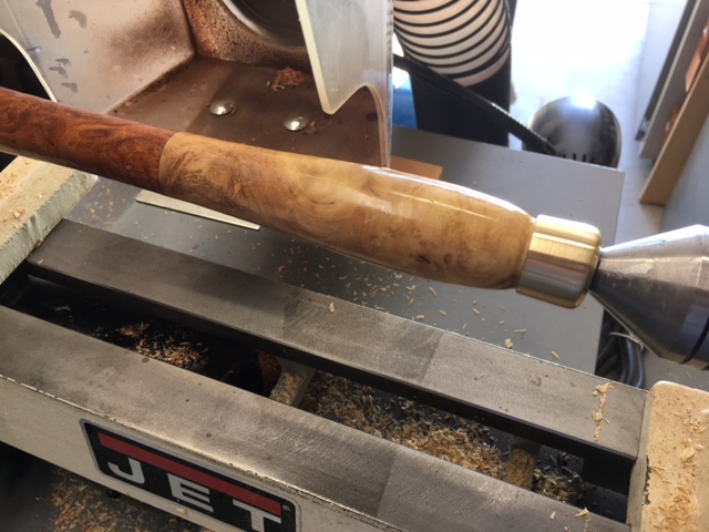

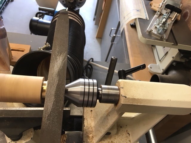

Turning Handle front for Brass Nut
Attachment 17666
Attachment 17667
Attachment 17668
Attachment 17669
Adding Finish to the Handle
Attachment 17670

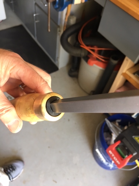

Inserting Shaft into Handle
Attachment 17671
Attachment 17672

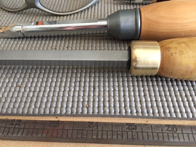

Completed Tool
Attachment 17673
Attachment 17675
