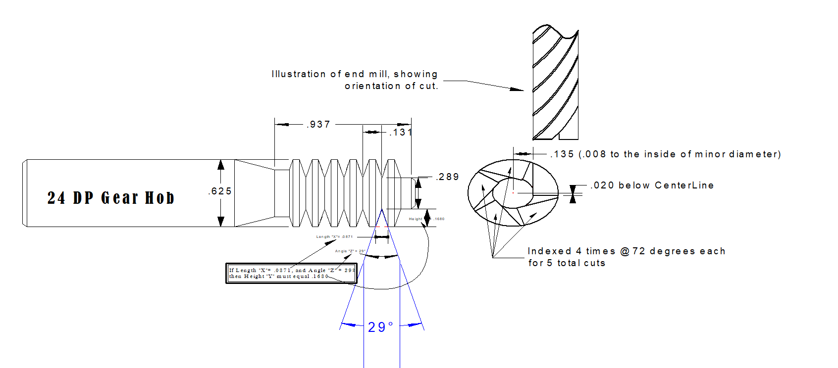

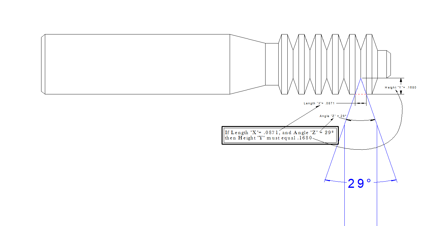

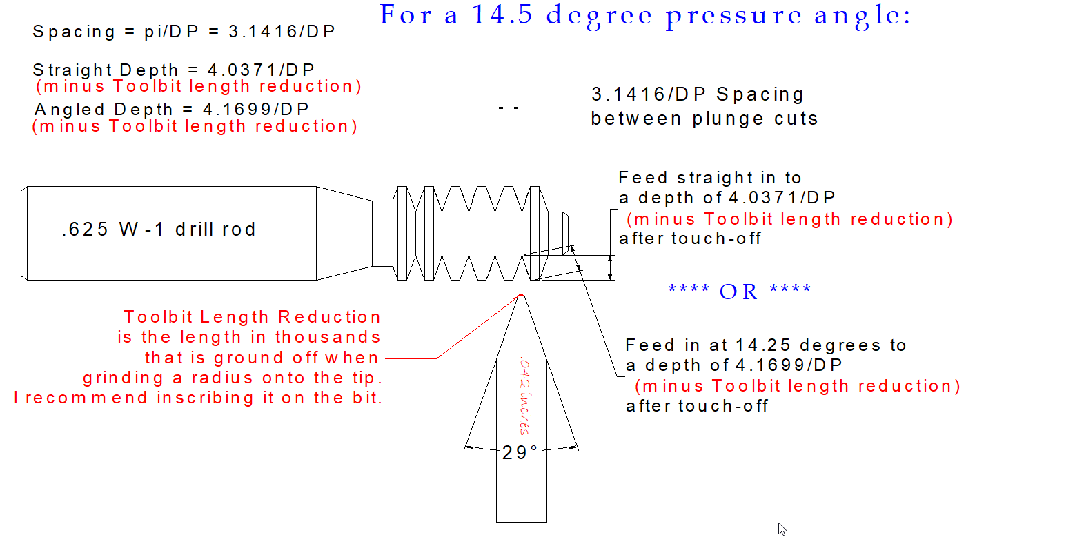

Shows the theory and process of creating a gearcutting hob
