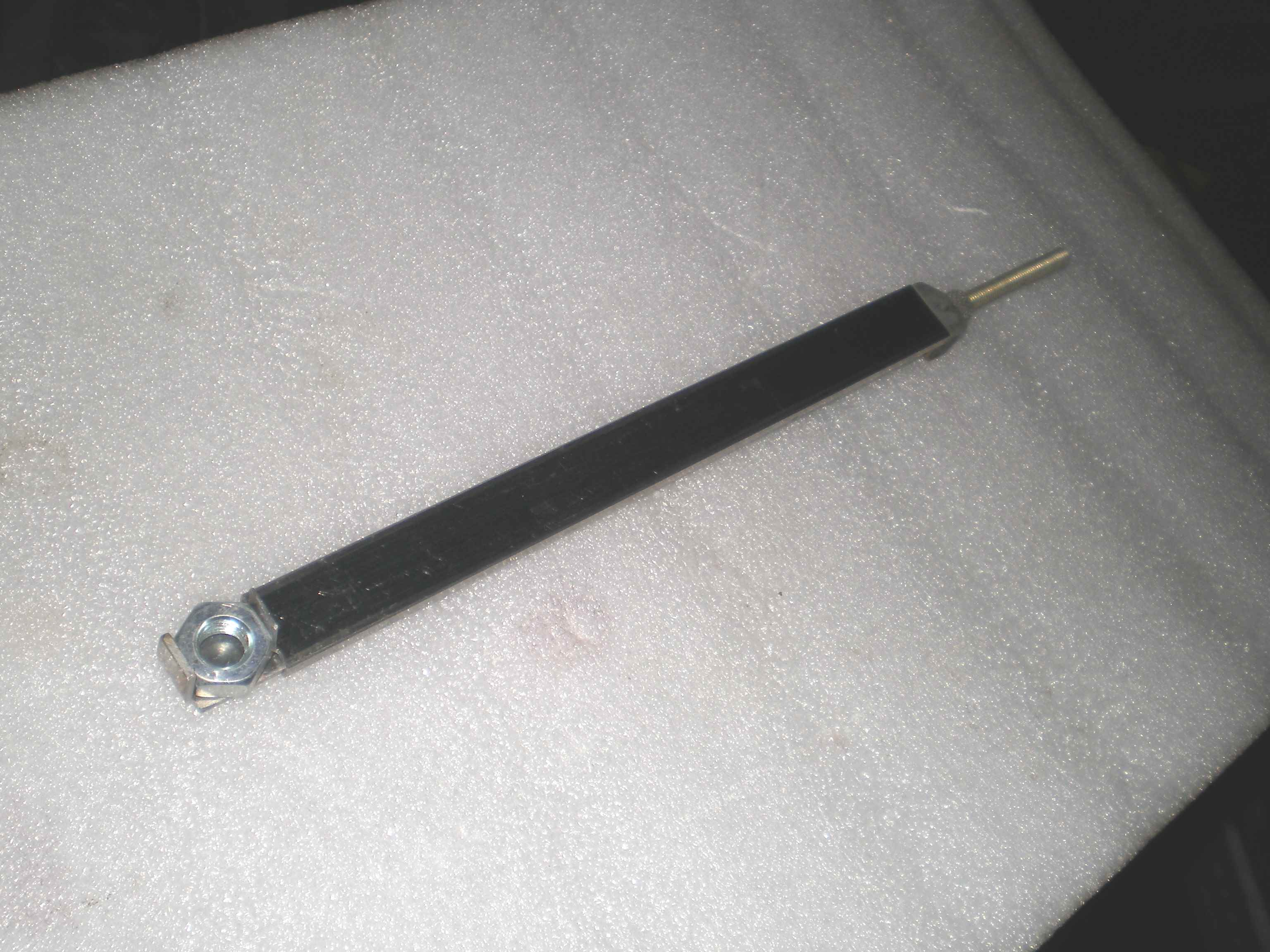

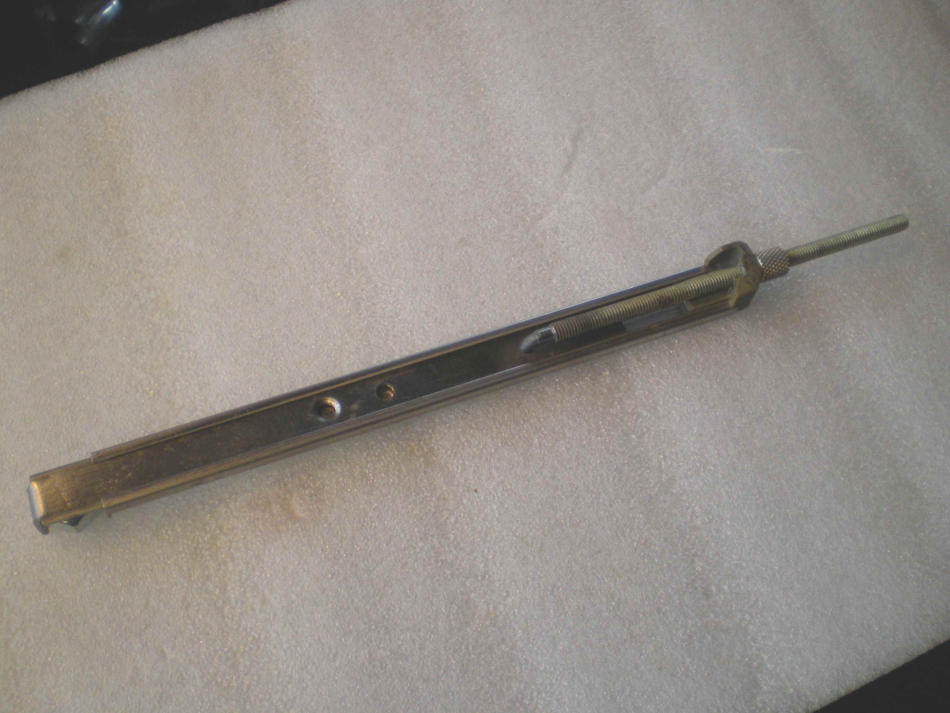

This is made almost entirely from an old uPVC window hinge and a piece of all thread.
Took about 1 hour to make, its not pretty but it works, cost me nothing and its only going to get chucked into my toolbox.

saw this the other day and said that has to go to the bottom of my todo list, then today I needed it for hold a nut to mount under my luggage rack that is close to the body on my buggy. would have saved cramped fingers. although a long nose vice grip plier would have worked but it was late and I was not thinking to good.
Pretty clever Marv, I like it

If you don't have carpet tape on hand, wind duct tape onto the stick with the sticky side outward. Keeping carpet tape around is a good idea though; I've machined small parts by attaching them to a faceplate with the stuff.
If carpet tape is too aggressive in the nut-holding scenario simply stick a magnet on the tape and hold the nut with the magnet.
Wooden paint stirrers, often given away at paint stores, can substitute for the yardstick if one only needs a shorter reach.
Great idea! Thanks for the share. I've used a piece of flat metal with a hobby magnet or a piece of wood with double sided tape.
Using yard sticks , paint stirs and soda straws with sticky tape is a great quick fix solution to a seldom encountered problem, that often times hardly warrants buying or making a more permanent tool.
