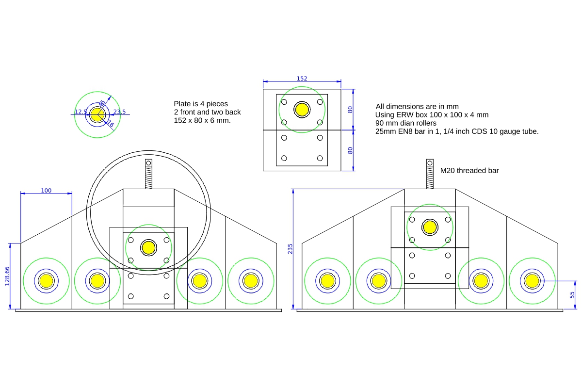

Made the mistake of pressing the request for plans after I saw that someone
had clicked it, thought the button may have suggested who wanted them?
At the beginning of the post I stated that I started these without any
drawings as basically I was using up what I had around the workshop.
But I did start to make CAD drawings of the unit, please bare in mind I am not
CAD proficient and I will try to add to this as, and when I can.
Adrian

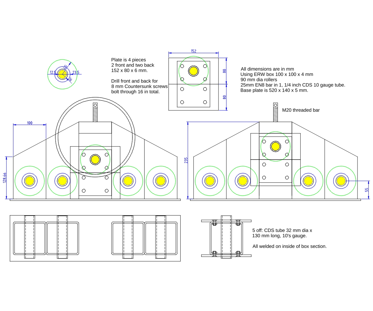

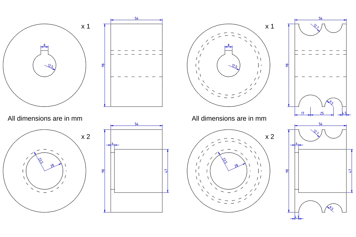

Looks like a few are asking for plans, well 7. Not sure what else I can add, so here are the rollers:-
Attachment 8829
Just amended the other drawing see here.
Attachment 8830
I will try to add more as I can.
If I am meant to do differently then add pictures to the post then please let me know.
Adrian

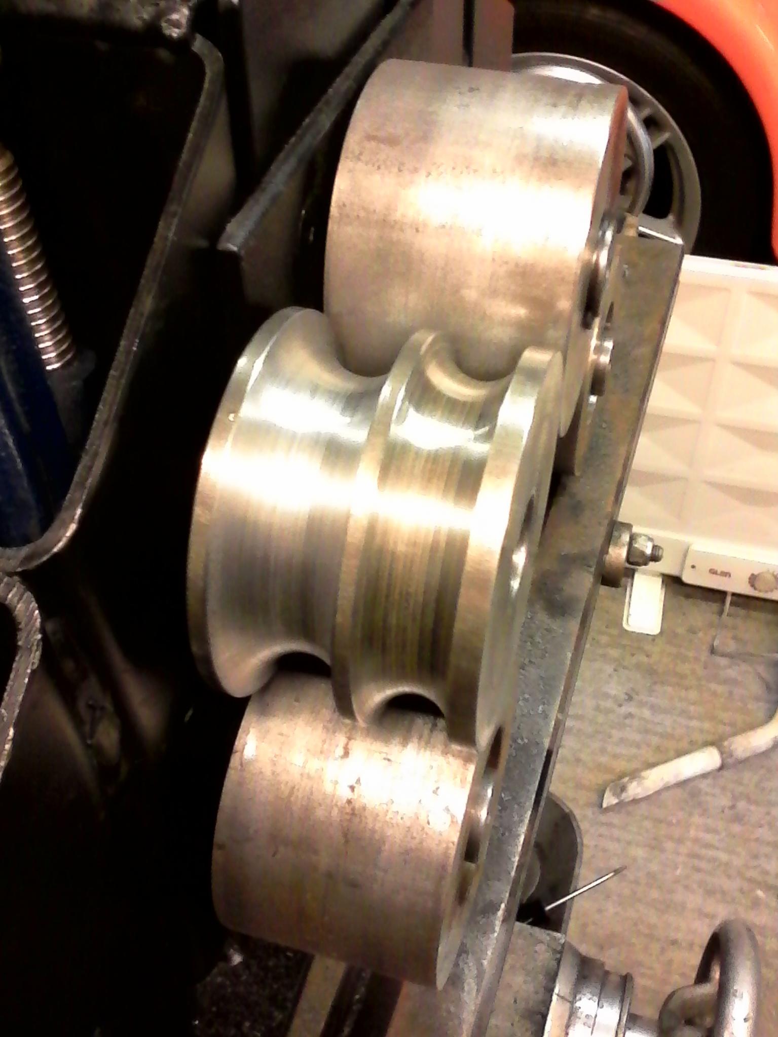

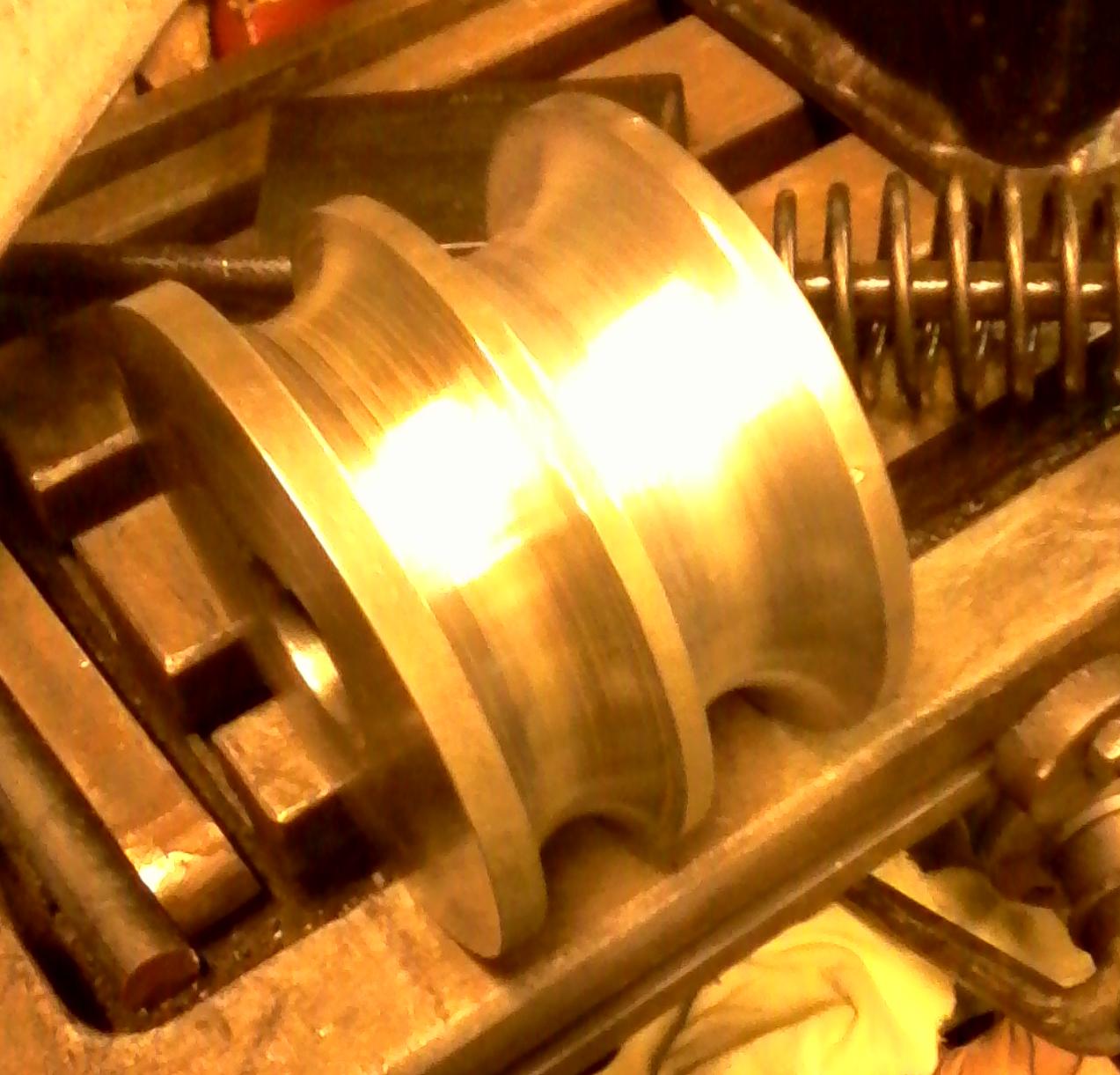

I cut the second groove in the roller for tube the other day, should now be able to roll inch tube as well as 3/4 inch. I either need to do the idle rollers or make some adjustable guides I have been promising myself.
Attachment 9047Attachment 9048
Adrian
