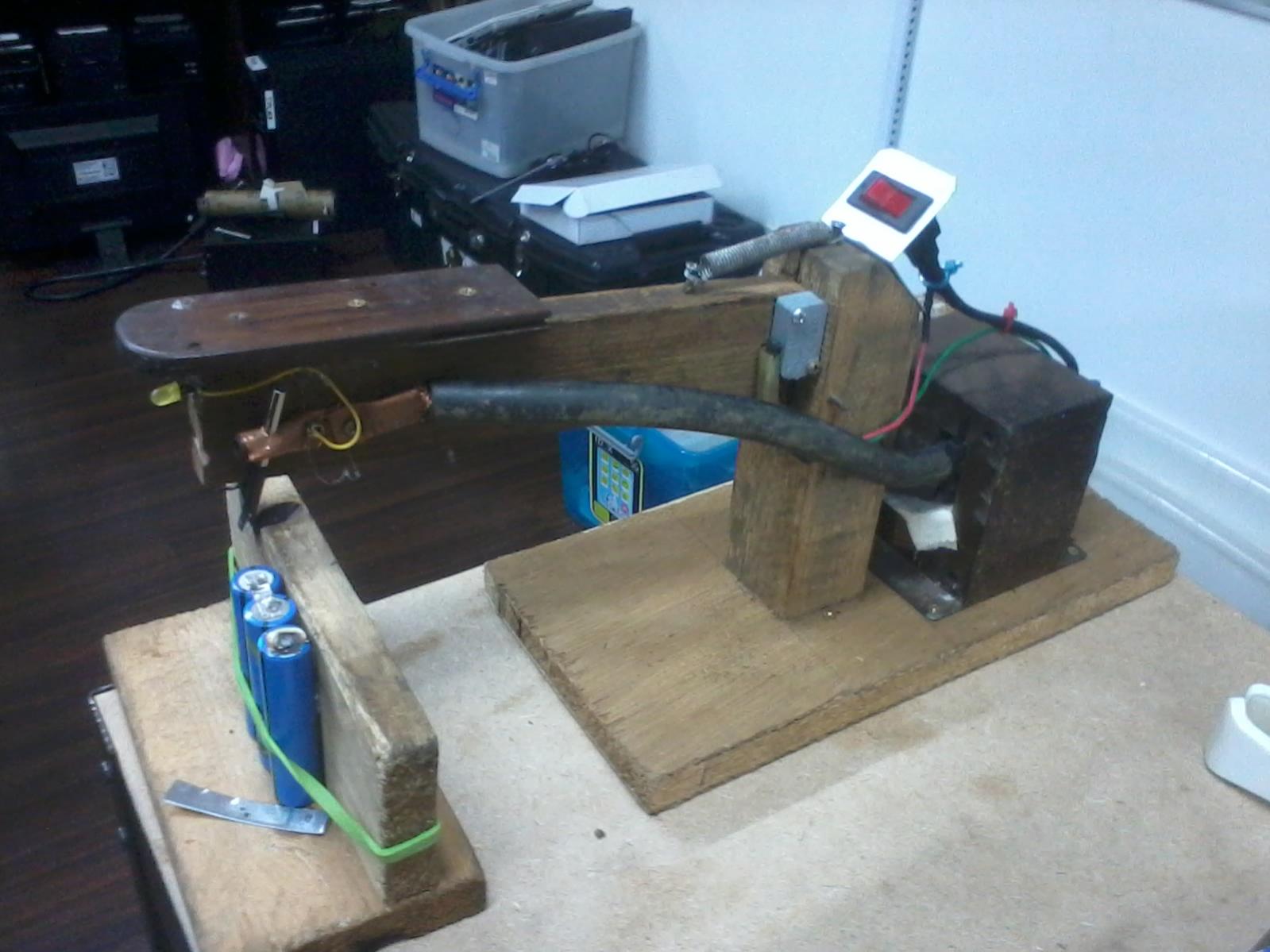

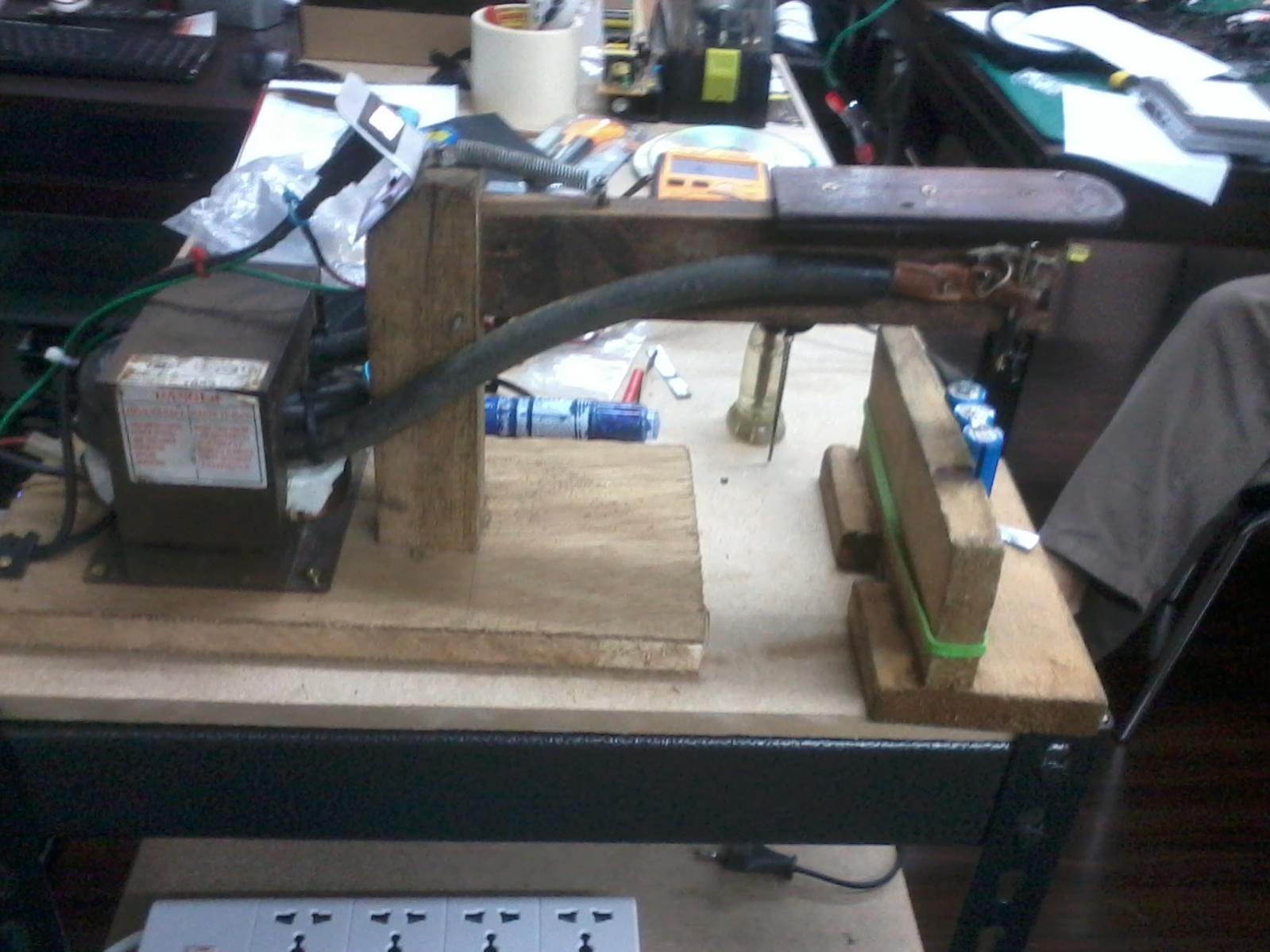

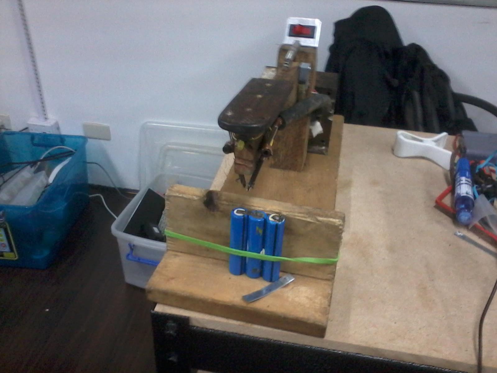

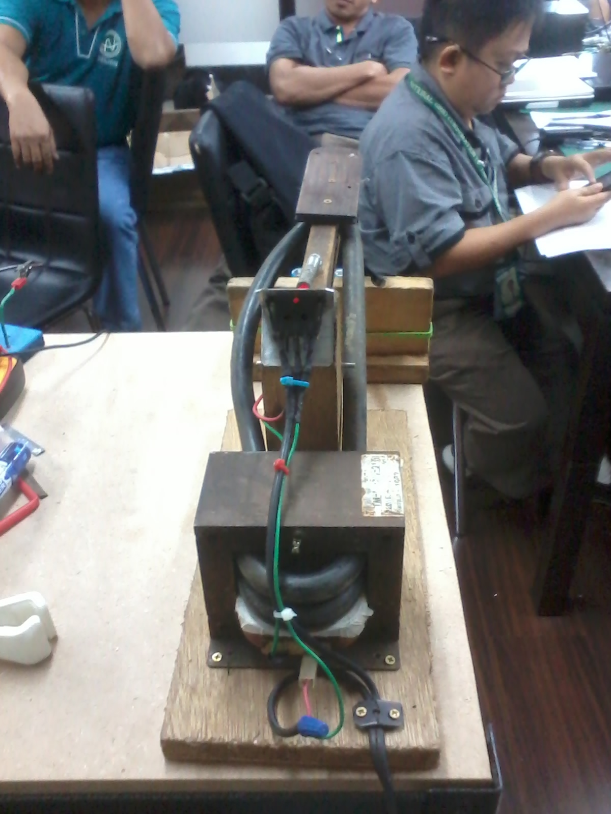

made this spot welder using one transformer from a microwave oven, just replace the secondary winding(high voltage side - very thin wires) with a few turns of welding cable wires.
