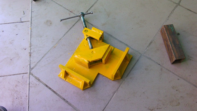

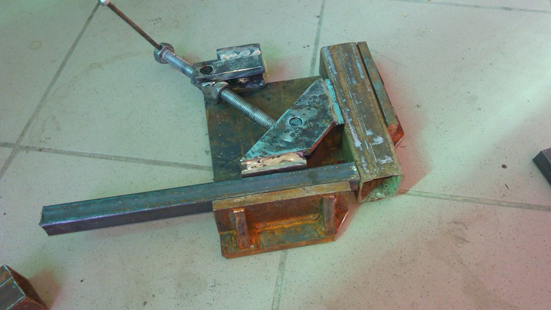

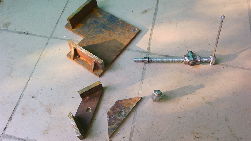

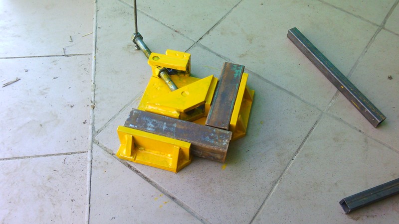

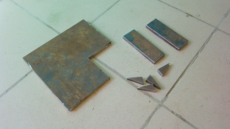

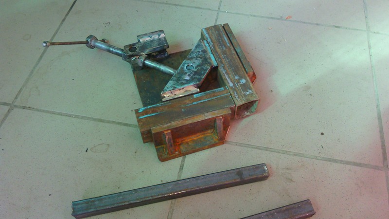

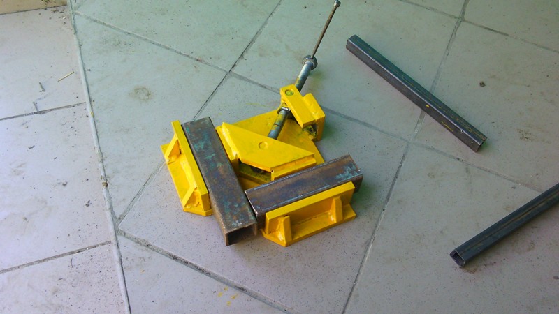

Homemade angle clamp made of sheet metal 10 mm
Nice design, I have not seen one before that can hold a mix of sizes of material, very useful for fabrication.

Another fine job. Well done. I particularly like your design that enables it to hold unmatched material sizes. I initially wondered why you bothered to pivot the clamp nut, but it was all revealed in the end.
