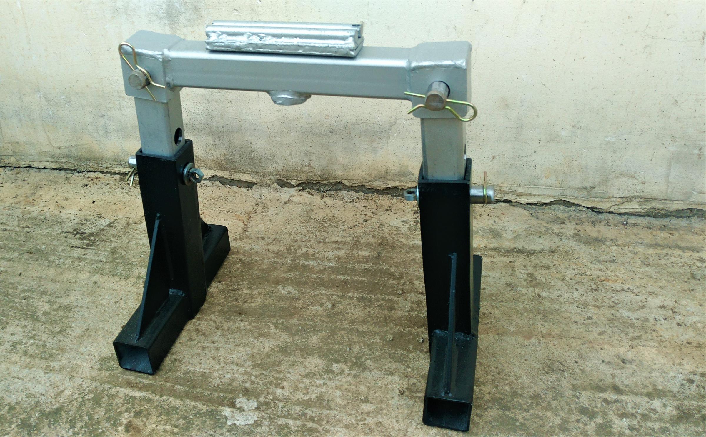

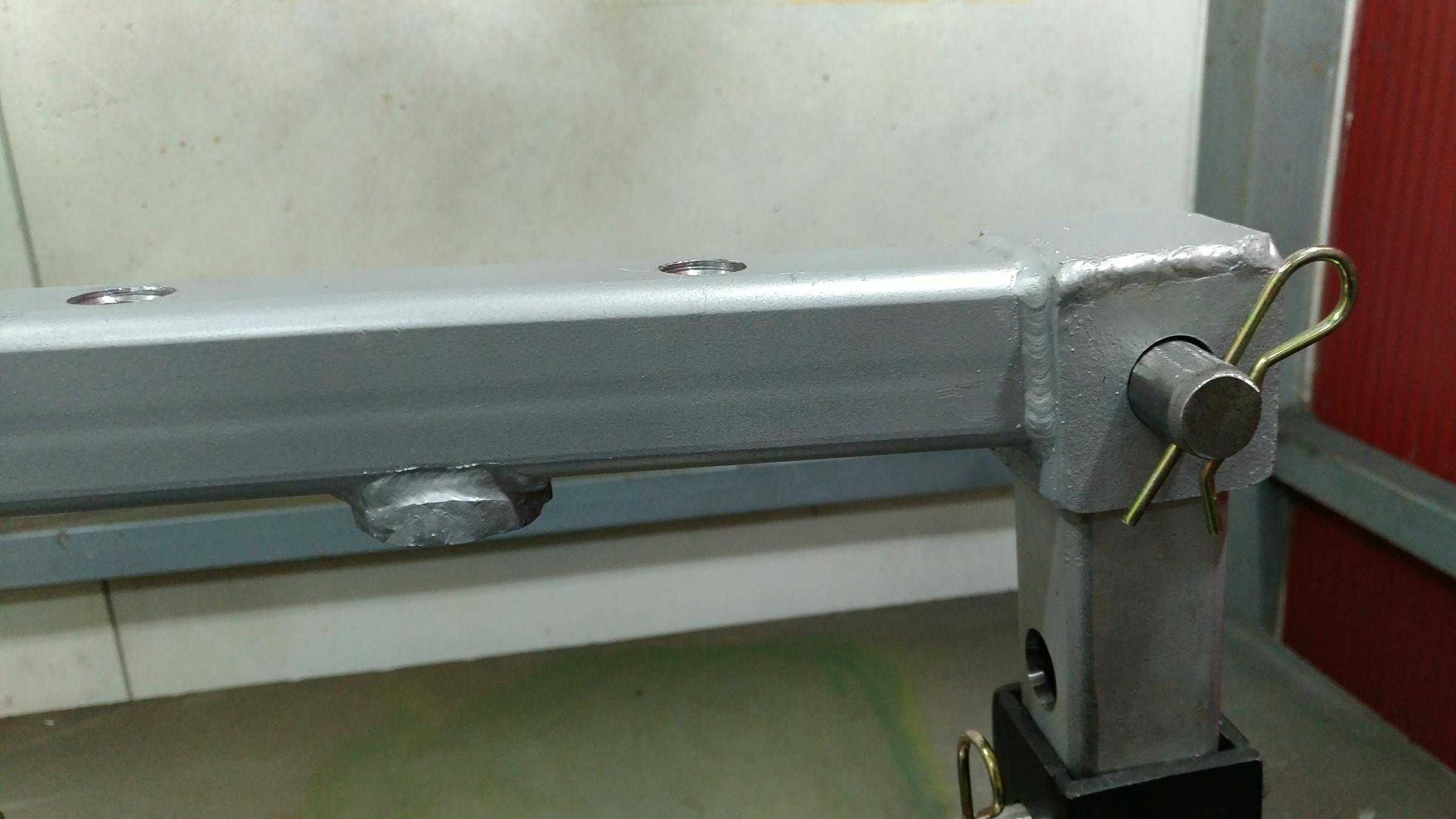

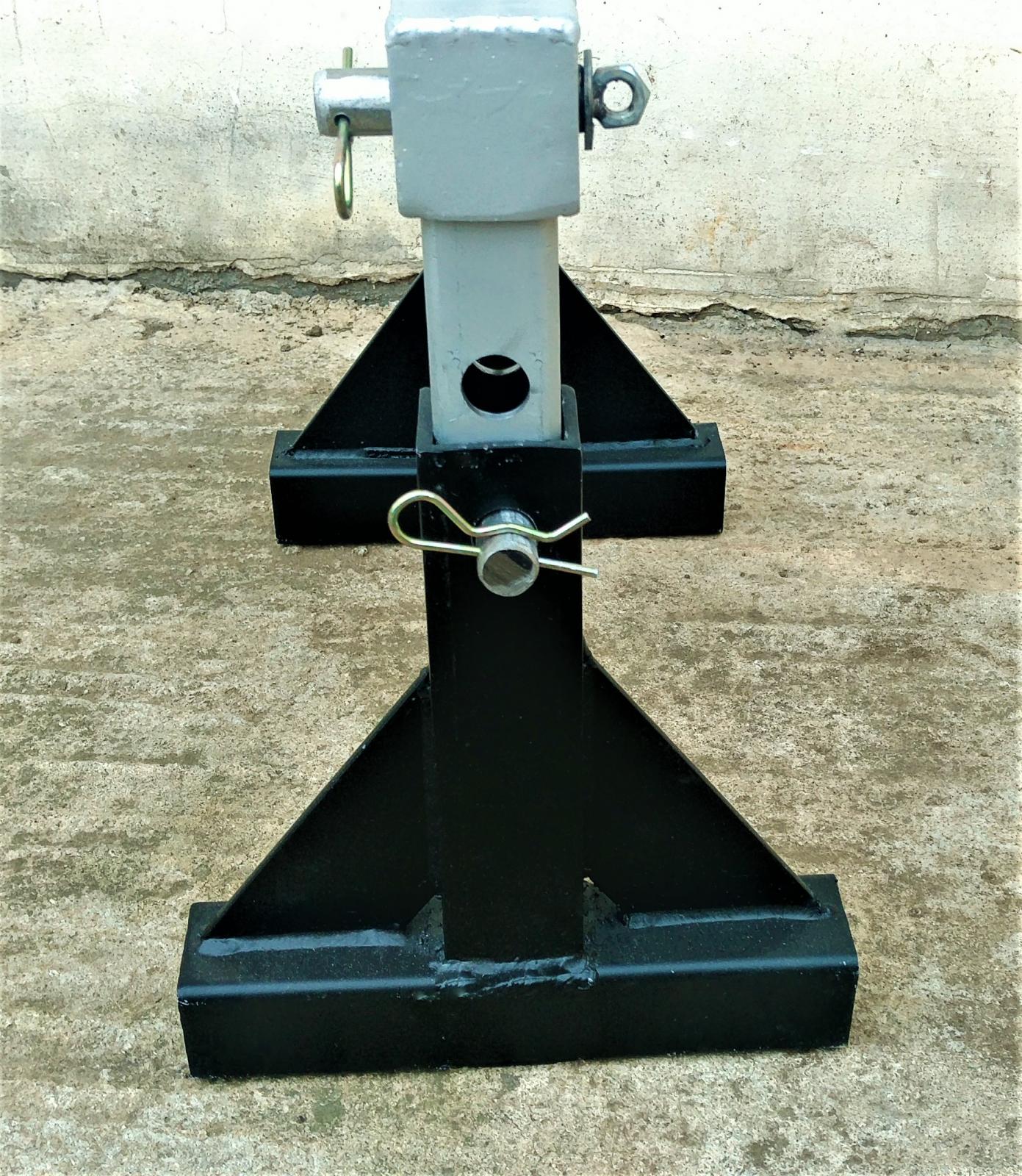

Hello Guys I m back and thank you all for your support.
This stand its very useful for me but expensive to buy one so I decided to make some of those.
Dimensions :
Maximum height is 48 cm
Minimun is 35cm
Body 50x50mm x 5mm -- 40x40mm x5mm

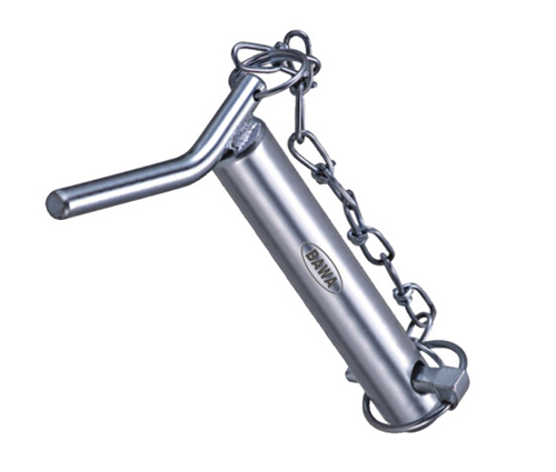

Pins 19mm its homemade but I ordered something like this
