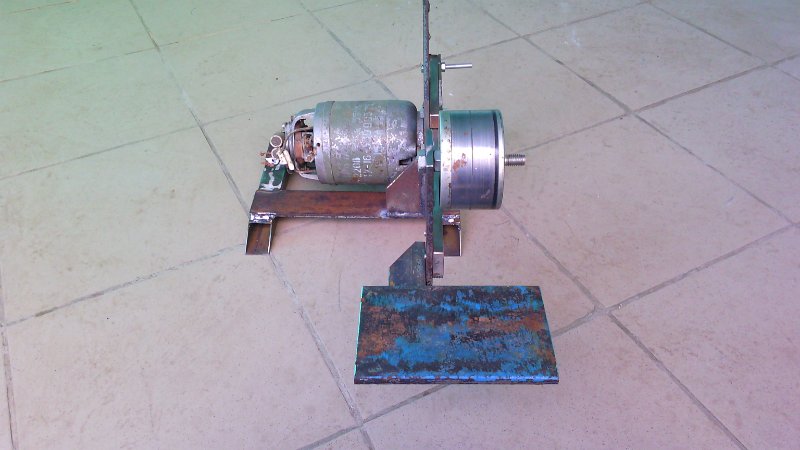

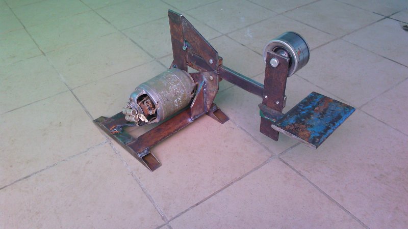

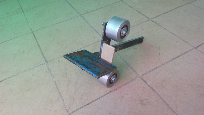

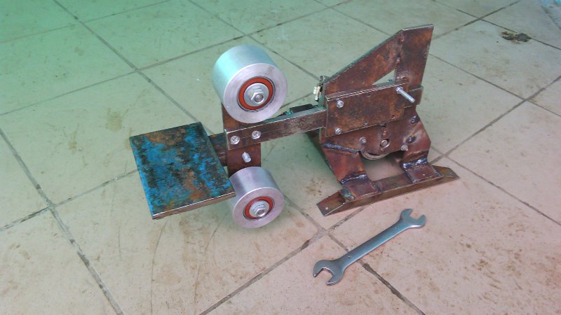

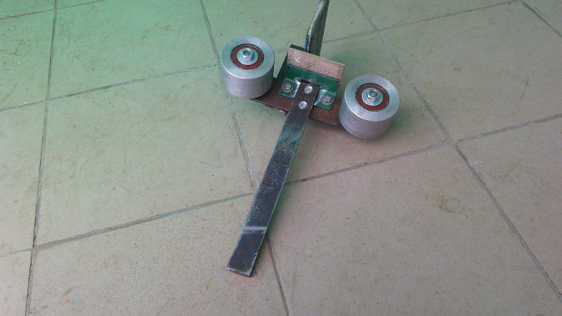

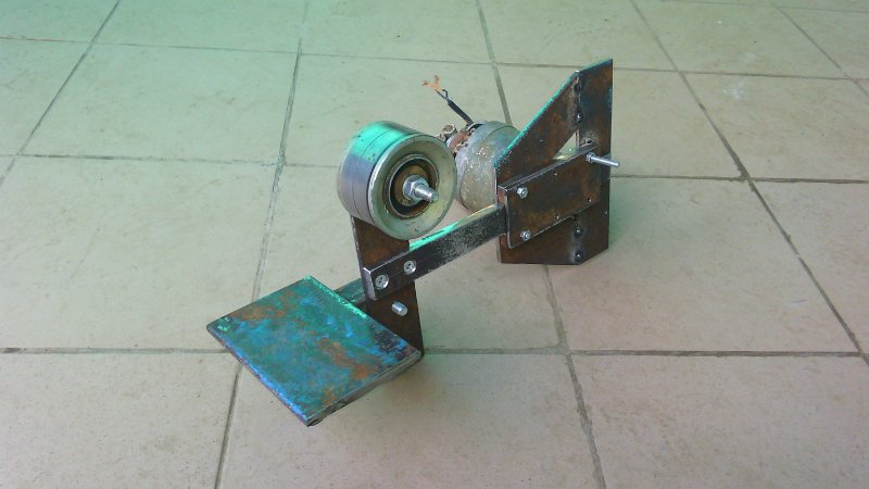

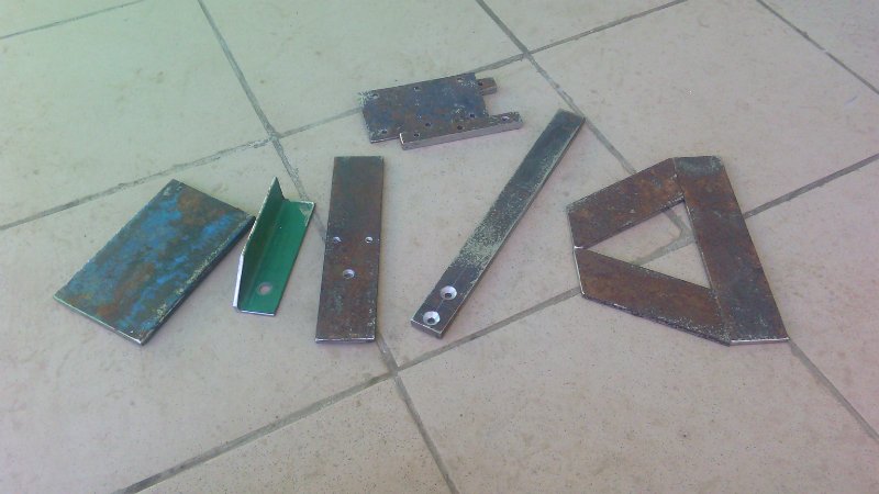

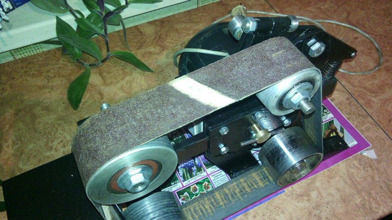

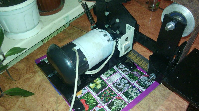

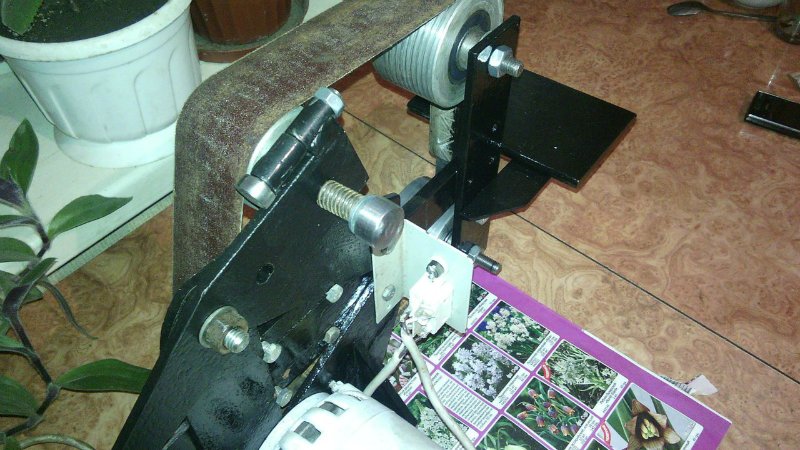

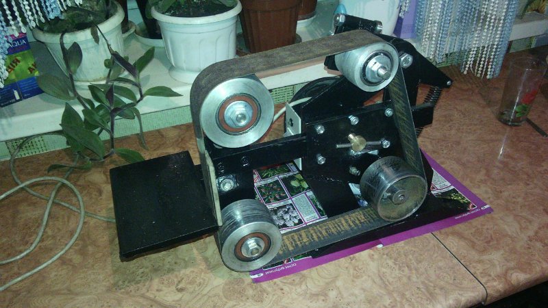

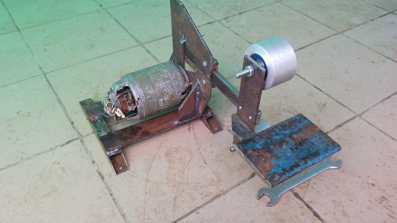

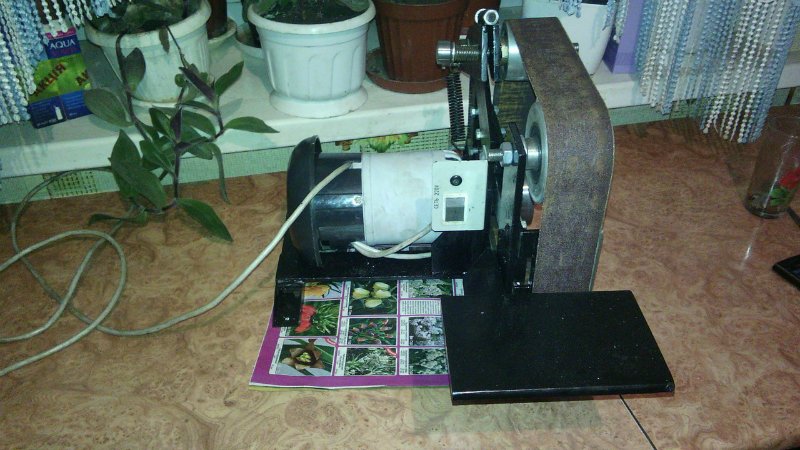

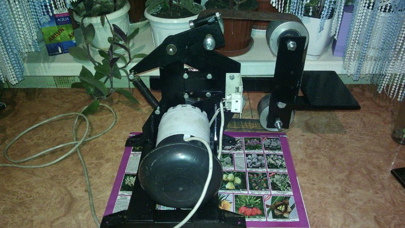

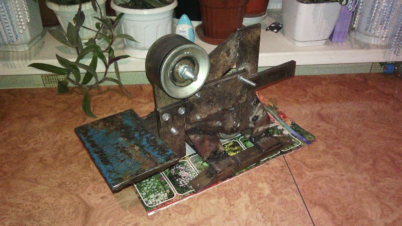

Hi! I am making a belt sanding machine. Use everything that he found in his garage, metal plates, aluminum scrap to be molten.
Attachment 8005
Attachment 8006
Attachment 8007
Attachment 8008
Attachment 8009

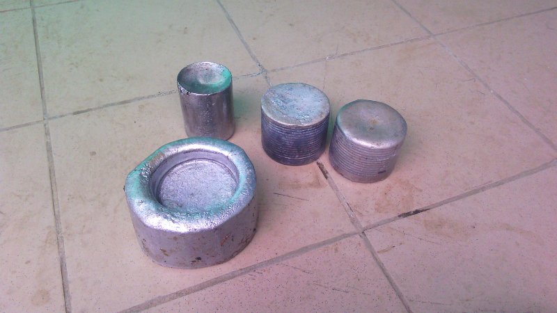

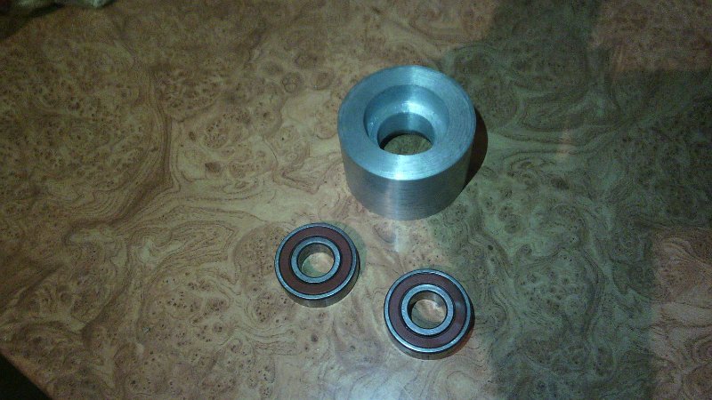

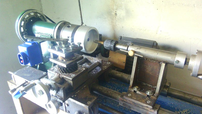

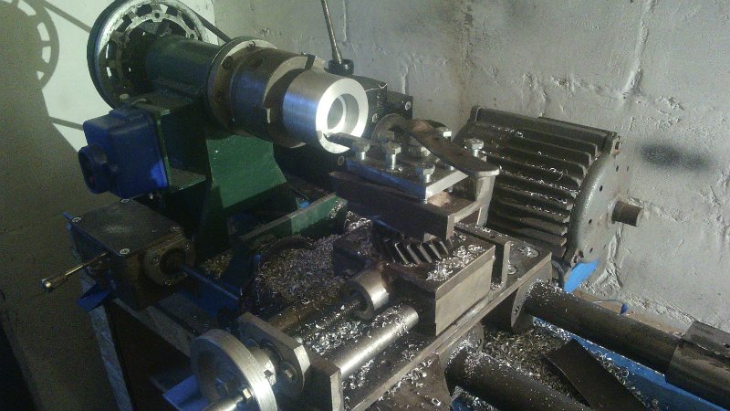

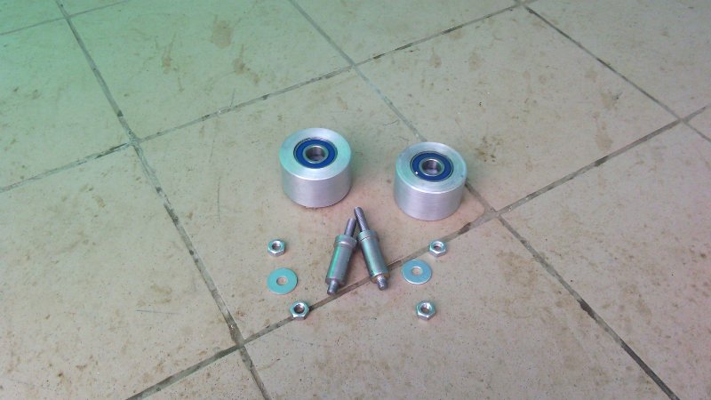

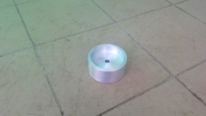

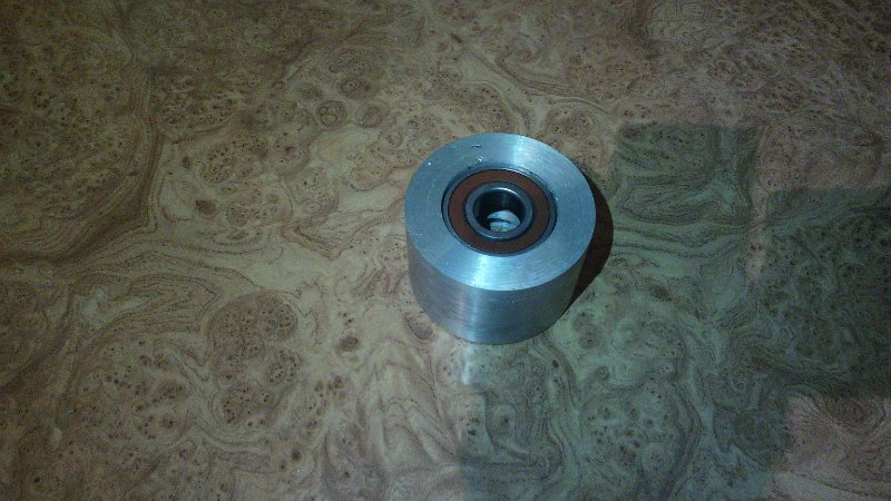

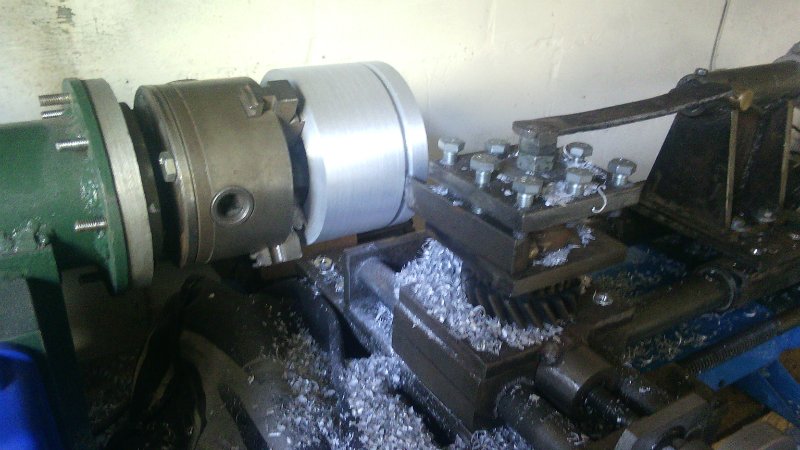

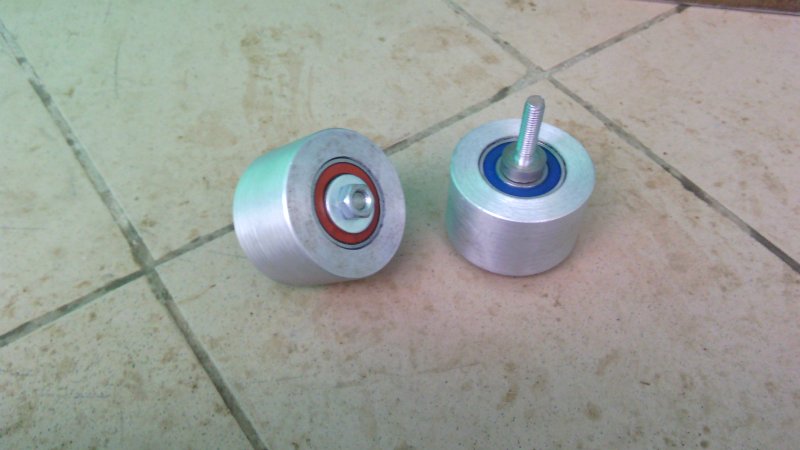

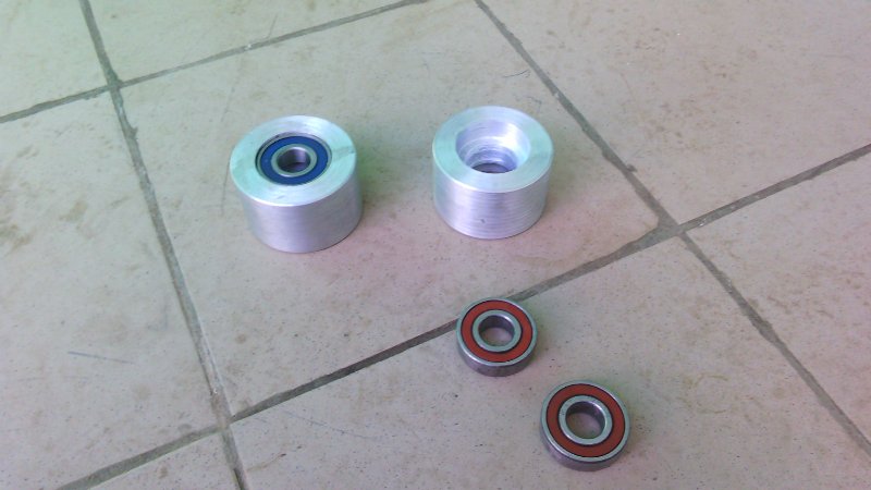

Aluminum scrap Melting, received here are blanks for rollers and pulley on the engine.
Attachment 8010
Attachment 8011
Attachment 8012
Attachment 8013
Attachment 8014
Attachment 8015
Attachment 8016
Attachment 8017
Attachment 8018
Running belt grinder after 1.27 minutes

Wow, that is an impressive homemade tool build using your own aluminum castings and then machining the cast parts on your homemade lathe to make another homemade tool. Thank you for the posting and video, Paul

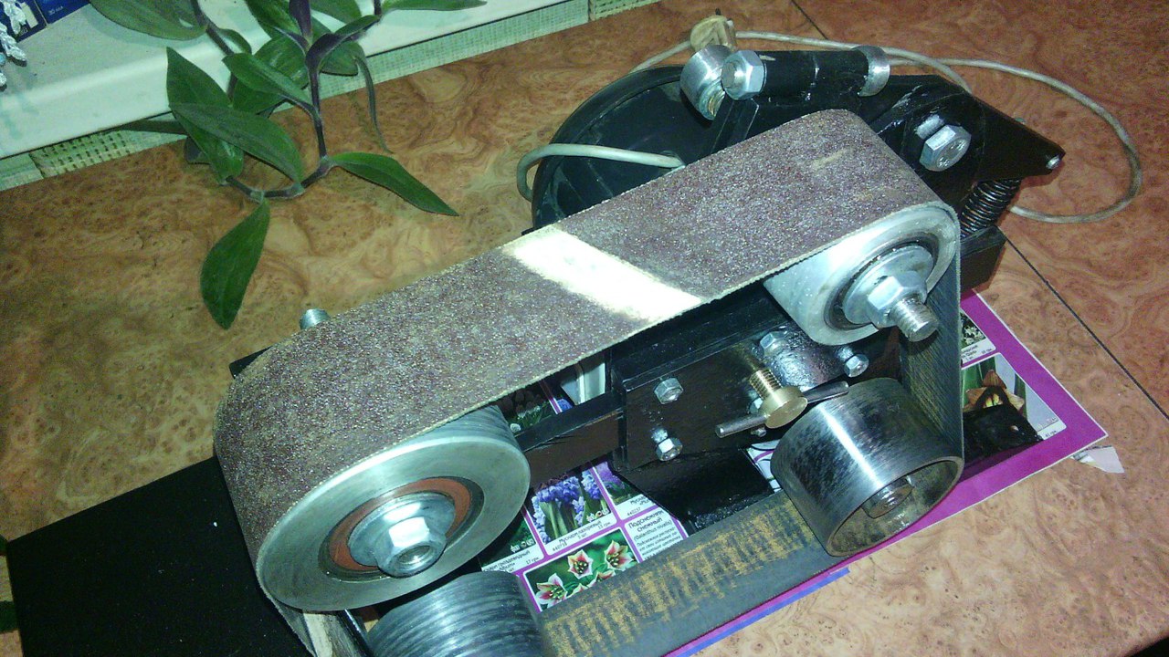

Great build! Very good machining! What size belt does it take?
The minimum length of belt 800mm, maximum 1400mm. Belt myself produce, cut into strips and glue.Attachment 8357

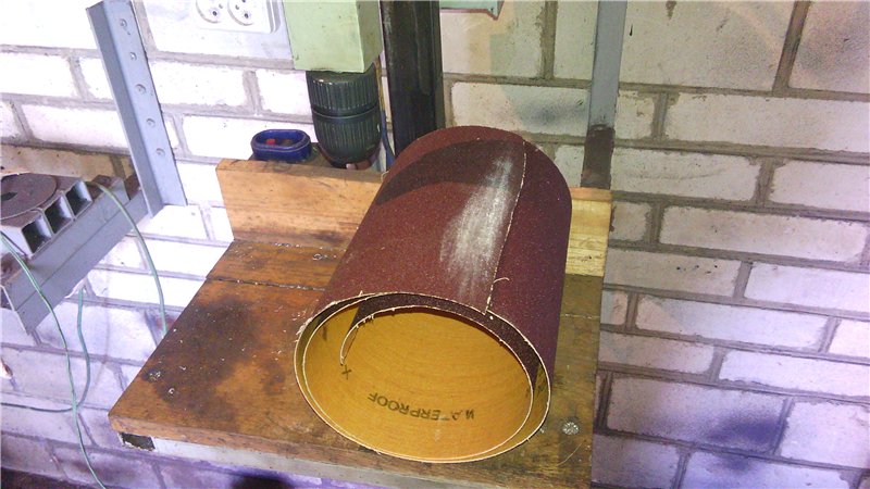

you mention that you make your own belts!
Can you please describe how you do it and the glue you use ?
thanks again
LSB
Hi. I removed an abrasive layer on a fabric, and glue at an angle, as in the photo.
