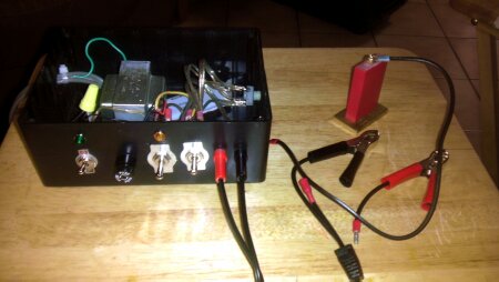

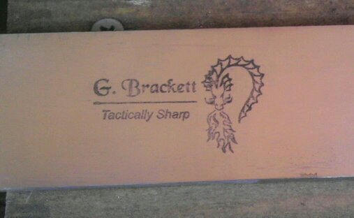

Built this electro etcher which I use for marking my custom made knives and other projects. Plans are available for free on my website. The parts can be sourced from Radio Shack or the web.

I recall finding the site to build this etcher several years ago. I build rifles, and use one of these to do the etching of information on the receiver. There are a few different designs out there. I started with one similar to what George has linked to, and it works great. If you are interested in a more advanced design, check out either one of these sites:

The first one I made has low and high power settings. I used it to engrave parts for R/C cars and trucks I designed, built, and sold in the 90s & early 2000s. If someone would like the plans to them, I would gladly email them the schematic. I have a bunch of stuff that I have built over the years. A lot of my tooling was built to meet a specific need. The listed etcher is mainly used by knifemakers starting out. Simple yet effective.

If you have an old phone charger or the like you can use this by cutting it out and tapping off before the bridge rectifier for the AC "darkening" and just use the normal outlet for the etching outlet. This can be put in the case with a 10 amp fuse and a switch connected into the wire supplying the unit. A three way switch can be used to toggle the outlet wiring to suitable jacks.
