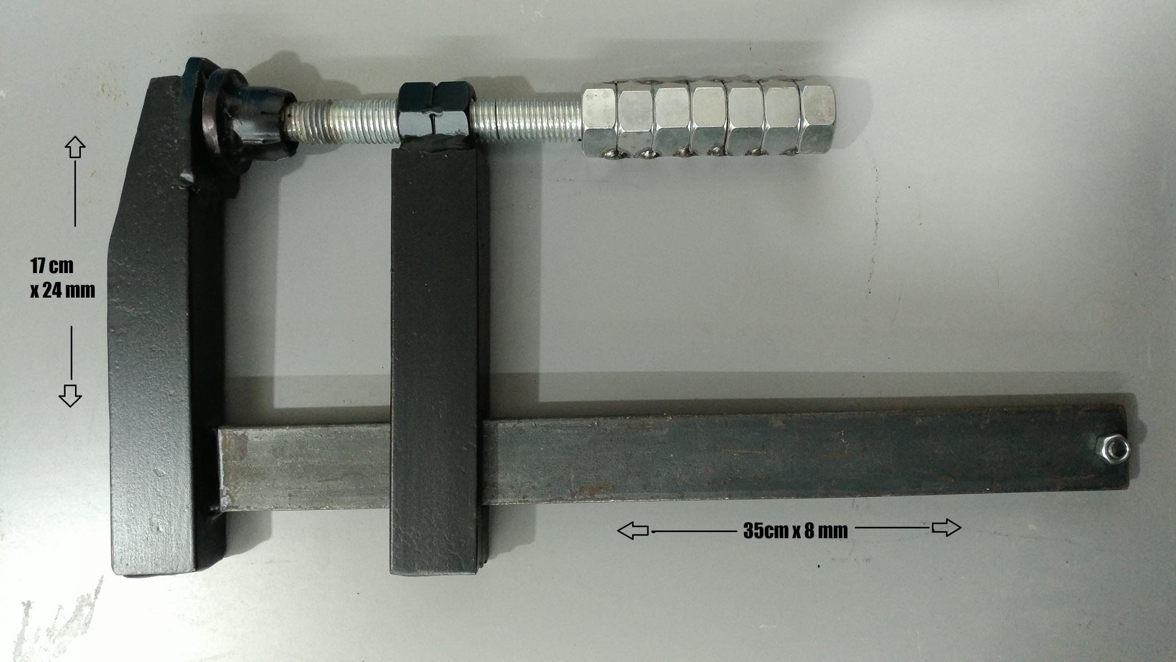

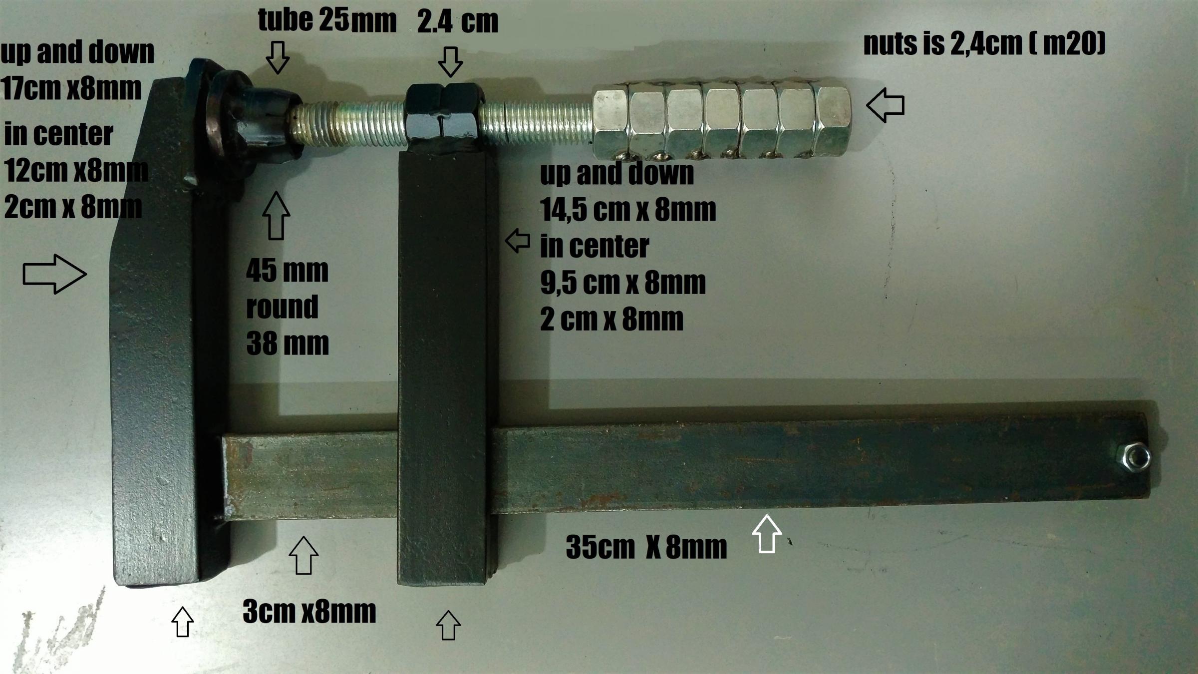

Here is the dimensions.
Attachment 28804
Hello guys because many peolple ask me on Youtube about dimensions so I decided to upload here an image.
If you want more information ask me here.

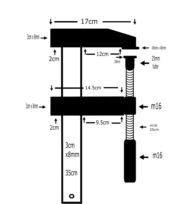

Here I have a better Plan for this clamp.
https://www.youtube.com/watch?v=DsmV-Mh_W3Q
Attachment 38701
