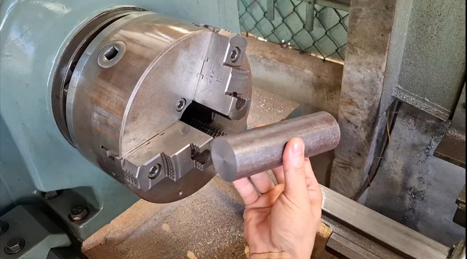

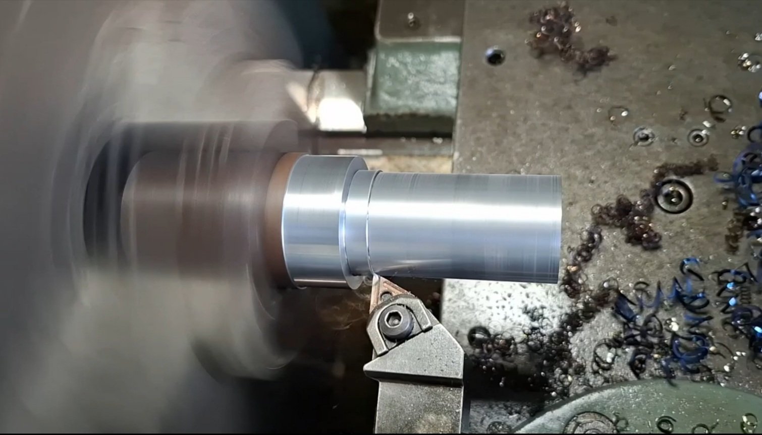

Hi all,

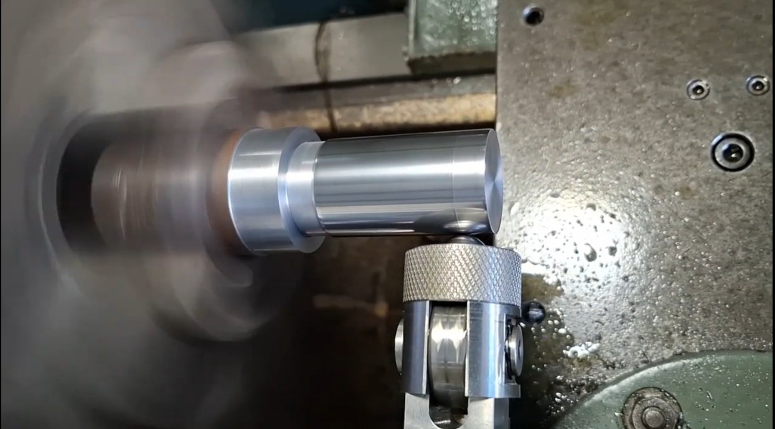

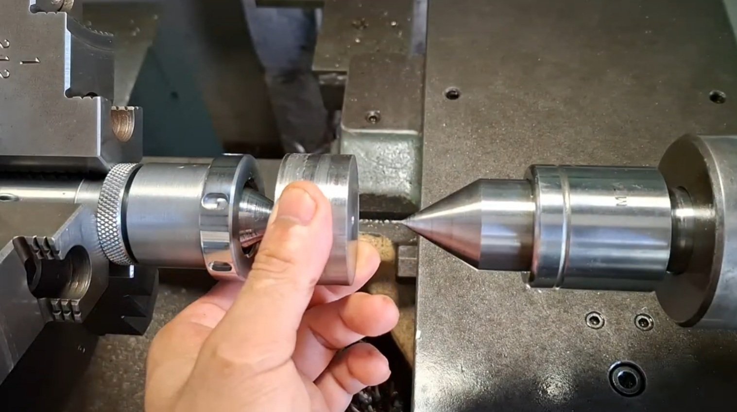

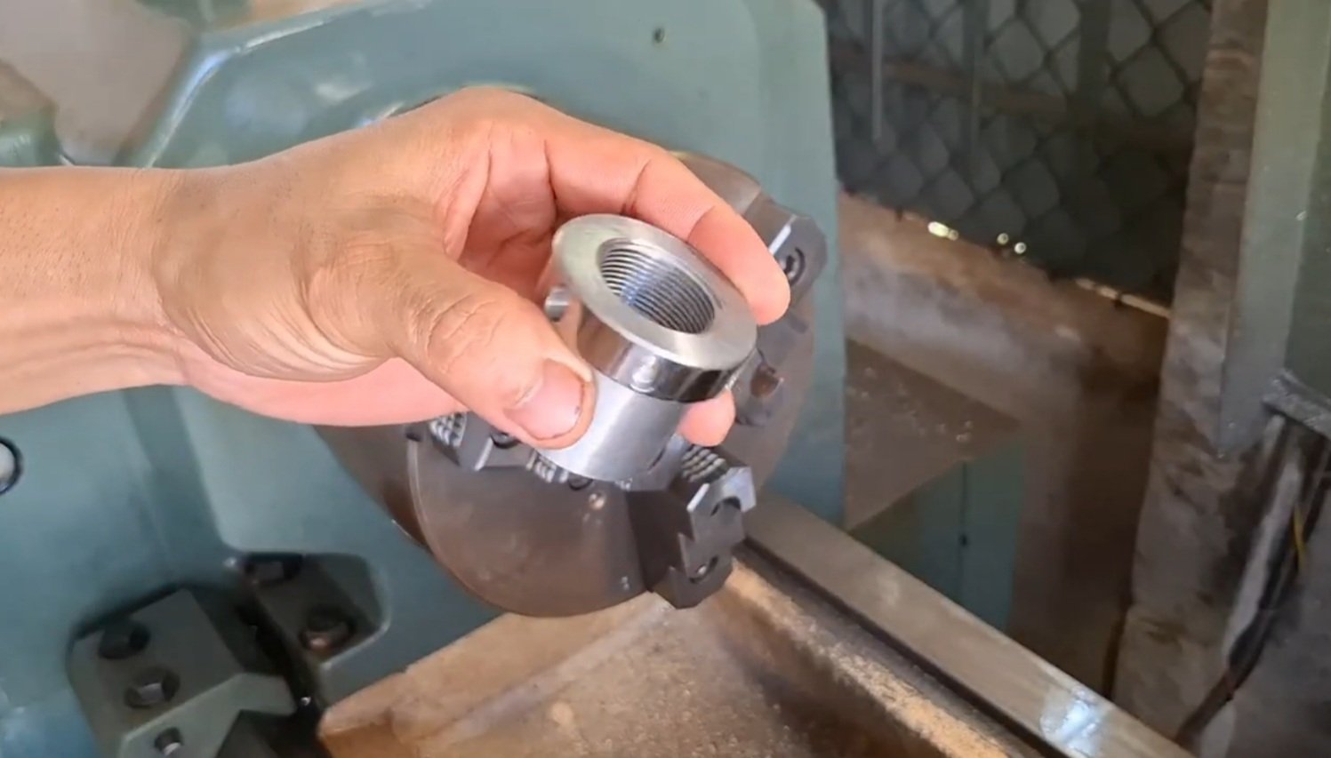

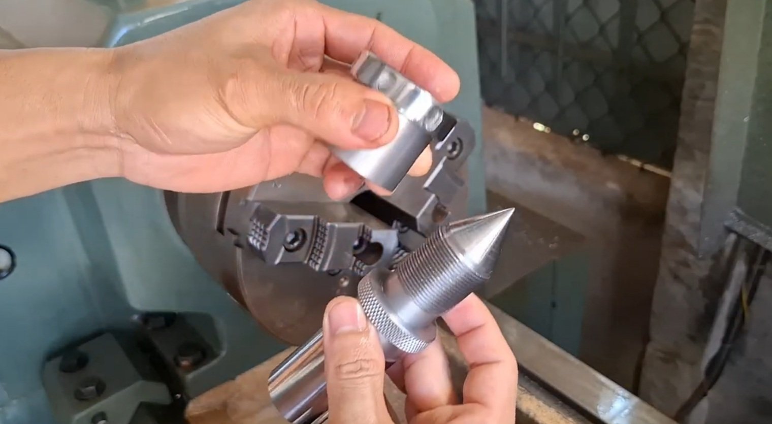

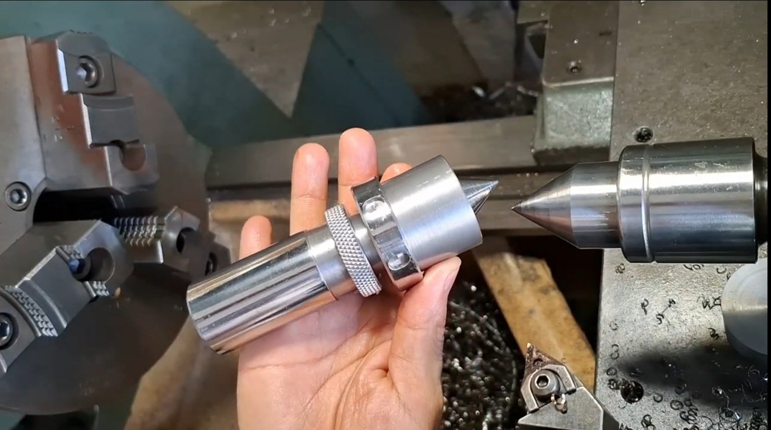

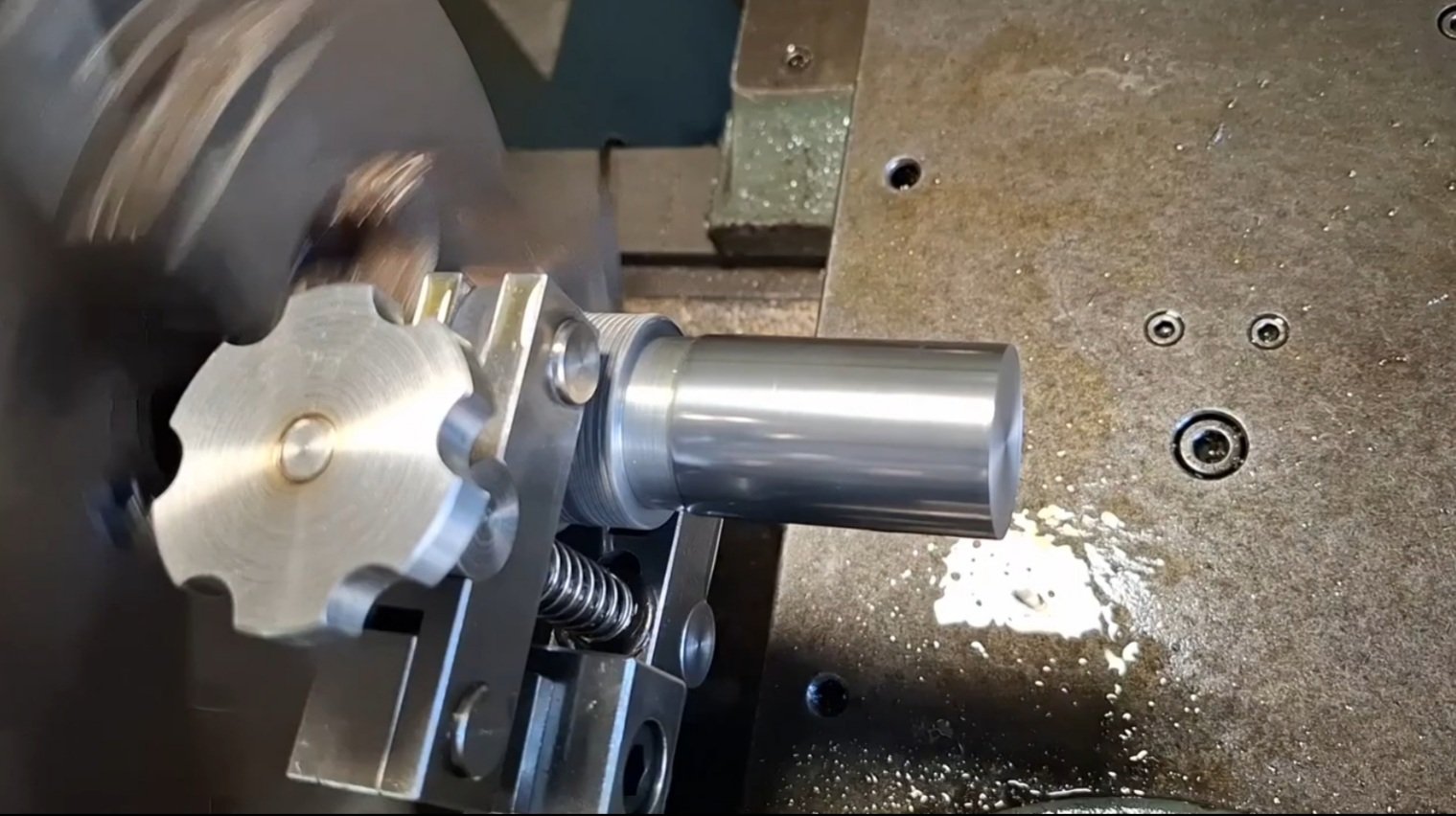

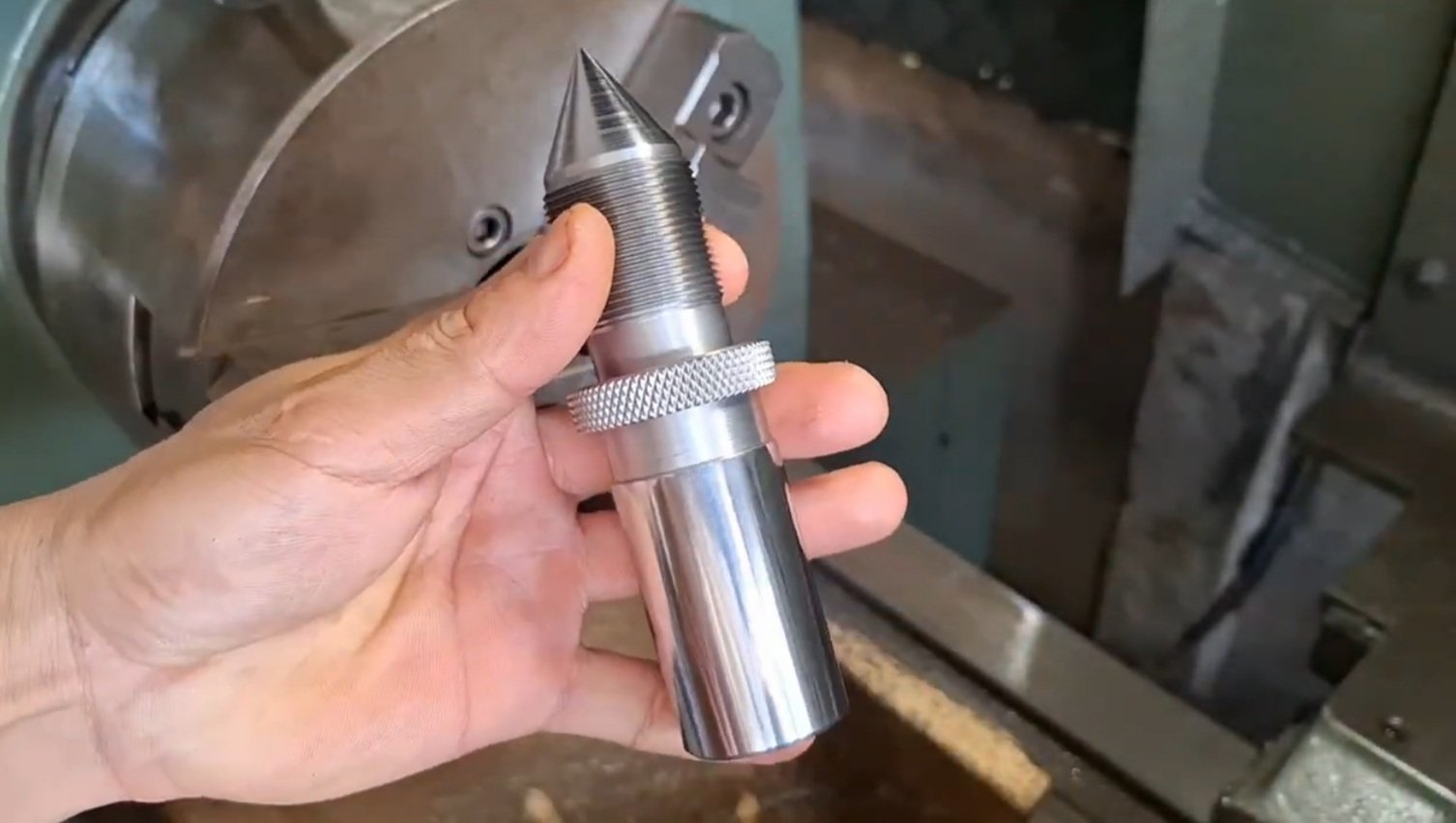

This tooling will allow you to turn shafting between centers from end to end and can also eliminate the use of an addition lathe dog to drive the work piece:
Attachment 47447 ===>> Attachment 47448
:bananadance:For step and step tutorial including video: :beer:https://zalonvtn.blogspot.com/2024/05/blog-post.html
