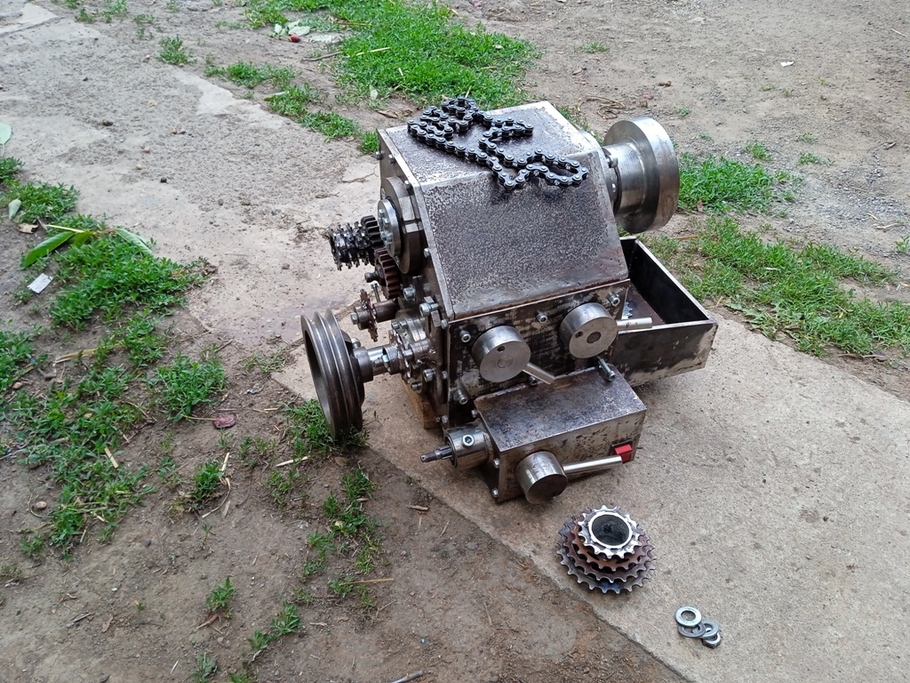

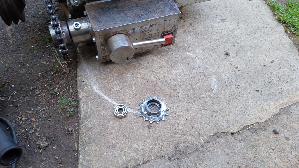

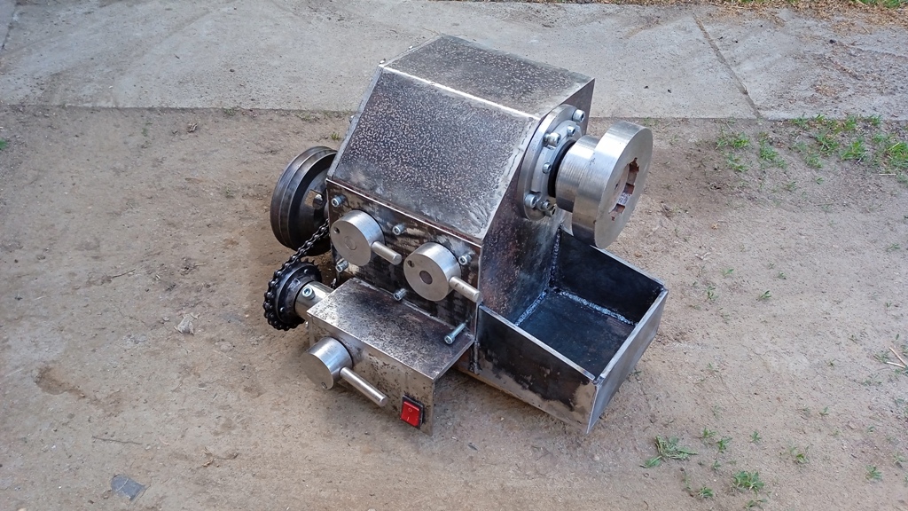

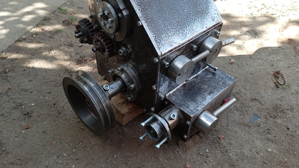

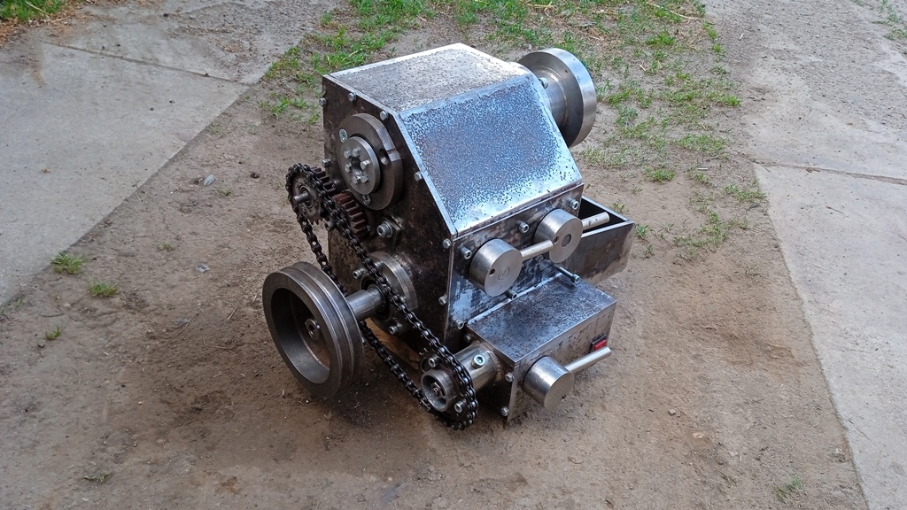

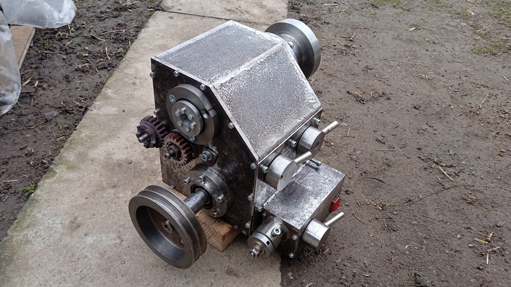

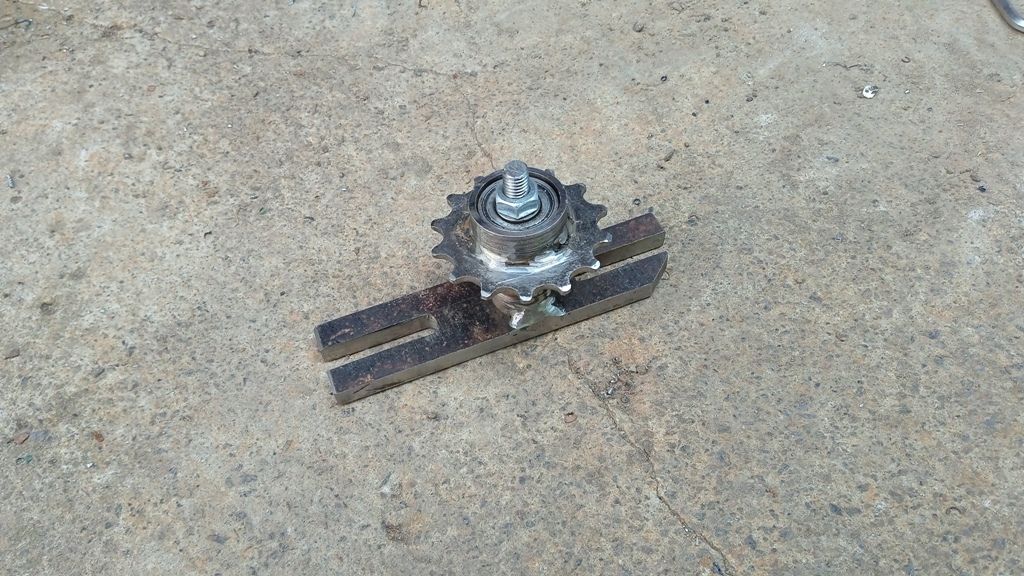

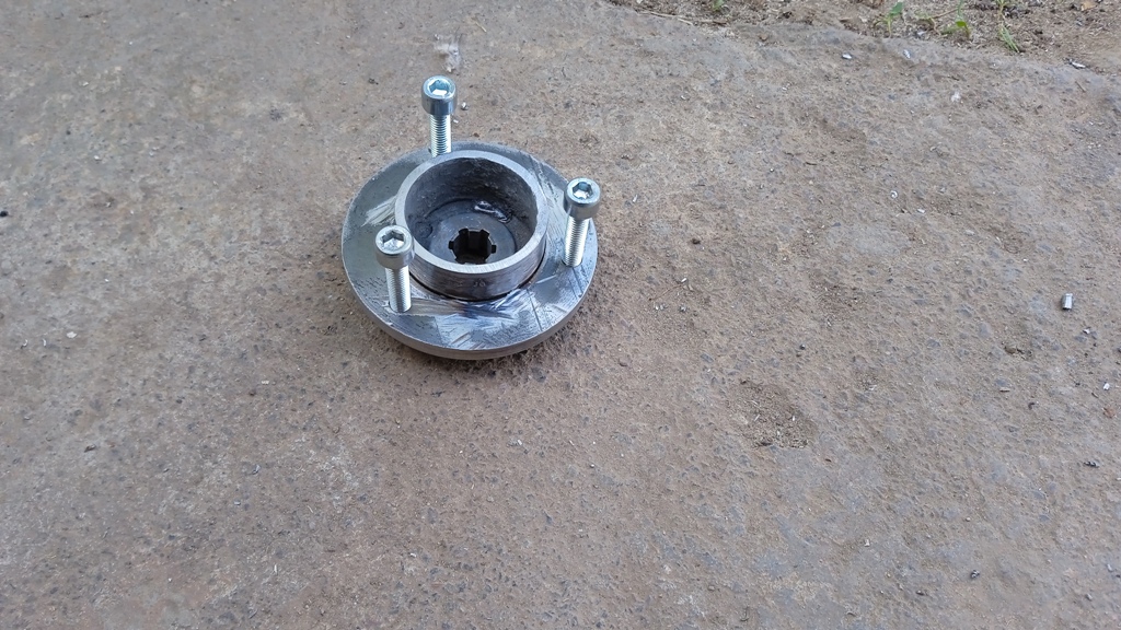

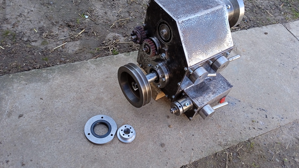

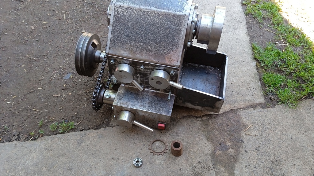

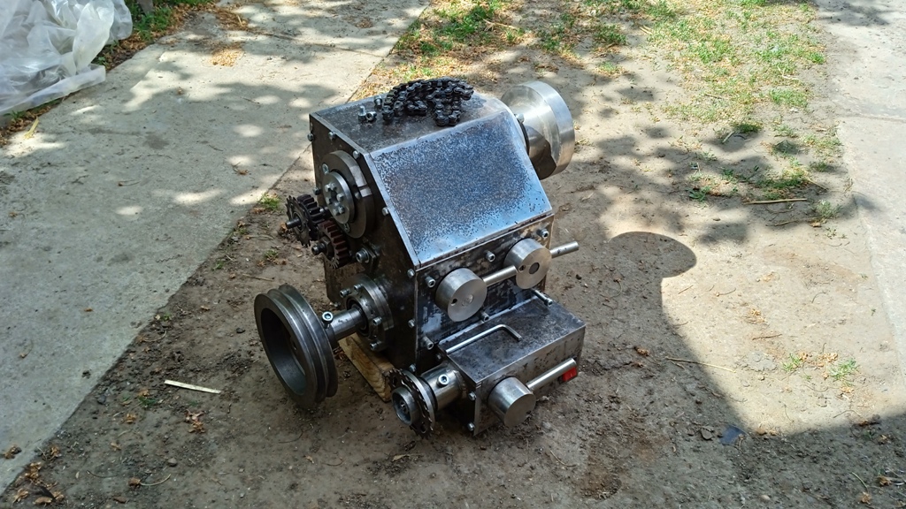

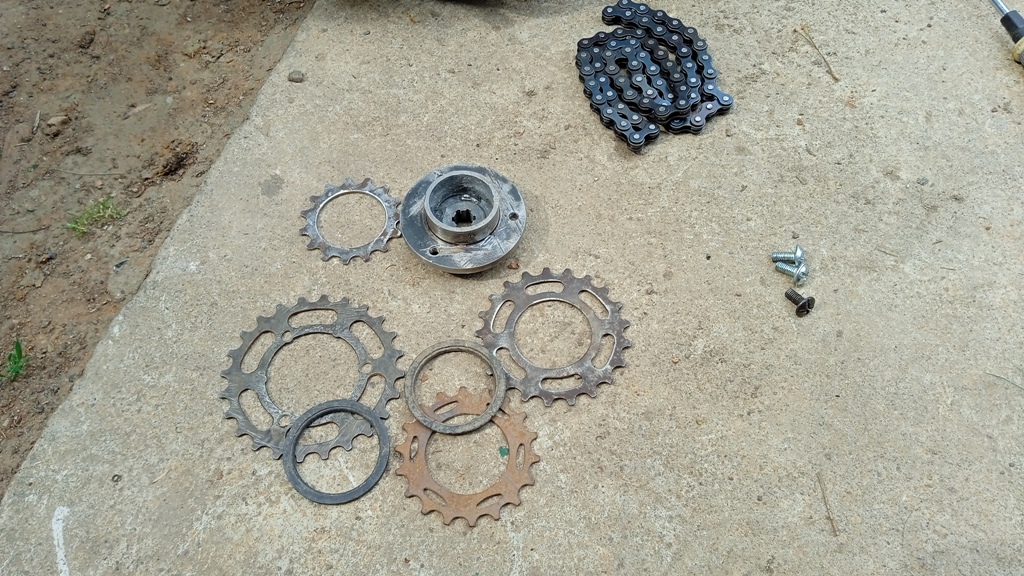

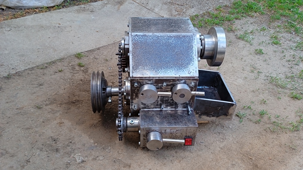

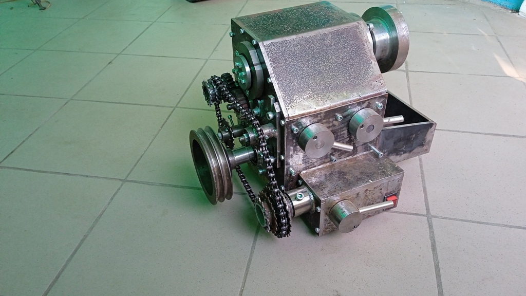

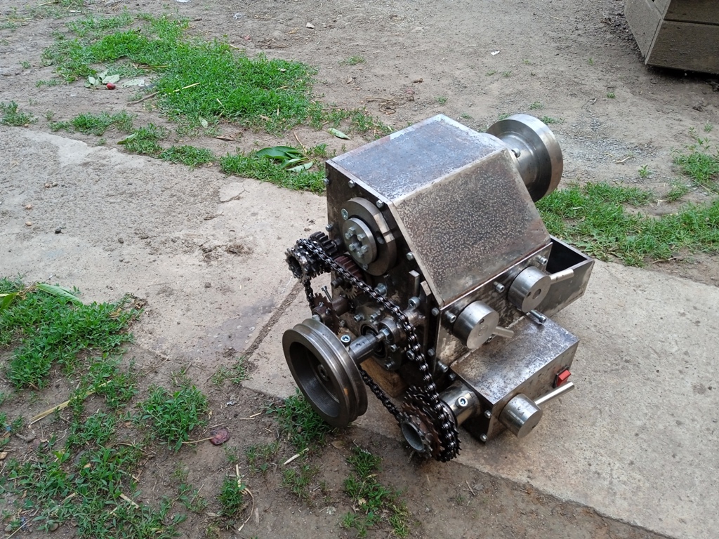

Drive on the leadscrew feed. I used a chain and a star because it's easy to make. For each step of the thread, you can easily make a star with the right number of teeth.

I hope this helps, the english word for "star" when used with a chain is "sprocket".
Now self-made lathe has the opportunity to cut metric threads in steps of 1.0, 1.25, 1.5, 1.75, 2.0. In the future, this figure will be expanded by replacing the sprockets.
