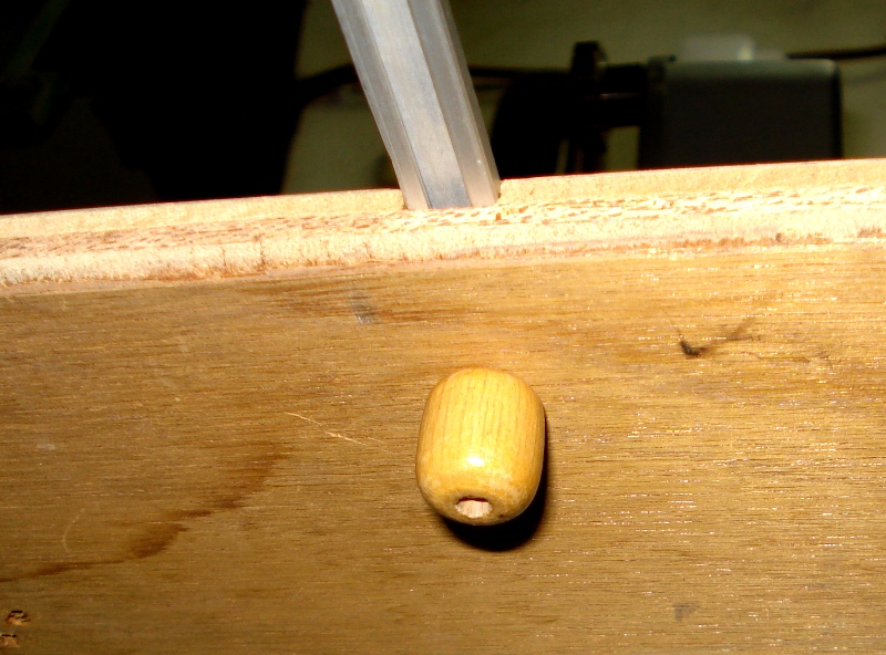

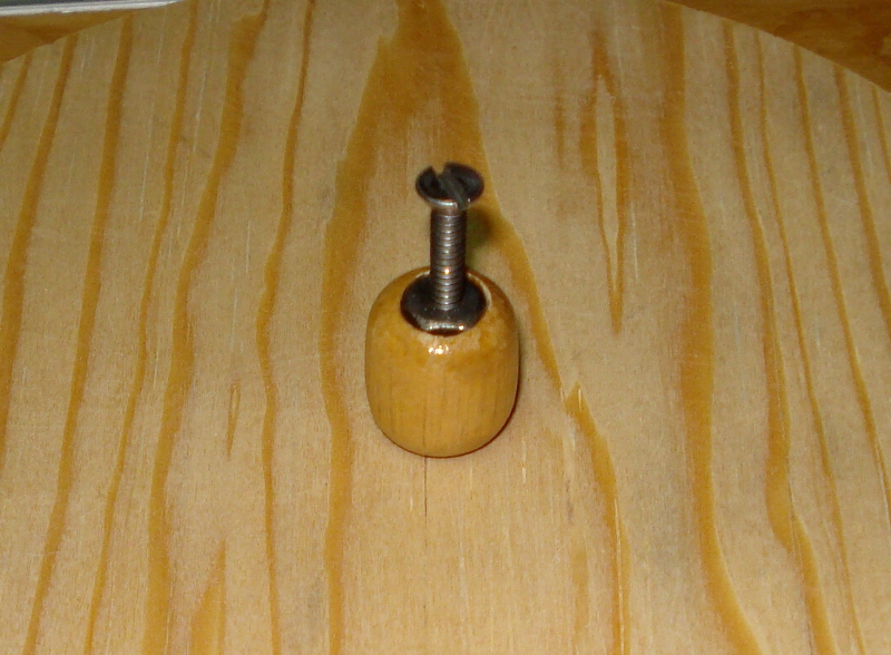

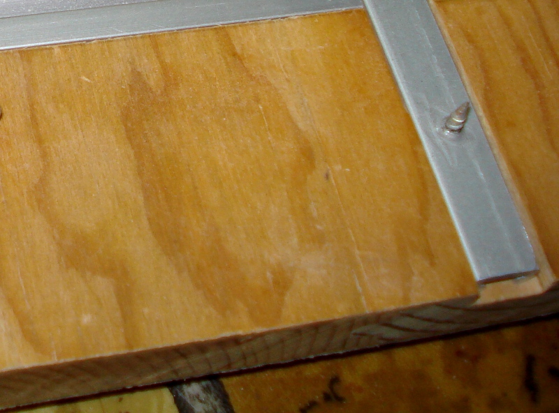

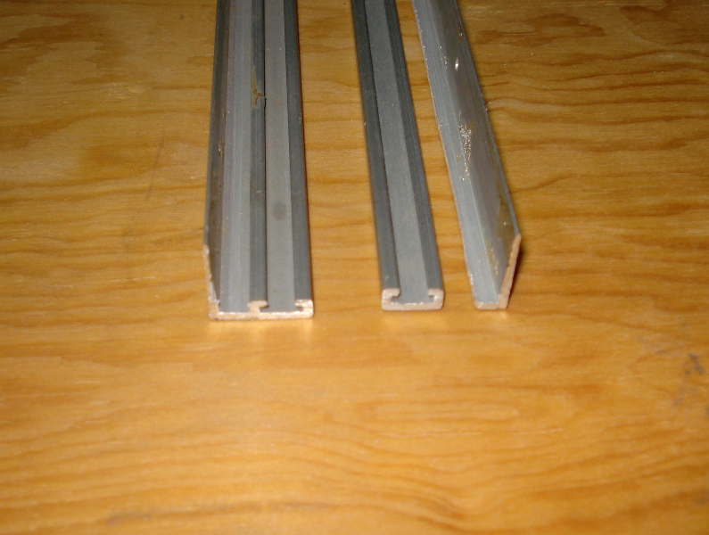

Time ago, I needed an adjustable pivot for cutting circles. Since commercial T-tracks are very large for this purpose, I made this mini T-track out of a leftover aluminum profile. The T-track carries a fixed spike that serves as a pivot, and runs in a groove of the jig.
Attachment 13990
Attachment 13991
A screw running within the T-track sets the distance of the rotation center from the cutting tool, according to the desired radius.
