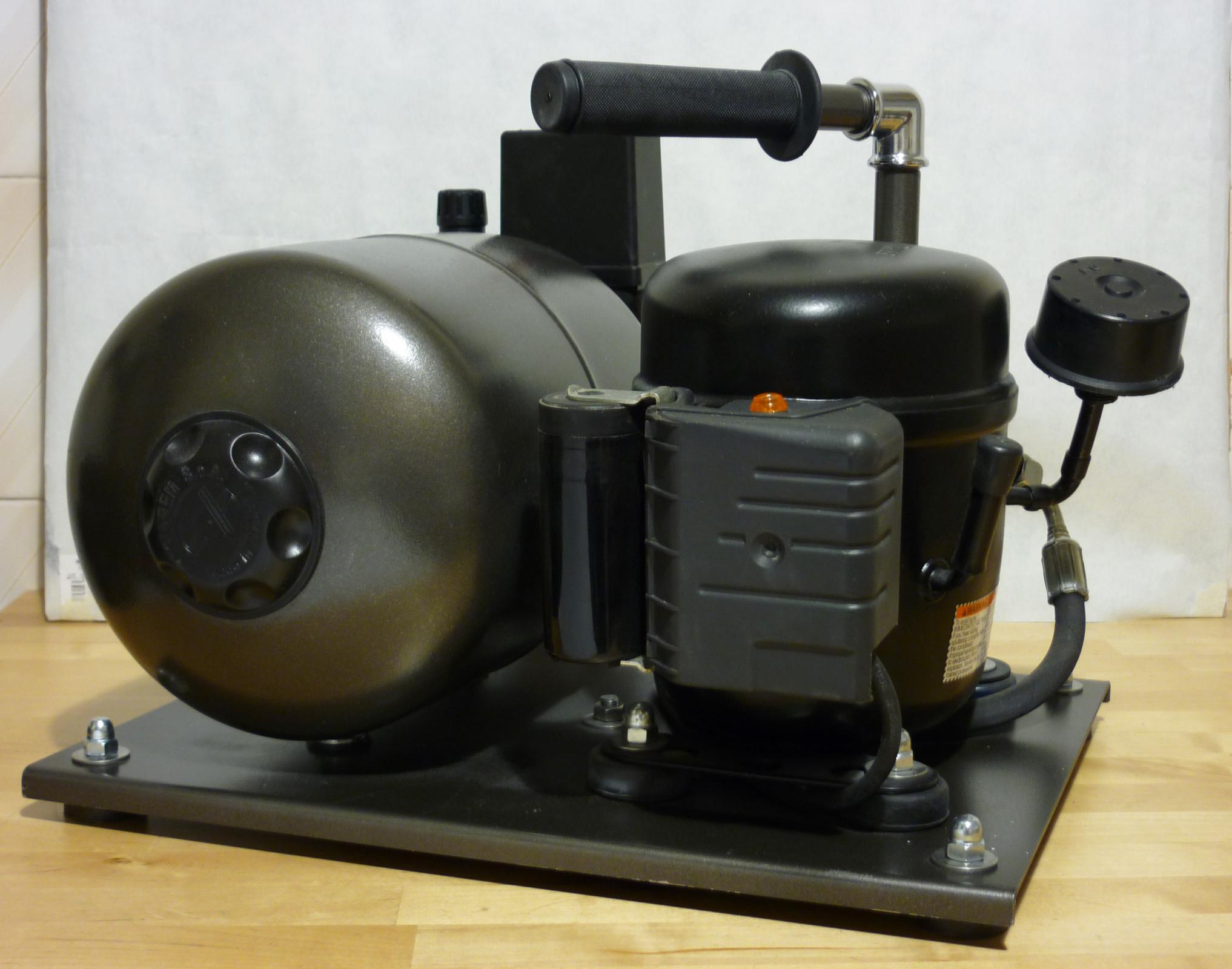

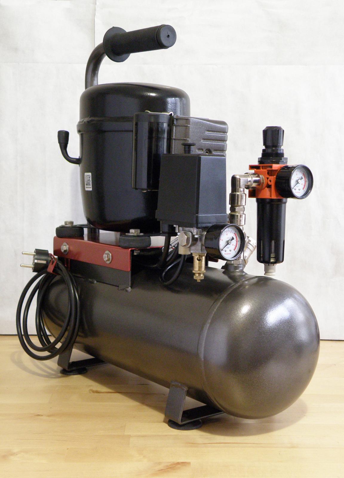

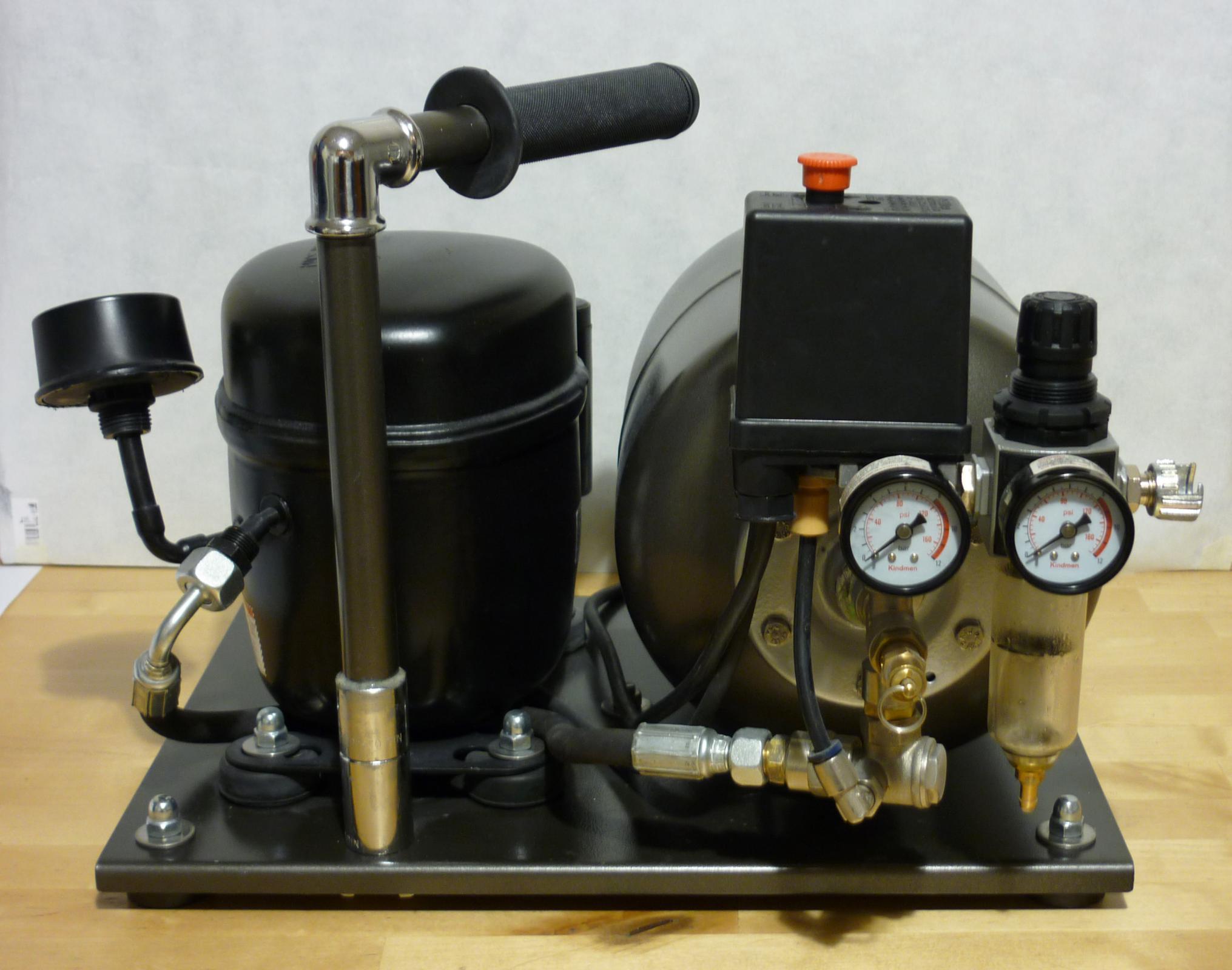

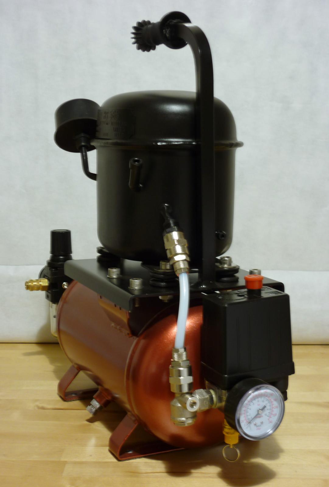

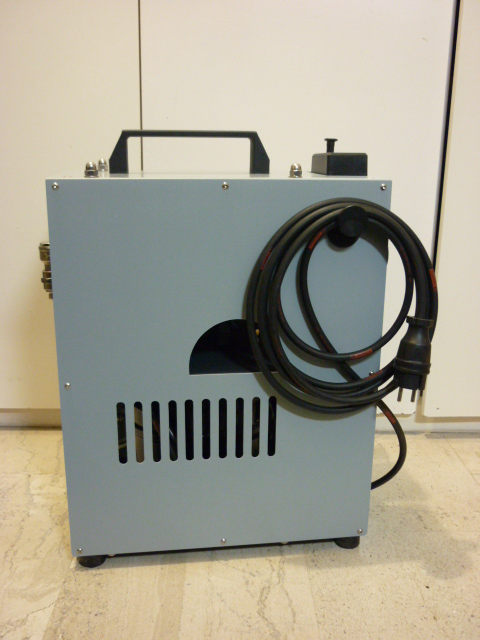

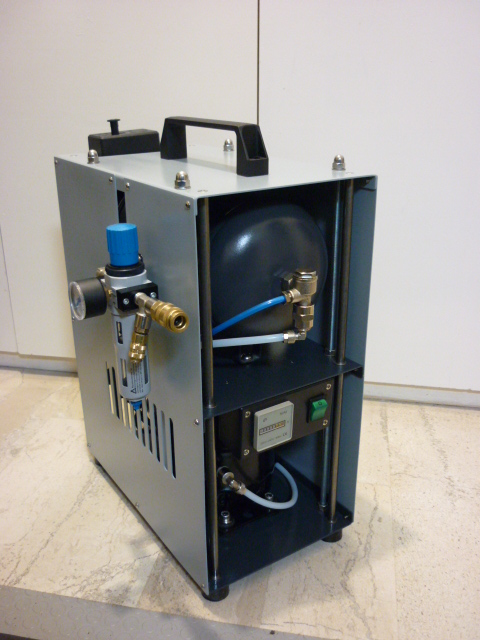

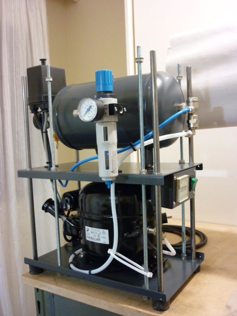

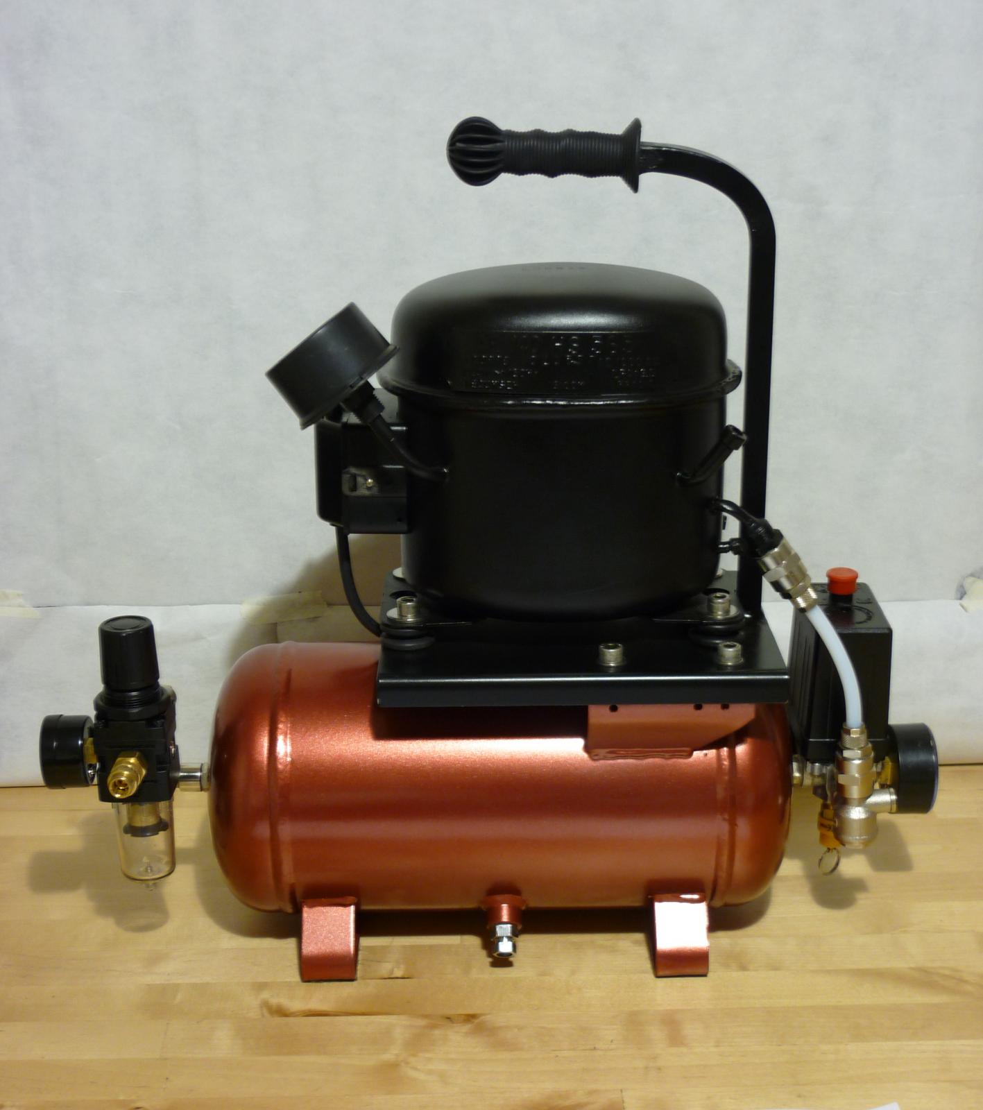

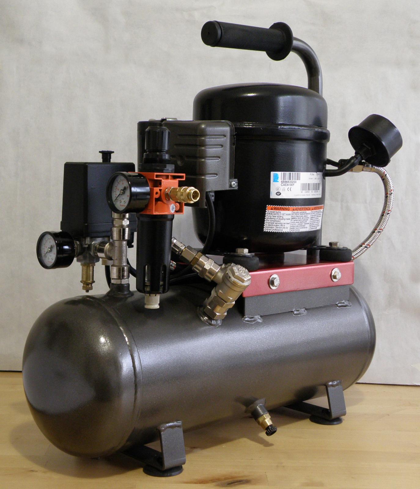

Hello to all,
I must admit that I have a passion for silent air compressors, simply because you can use them anytime you want without disturbing your neighbors! I built my first compressor 11 years ago using a truck’s brake air tank. Until today I've made 5 silent compressors and I have a 6th one under construction (unknown when it will be finished).
The following video shows the construction of the 5th compressor I’ve made that is actually my first serious built when I started my YouTube channel 6 years ago.
I don’t want to tire you with pictures here (except the necessary ones) because the whole video is actually a slide show with all the info about the built; at the end of the video you will see some photos from the other 4 compressors, but since the time of the video is short I will put these pictures below so you take closer look. I would like to show you more from my previous builds but unfortunately I have only these pictures.
Attachment 27713 Attachment 27714 Attachment 27715 Attachment 27716 Attachment 27717
https://www.youtube.com/watch?v=fCW9d5Lx_Qk&t=6s

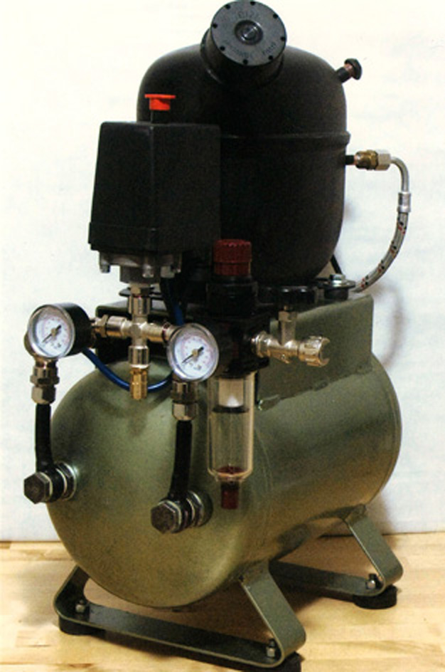

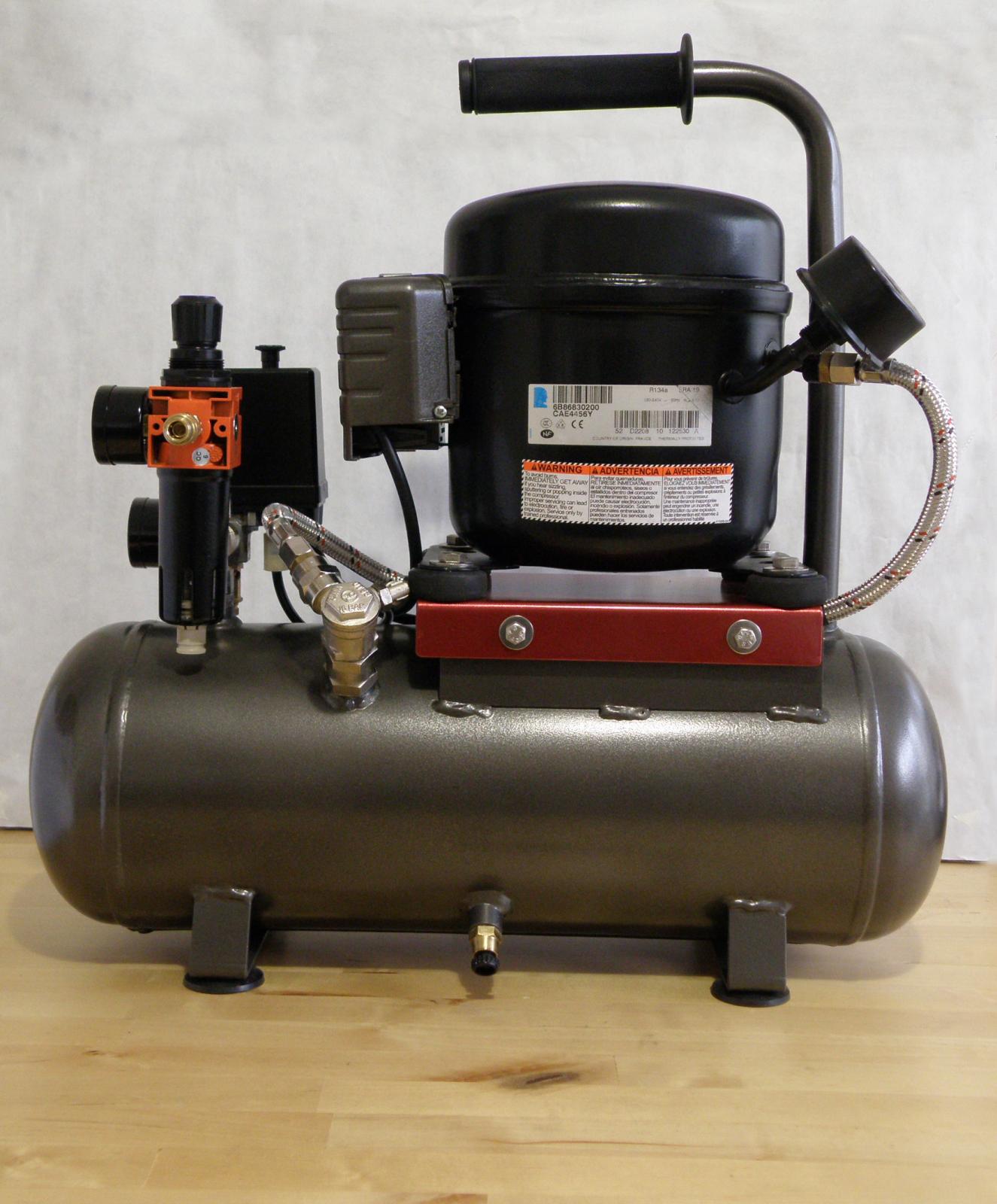

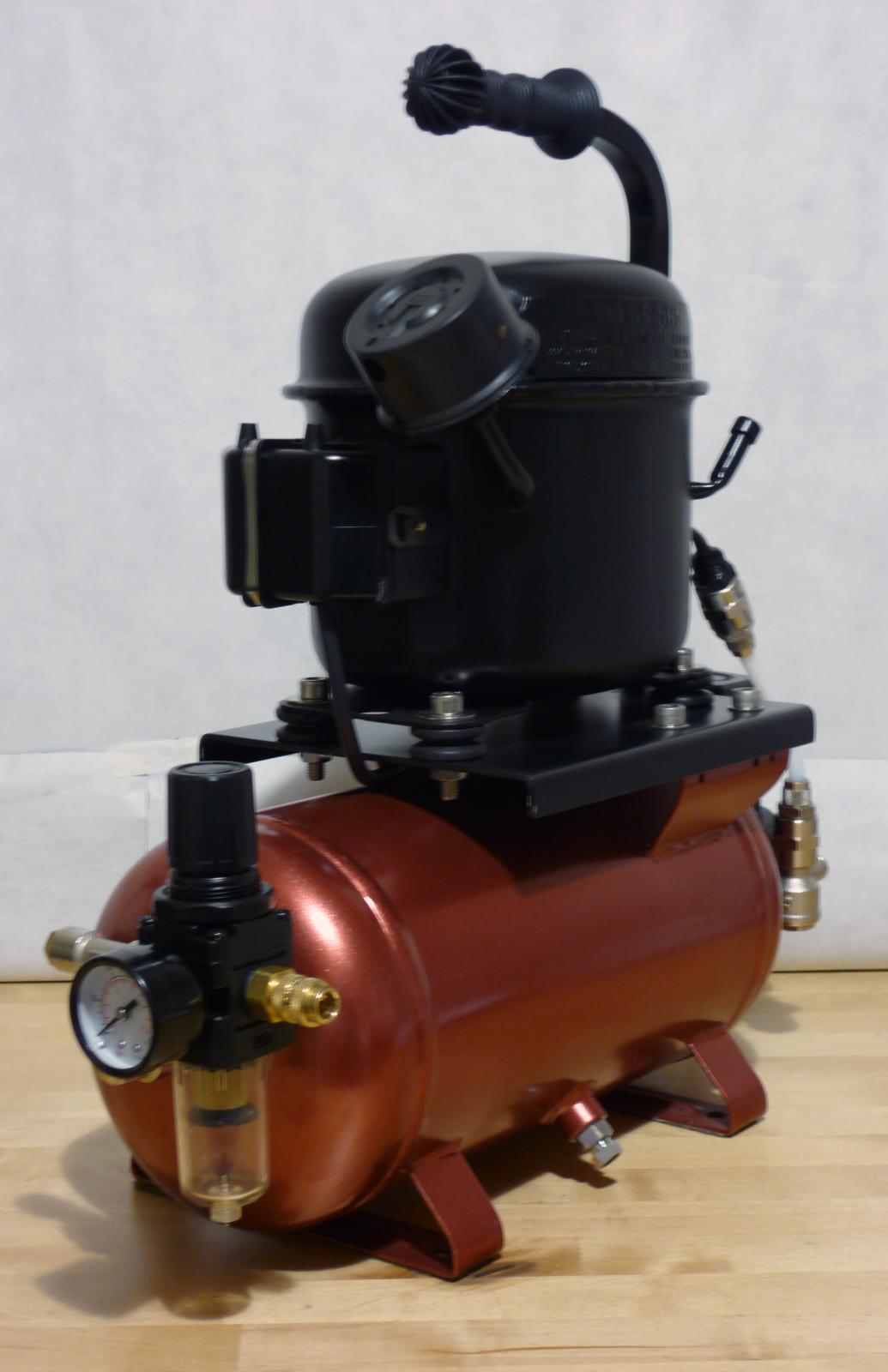

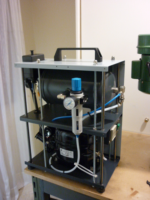

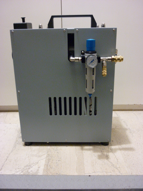

These are the previous 4 compressors I've made.
Attachment 27719 Attachment 27721 Attachment 27721 Attachment 27723 Attachment 27724 Attachment 27725 Attachment 27726 Attachment 27727 Attachment 27728 Attachment 27729
